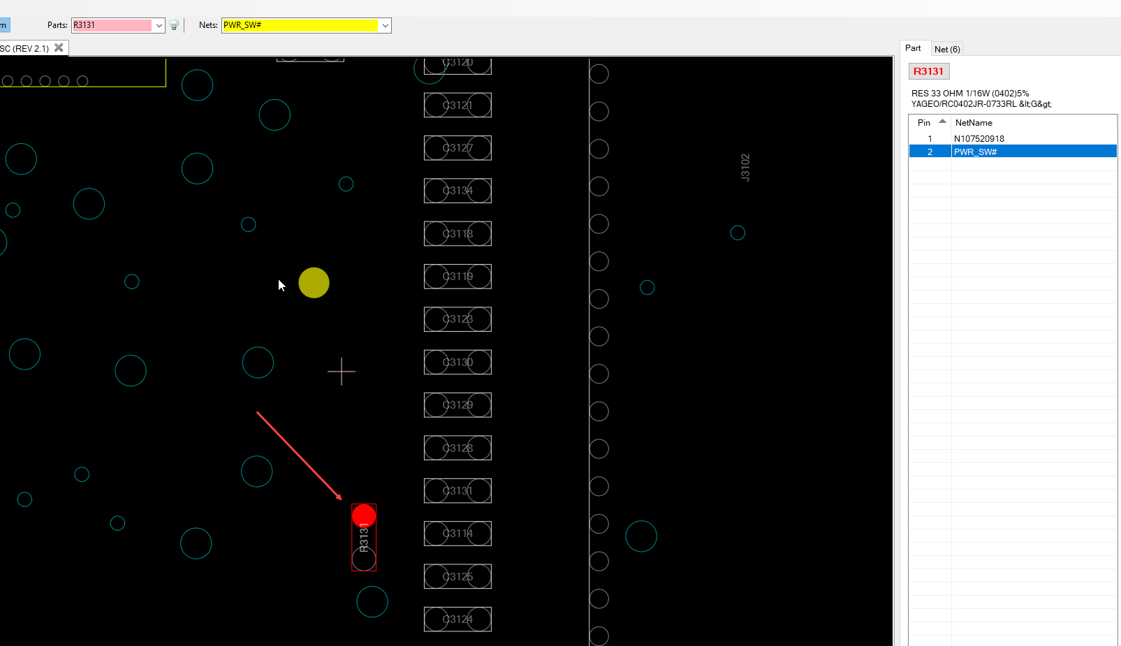

    Hi good day I want to jumper the unit with twizzer but I dont know where tojumper the pins
    in the boardview I cant see where the power

    See attached.
    Use tweezers to short pin # 2 (PWR_SW#) of resistor R3131 to GROUND.
    PS - found this through searching the NET NAMES till locating one that made sense and a bit of magic

      thanks sir it was working now
