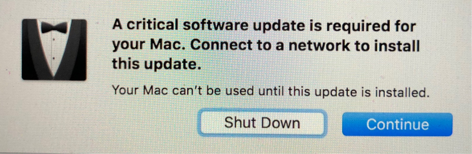

    Hello Guys
    I need your help with a macbook touchbar stuck on the update
    "a critical software update is required for your mac. connect to a network to install this update"
    Im getting the above error and i can not continue at all, it keeps on going back there, i reinstalled iOS, I did the updates, but still looping back on that same error message
    Please assist me guys im stuck now
    Thank you

    Re: Macbook Touch Bar Stuck on the update error message
    https://logi.wiki/index.php/Critical...roubleshooting
      Thank you so much I'll do my best and update you guys on what worked for me
        You can also try the Apple configurator 2 tool but you need a second macbook for that. Beware that if you do a recovery, all data will be lost.
