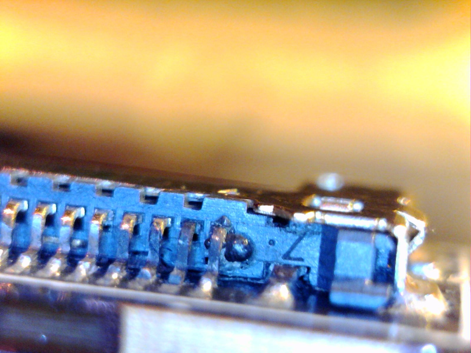

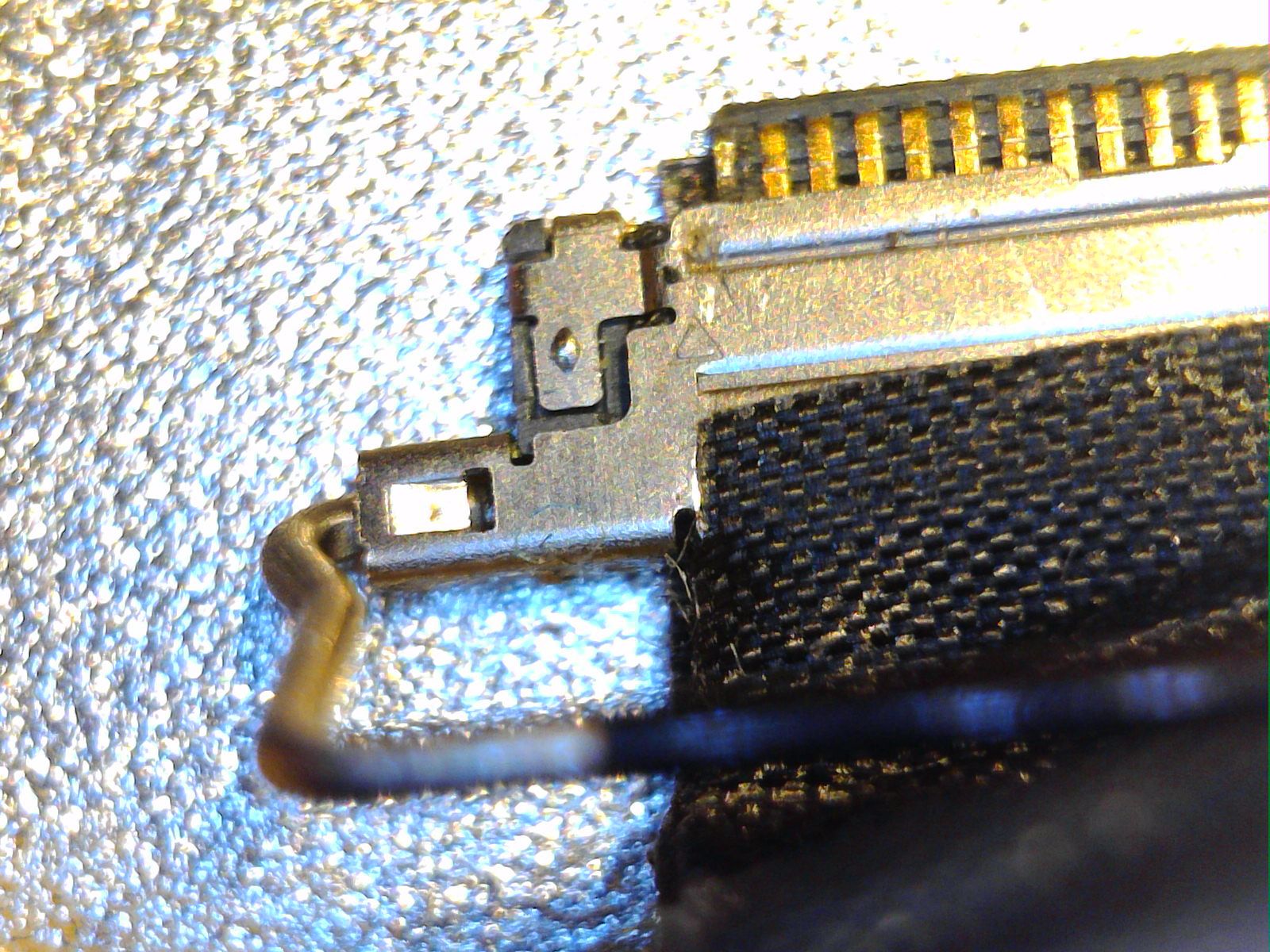

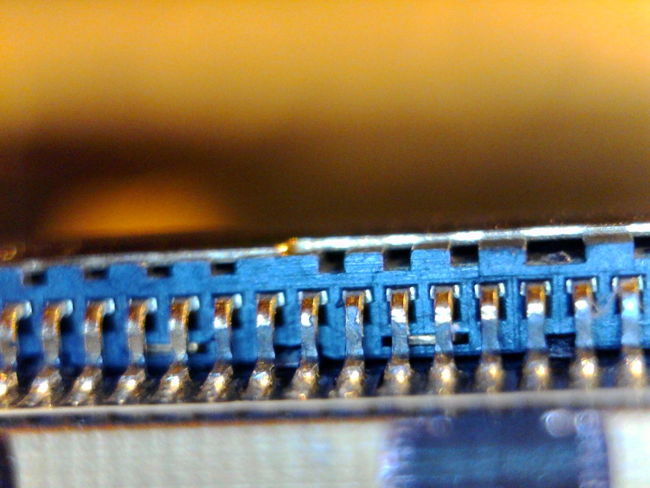

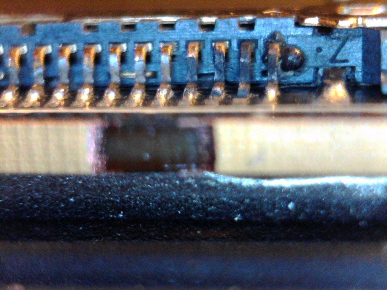

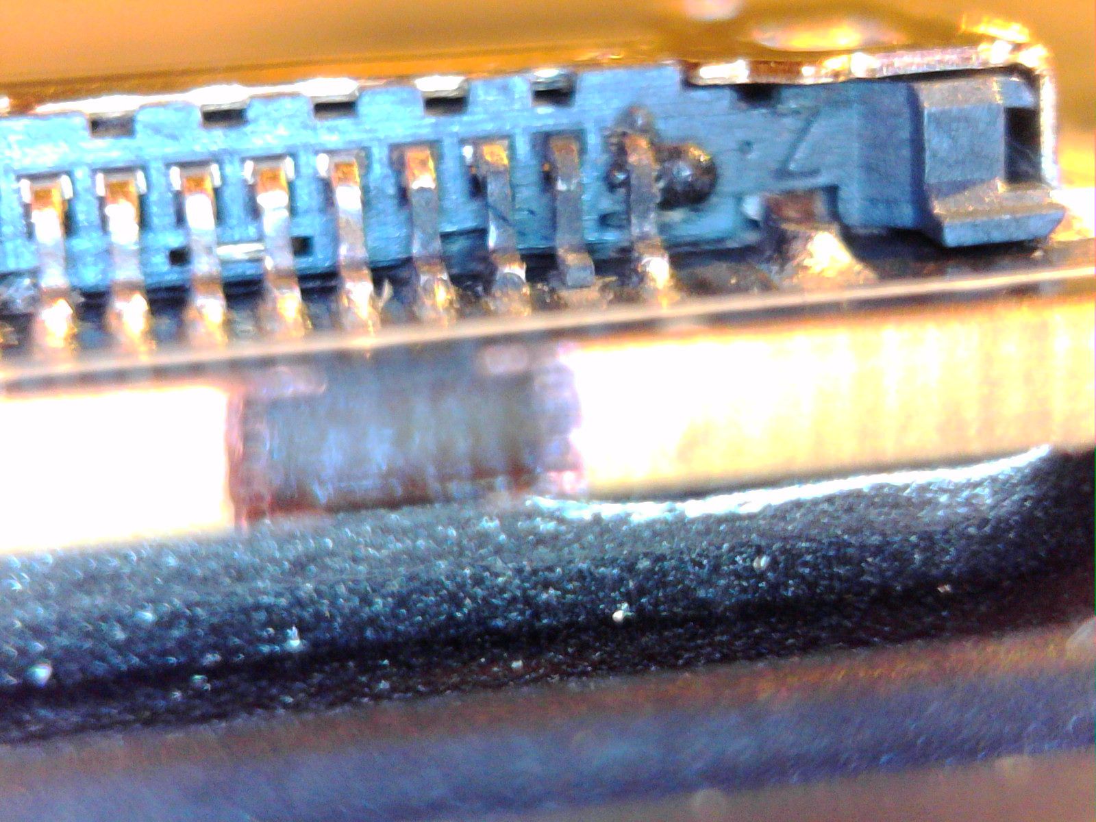

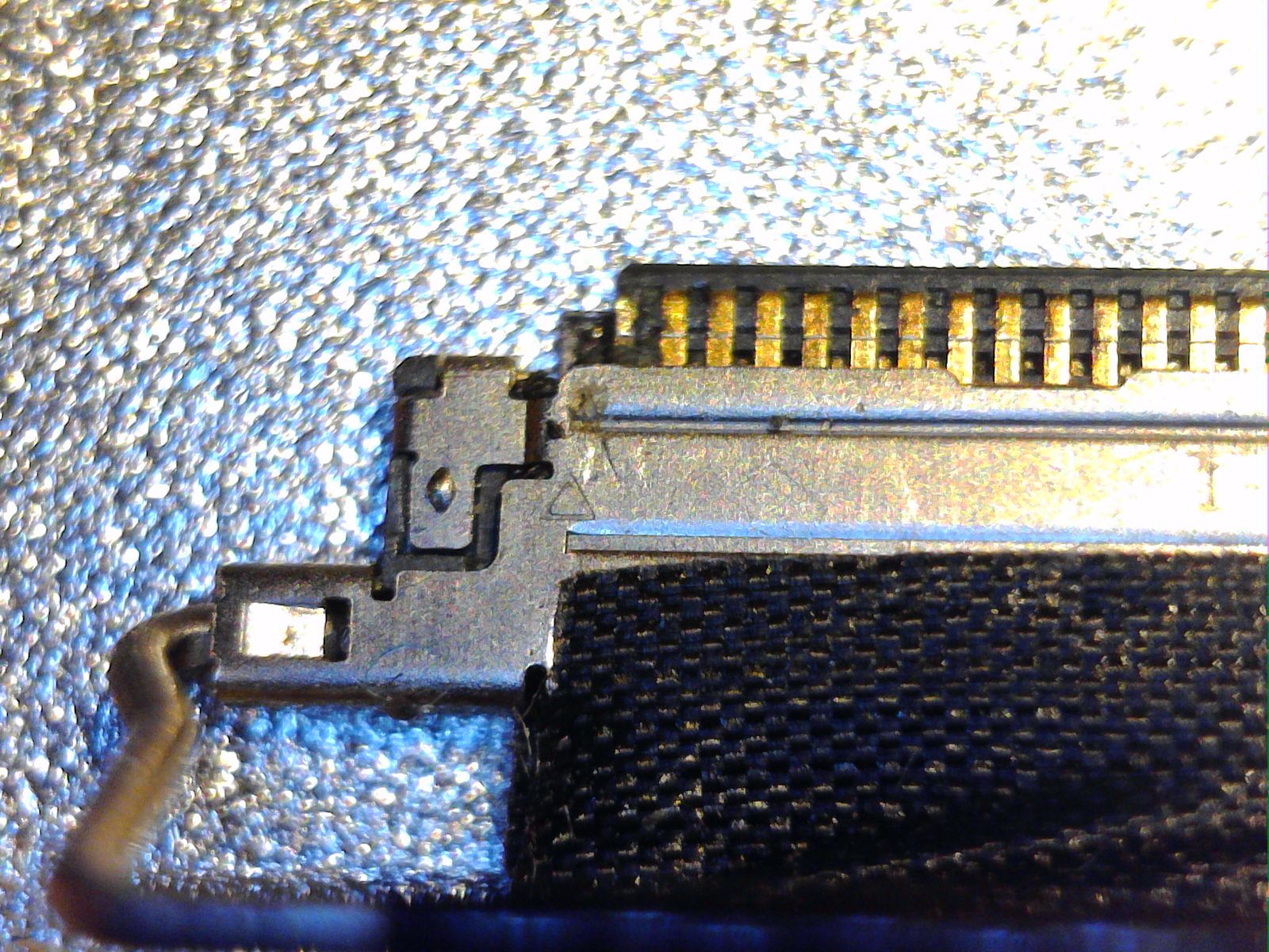

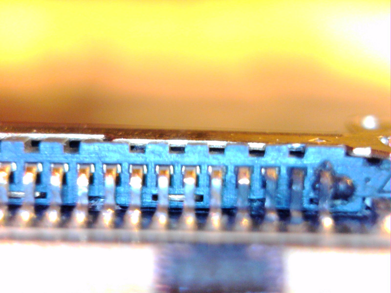

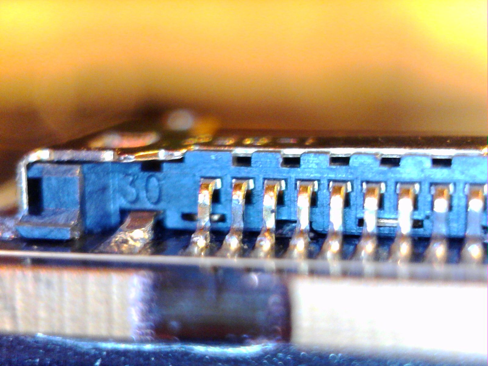

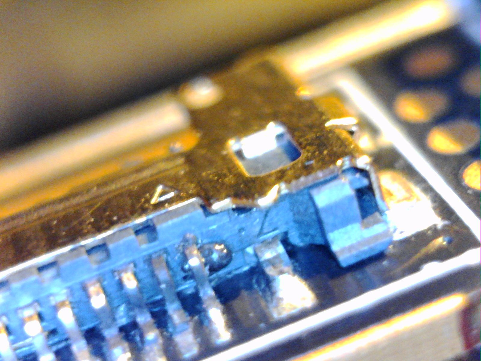

                    Re: Macbook Pro A1502 820-4924A no backlight
                    I adding some microscope shots of the connector. It looks like pin1 is completely gone on the cable. Also the screen connector looks bad, not sure if that's still good to go? I think there is some melted metal behind the outer pin, that blob?
                    When I look at the boardview, J8300 has 43 pins, here I see 30, how?
                    Pin2 on the board seems desoldered, but wait boardview says it is unconnected...
                    • ACS-Repair
                      • Feb 2021
                      • 204
                      Definitely your LVDS cable is toast. unfortunately, I suspect that the connector on the display is bad as well. The "blob" you are seeing on that connector is melted plastic coming through the back. As Stephan says, you will need to replace that screen connector.
