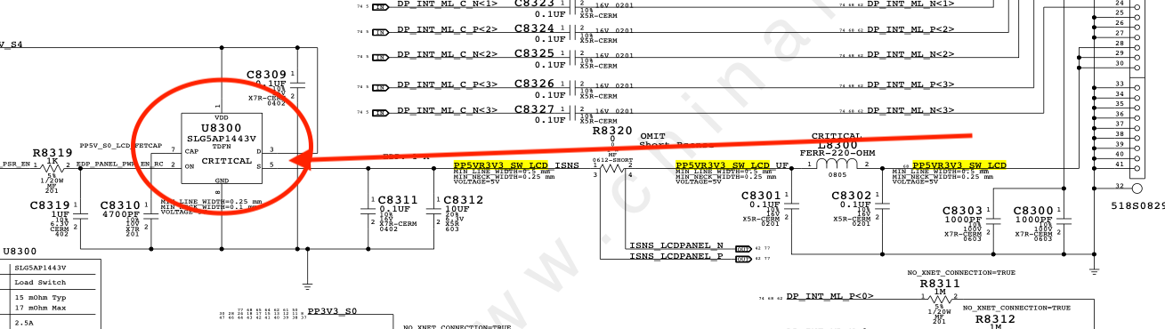

                                  The new resistance looks good.
                                  Measure, very carefully, the voltage to ground of PP5VR3V3_SW_LCD at the connector. This is the power rail to power the LCD display.
                                  • sdogs
                                    • Feb 2016
                                    • 90
                                    • Italy
                                    Re: Macbook A1502 820-3476-a no backlight
                                    after the measurement and I get 5.15 v for about 3-4 seconds, then it goes back to zero
                                    • mon2
                                      • Dec 2019
                                      • 14662
                                      So this may explain why the display is dark aside from a missing backlight. The main logic board is shutting down the power rail to the display.
                                      The next logical step is to trace this same power rail back to the regulator linked to the display. It will feature an enable pin.
                                      Check if the enable pin is also active for 3-4 seconds and then shutting down the power rail. If not, and the enable pin is always ON, then the local power rail regulator is defective.
                                      Also of concern is the current draw sensor for this power rail and the backlight rail. If the current sense circuit is defective (ie. missing parts / traces) then the logic board will force the rail to shut off as it believes there is too much of a load (current draw) and is beyond the spec outlined by the design engineer. That is, like an electronic fuse.
                                      • sdogs
                                        • Feb 2016
                                        • 90
                                        • Italy
                                        I know I'm stressing you, forgive me ;-) As per the attached image, do I follow the line?
                                        The regulator is U8300 at pin 5, is this correct?
