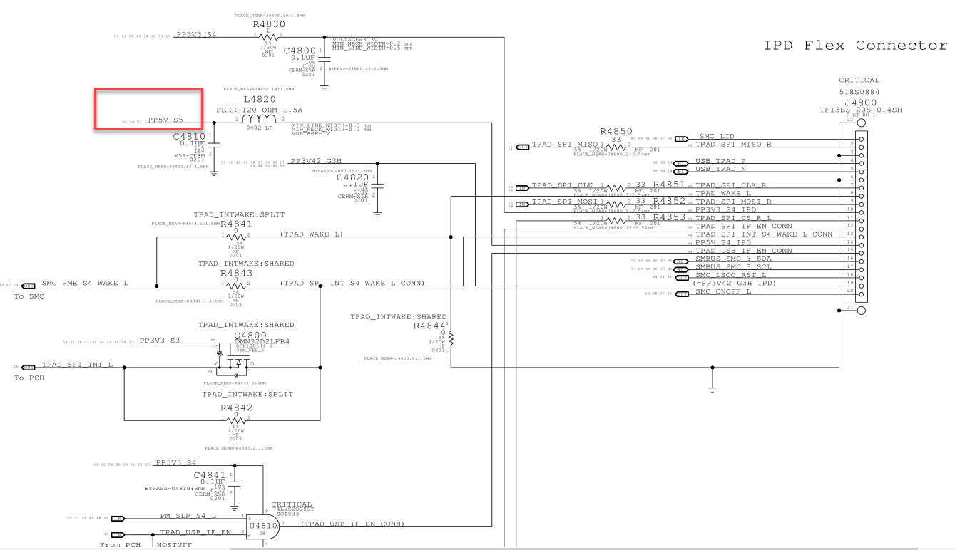

    Problem: It came as dead-no light at all on magsafe.
    Steps taken:On observation under microscope, Found U1900 badly corroded on pin1-2-3-4. Desoldered the Ic, cleaned the tracks and resoldered it. No corrosion anywhere else, no liquid damage. MB started,fan spinned and there was chime,I turned it off & left it on the table overnight.Next morning the mb refuses to start-magsafe remains green(not going orange) and no fan spin. Consumption fluctuating up and down from 0.008A to 0.330A on dc bench supply. Lifted U1900 again and cleaned , resoldered but no joy.
    SMC_BC_ACOK:3.3V
    U7100-DC-IN-16V
    PPVRTC_G3H-3.3V
    PPBUS_G3h/PPV3V42_G3H-OK
    PP5V_S5-keep pulsing from 1.5V to 5V(PROBLEM)
    Resistance on PP5V_S5-45K and on diode mode-OL.
    I've replaced U7501 and flashed known good bios with clean me but problem remains.
    I dont have much experience on mac's and dont repair them on regular basis. Need help guys.
    PS: I'm using genuine magsafe245W cable for bench supply. Tried with genuine magsafe245W adapter as well.

      PP5V_S5 is powering the TRACKPAD. Suspecting an issue with the track pad.
      Power down, remove the battery and then remove the trackpad cable.
      Then power up again and see if this rail is stable.

                        More suggestions:
                        1) What is the exact voltage reading @ L7095, pin 2? This PP3V42_G3H must be @ 3.42 volts or very close to this value. At 3v3, it is too low and means something downstream is causing an excessive load.
                        2) If the above is not stable, also list the Vin to U7090 by monitoring D7005, pin 3. This is relatively easy SOT-23 / SOT-323 diode to probe.
                        3) PP5V_S5 is the output of an internal LDO regulator inside U7501. U7501 creates this LDO output with the assistance of PPBUS_S5_HS_OTHER_ISNS as the input @ pin U7501, pin 23. Tracing back PPBUS_S5_HS_OTHER_ISNS, see U5430, pin 5 and pin 4.
                        Confirm the voltage on pin 4 of U5430 = PPBUS_G3H with no pulsing. Ok?
                        Confirm the voltage on pin 5 of U5430 = should match PPBUS_G3H with no pulsing. Ok ?
                        If not ok, confirm these related resistors and current sense IC @ U5430.
                        Next, confirm the ENABLE pin of U7501, is it pulsing with the observed 5v0 voltage rail ? If not, then U7501 needs to be inspected further as it is deciding to pulse the PP5V_S4RS3 rail.
                        Observe the pulsing is present @ L7520, pin 1.
                        Next confirm the current sense parts for this rail @ U7401, pin 7 & 8 (R7556, R7547, C7518). They must all be present and of the correct values.
                        Confirm the voltage divider (feedback resistors) @ R7520 & R7521 are present and ok.
                        Confirm pin 22 of U7501 if P5VP3V3_VREG3 = 3v3 ?
                        U7501 is relatively easy part to source and may need replacement.
                        4) U1900 generates PPVRTC_G3H. U1900 is powered from PP3V42_G3H which again should be stable @ 3v42 or very close to this value. The PP3V42_G3H is intended to source 300mA so if this rail is lower, then someone downstream is guilty of too much loading.
                        On a similar logic board repair, the issue was related to the USB hub controller IC. After the USB controller (Microchip) was replaced, the logic board was repaired.
                        Perhaps consider to source a fresh U1900 and see if the rail still pulses.
