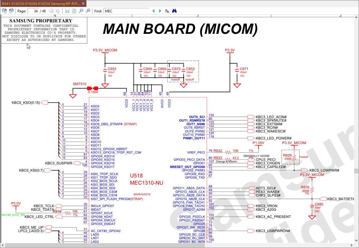

    Hi!
    Samsung Scala2 BA 41 .
    After Applying power don't show any reading at 0.00Amps .
    Stays like that until i press power button ,than Show Amps shows
    0.01 for 10-12 seconds ,Than Board starts Amps reading goes to 0.52 to 67 .
    if power button pressed turns off as normal , if turned on takes same time 11 seconds to start. same time takes battery to starts
    is SMSC MEC1300-NU defective ? is it programmable IO chip.
    Does any one has this board ,i want image of NEC TOKIN image ,seems 1 resistance or pf missing

    Re: Scala2_ext BA41-01424A starts late and no display
    hi. Is this U518?
    Last edited by mon2; 04-17-2021, 06:25 PM. Reason: revised for BA41-01424A schematic
      Originally posted by mon2
      hi. Is this U518?
      No its SMSC MEC1300-NU
          The SMSC is p/n MEC1310-NU (not MEC1300-NU). Which part do you show in your schematic? Please confirm @ U518.
          Start with your power rails. With an attached adapter - check the voltage @ each coil. Is each power rail working properly ?
            Thanks for reply
            Board came with SMSC MEC1300-NU ,Might be tampered/ changed i don't know ,Well When the board starts after power button pressed seems fine
            L9 P5.0V_AUX
            L 10 P3.3V_AUX
            L 8 1.5 for Ram
            L 2,3 .8 cpu_core
            L501 .8 EGFX_CORE
            3.3 & 5 starts power switch pressed ,after 12 seconds board starts fan spins led glows
            My board is Ba41-01424a
