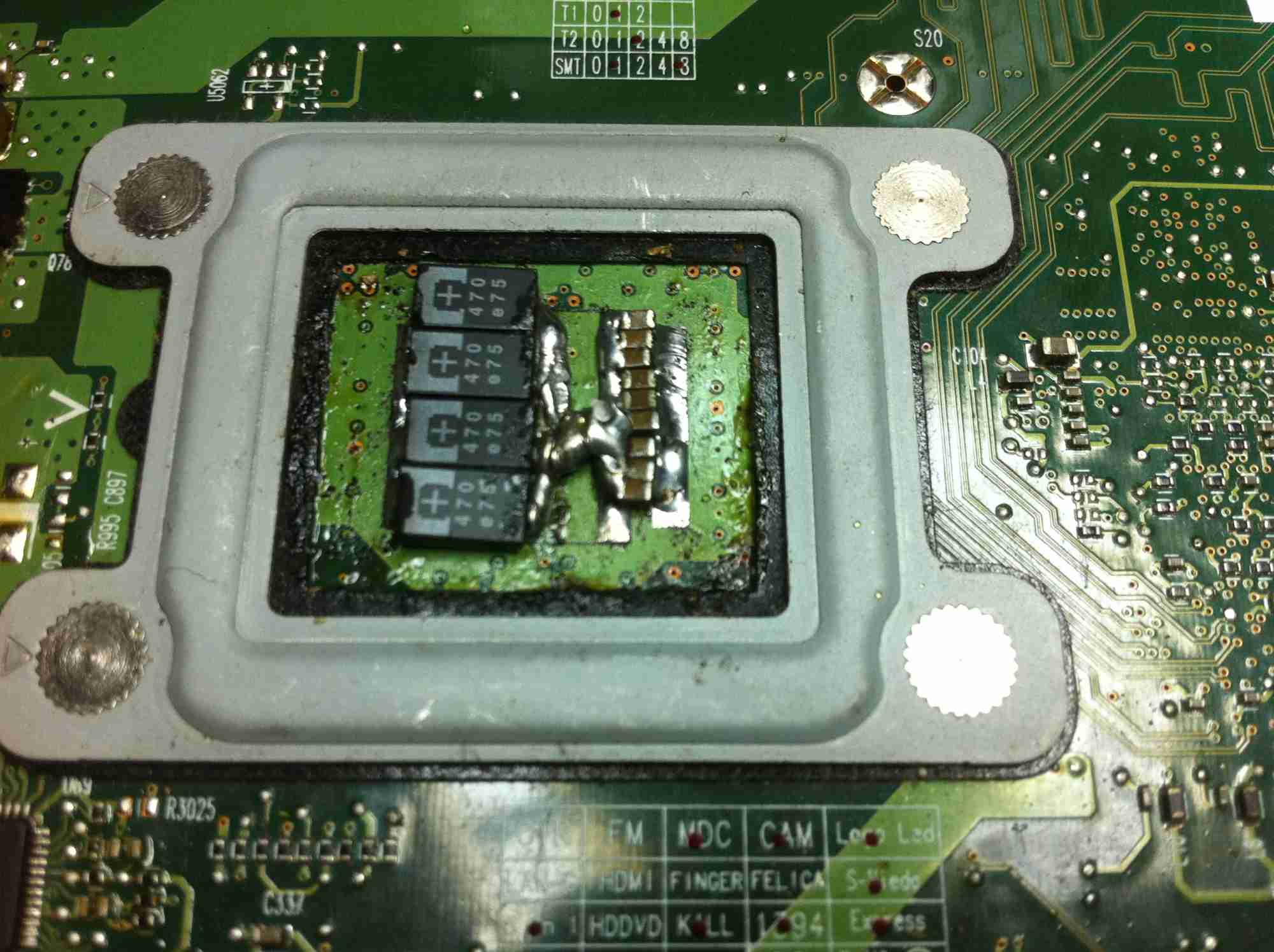

    Interesting one here. I've got a Toshiba Satellite that will lock up almost as soon as you plug it into AC. If you run it off the battery, it won't lock up at all and runs fine until the battery runs out.
    Tried a brand new ac adaptor and still has the issue. Doesn't seem to be overheating, and I even pulled it apart and put new AS5 on the CPU heatsink. Didn't find anything else noticibly wrong when I was in there, either.
    Any thoughts?

                Just fixed one Satellite A300. This is caused by a bad cap. A big one - NEC/TOKIN 0E907 (900uF/2.5V) under the CPU. Mine had 900uF but probably lost some of its magic, resulting in >100mV ripple on CPU power. Adding 1x 100uF and 5x 10uF ceramic caps fixed the problem.

                        Re: Toshiba Satellite - Locks up when plugged in
                        Go for Rainbow tip. That huge capacitor is usually responsible for that. Keep in mind that it has four soldered terminals in it. I had success by preheating the motherboard (150ºC) and then using a hot air rework station to remove it.
                        Two soldering irons won't do for that one (or at least will be very difficult).
                        But in my case I replaced then with 4 330u 2.5v tantalun SMD capacitors.

                          can you post a picture ? i want to see the finish job , the space is too short to 4 caps here , if possible of course...

                            Wooooww!! it work's !!! i change a little bit the prescription but it's perfect!!
                            i put 10 ceramic caps on right side and 4 470u tantalum on left side and now it's like a new one , thankyou everybody , now i want to post a pic of the job to help others , can someone help me to post a pic ? what max specs of the pic please...
                                    I had the opportunity to solve another one with that same problem, this time I took some pictures. Hope it helps.
                                    The notebook is a Toshiba Satellite A305-S6872.
                                    The first image shows the capacitor removed, board cleaned.
                                    The second, new solder added to the pads.
                                    And finally, the finished job.
