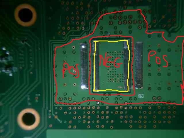

                #147
                Re: Toshiba Satellite - Locks up when plugged in
                When I had looked at the diagram of OE128 it was referring to two pads being on the input side and the other two on the output side. If this is indeed the case then I would prefer to have equal uF on ether side. Why not consider using a 470uF cap on either side:
                http://australia.rs-online.com/web/c...=470uf+low+esr
                Of course, the safest way might be to get the exact replacement and wait for others to take a plunge first before you make up your mind for the next replacement, if necessary:
                http://www.ebay.com/itm/1x-NEC-TOKIN...-/400248772449

                    #149
                    you could put all 3 caps on one side it would not make any diffrence,
                    the 2 positives are one, as are the 2 negatives as seen in this picture
                    https://www.badcaps.net/forum/showpo...6&postcount=18
                    some members have replaced the nec/tokin with original only to find it go again if I recall, look at this link
                    https://www.badcaps.net/forum/showpo...&postcount=125

                      #150
                      trebo,
                      Which of the three photos shows that the positives are connected to each other? I know that OE128 itself connects the two negatives but it had two separate positives. The positive pads also appear far apart. Are they internally connected?

                        #151
                        trebo,
                        If I am not mistaken
