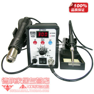

            can i use this tool to remove the tokin capacitor?
            Originally posted by ablacon64
            Infrared rework station.
            It doesn't matter if the capacitor melts, it's useless anyway.
              Yes and no. It will work but it's not the recommended tool for the job. You can damage the mainboard.

                so to say that the best and safe way to remove the SMD is using the BGA rework station, right?

                      how much did you paid for your Achi IR-6000. The machine easy to use? is this the machine as shown?
                      I have an infrared rework station ("infradark" actually, ceramic heater), brand Achi, model IR-6000.

                                    sorry calculation error for the IR6000 should be USD630. can i get 2 hot air gun to do the job? the hot air gun i saw from the chinese site selling for USD40 only.
                                    The price is high because of the taxes. In Brazil the government taxes are one of the world's highest.
                                    This machine basically heats the motherboard from below and from the top, no secret at all. It heats up following a predefined profile to avoid stressing the PCB and the components and perform an uniform BGA soldering. You can do the same with a electric grill (or a pancake griddle or even a hot plate) and a hot air station like the one you posted before, but it's a little trickier.
                                    I prefer using the IR6000, but when I did not have the money to buy it, I used to have an electric grill and a hot air station and was able to perform the job normally. So, you may want to give it a try before spending those thousand dollars.
