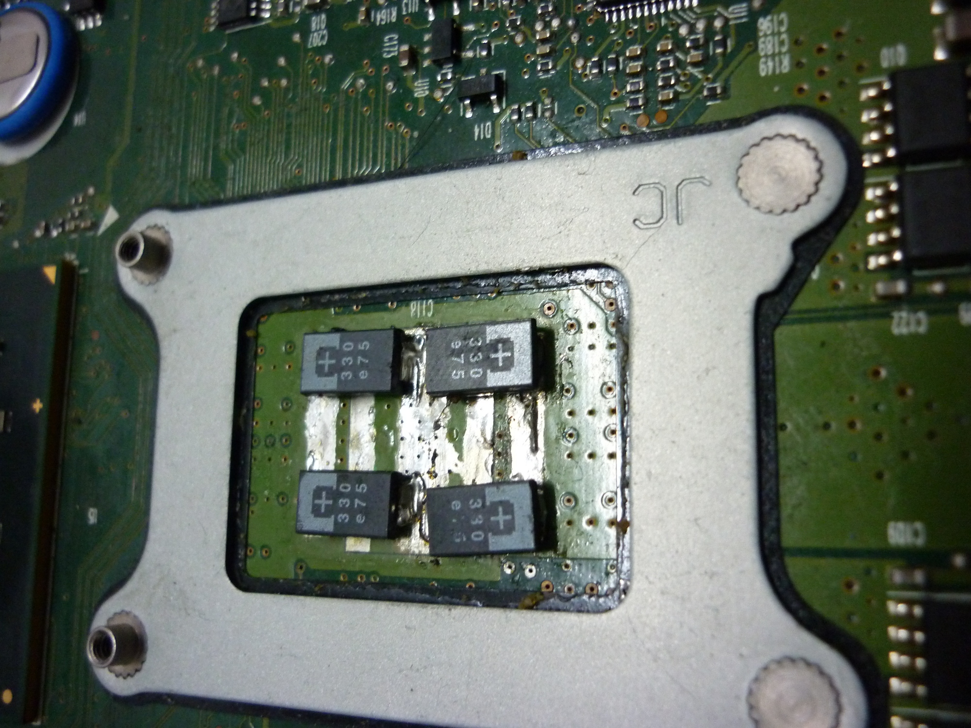

                          Originally posted by ablacon64
                          I had the opportunity to solve another one with that same problem, this time I took some pictures. Hope it helps.
                          The notebook is a Toshiba Satellite A305-S6872.
                          The first image shows the capacitor removed, board cleaned.
                          The second, new solder added to the pads.
                          And finally, the finished job.
                          Can i use higher voltage tantalum capacitors for the above solution? (like 10 v) ?

                            #73
                            Re: Toshiba Satellite - Locks up when plugged in
                            No problem.
                                          Was this having nec/tokin OE128 OR 907 previously? Is it ok to solder 4x 330u s for a board having a OE907 originally because its capacitance is 900u right?
