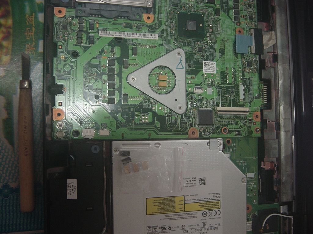

      feel like my dell n5010 picking up an new hobby, auto turn off in between fews seconds, in BIOS and windows. if cold start the notebook can stay on for until boot into windows desktop, just that then power off, not restart. Previous problem is overheating, problem solved. Is this something todo with the tantalums? right? i saw 2 SMD at the back of the processor, 220uf[03TW d] and 330uf[04VOS d]. 3 more SMD 330uf and one 220uf on the mainboard. Could i solve this auto turn off problem by replace all the SMD 330uf and 220uf with 330uf? also not very sure what type of the tantalums voltage. cpu/gpu temperature is between 60c-75c, but the notebook casing is lot higher, about 80c++.

                                      solved a DELL N5010 notebook auto-turn off, screen freezes by replaced 2 unit SMD 330uf 10v. the 2 SMD behind the CPU. still monitoring this notebook for any problem...
                                        What is the value of the 2 smd caps that you've removed, did you check?
                                        • zinksoft.net
                                          • Nov 2013
                                          • 17
                                          • malaysia
                                          #720
                                          Re: Toshiba Satellite - Locks up when plugged in
                                          one is 220uf, one is 330uf.voltage unknow so i put a 10v 330uf from ebay all i can found. only problem left behind is the DELL notebook common problem, overheating! solved it set Max CPU usage below 90% and a cooler pad. overheating
