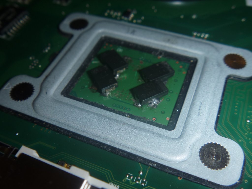

    Ok so after cleaning up the solder. With some help from my cousin I finally managed to re-solder the caps on.
    After the process the laptop turns on with the ac adapter plugged in, but the display does not turn on. A light on the laptop tells that the laptop is on and I also confirmed it by hearing the fan spin.
    I will post the pictures.
    The first picture are all the lights.
    The second picture is the VGA that I used to plug into an external moniter to see if it would work. It did not.
    The third picture is the iron I used.
    The fourth picture is the re-soldered caps.
    So. What went wrong? Any feed back would help.
      Re: Toshiba Satellite - Locks up when plugged in
      outer strips are positive terminals, one solder overlapped the other. You should redo it first. The one with huge led ball.

            Take a multimeter and test the resistance between the positive and negative strips. If it reads only a few ohms, you have shorted somewhere.
            Also, the bottom blob of solder on the negative terminals covers part of the positive side of the PCB. There shouldn't be any conductive material in that area but if the surface has been scratched, eg by the soldering iron, that may also cause a short.
            What capacitors did you use?

                                    Repaired Toshiba L305 with success . NEC / TOKIN 0E907.
                                    Capacitors are 330. Extracted from a damaged motherboard HP-DV6000.
                                    Here I share pictures of the steps performed:
                                      This step must be done very carefully, I drew a line with the tip of the screwdriver to weaken the metal foil and then I could break and lift. I used a common 30W soldering iron.
