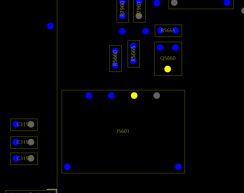

MacBook mid 2012 A1278 fan connector Pads Missing
  • Smudger17
    • Mar 2021
    • 3
    • United Kingdom

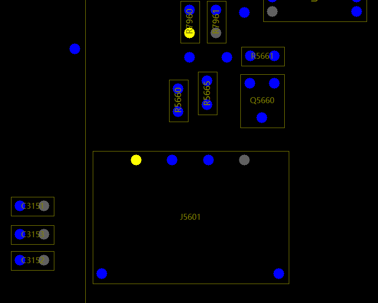

    I have an A1278 mid 2012 logic board number 820-3115-B and I have lifted the pads from the fan connector. As I don't have access to another laptop I can't view the board view file. Could someone please tell me where I have to jump the wires to please.
  • mon2
    • Dec 2019
    • 14667

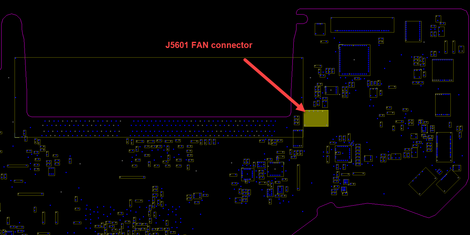

    Re: MacBook mid 2012 A1278 fan connector Pads Missing
    Hi. Please see attached. Does this help?
    • mon2
      • Dec 2019
      • 14667

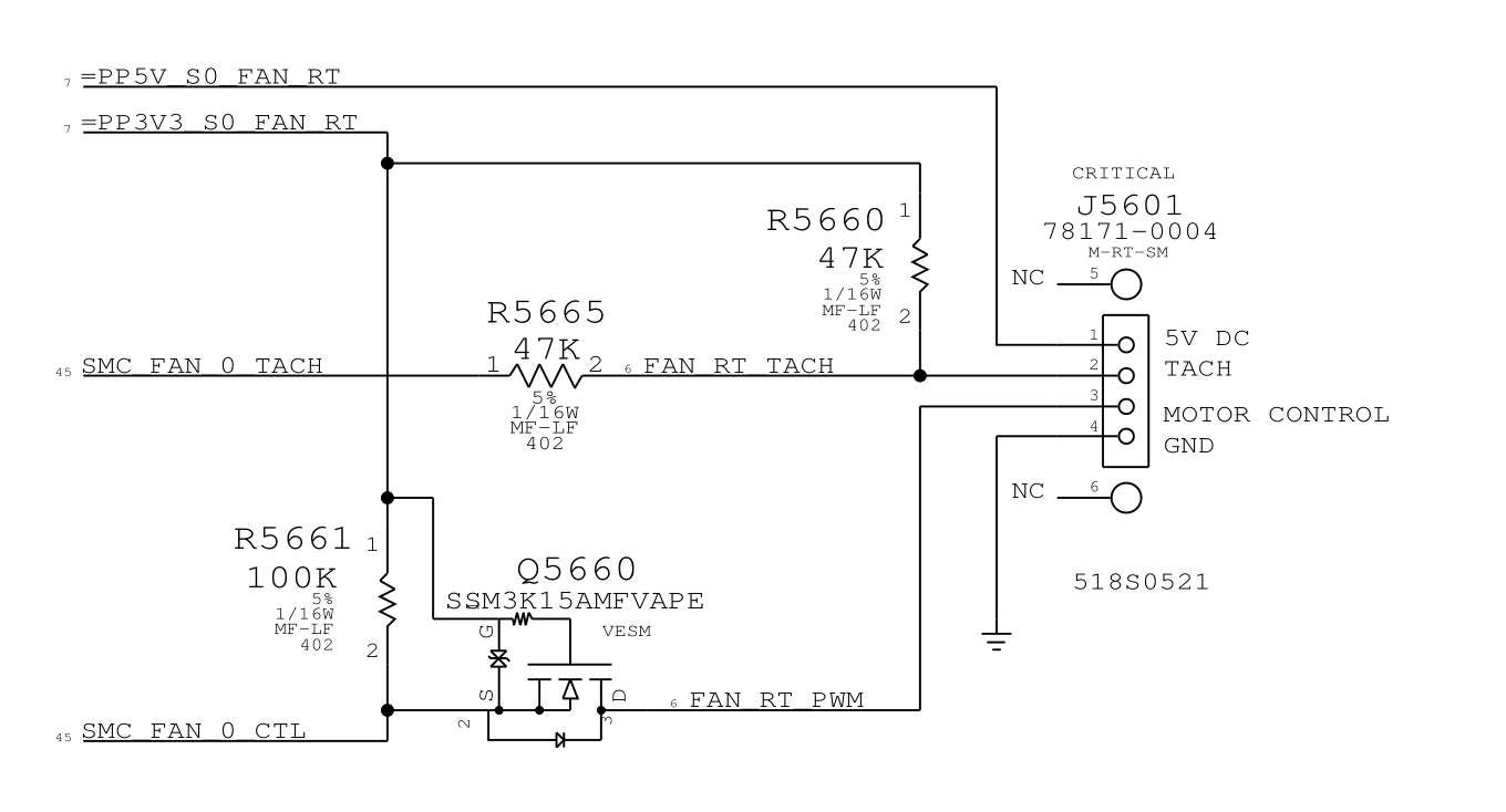

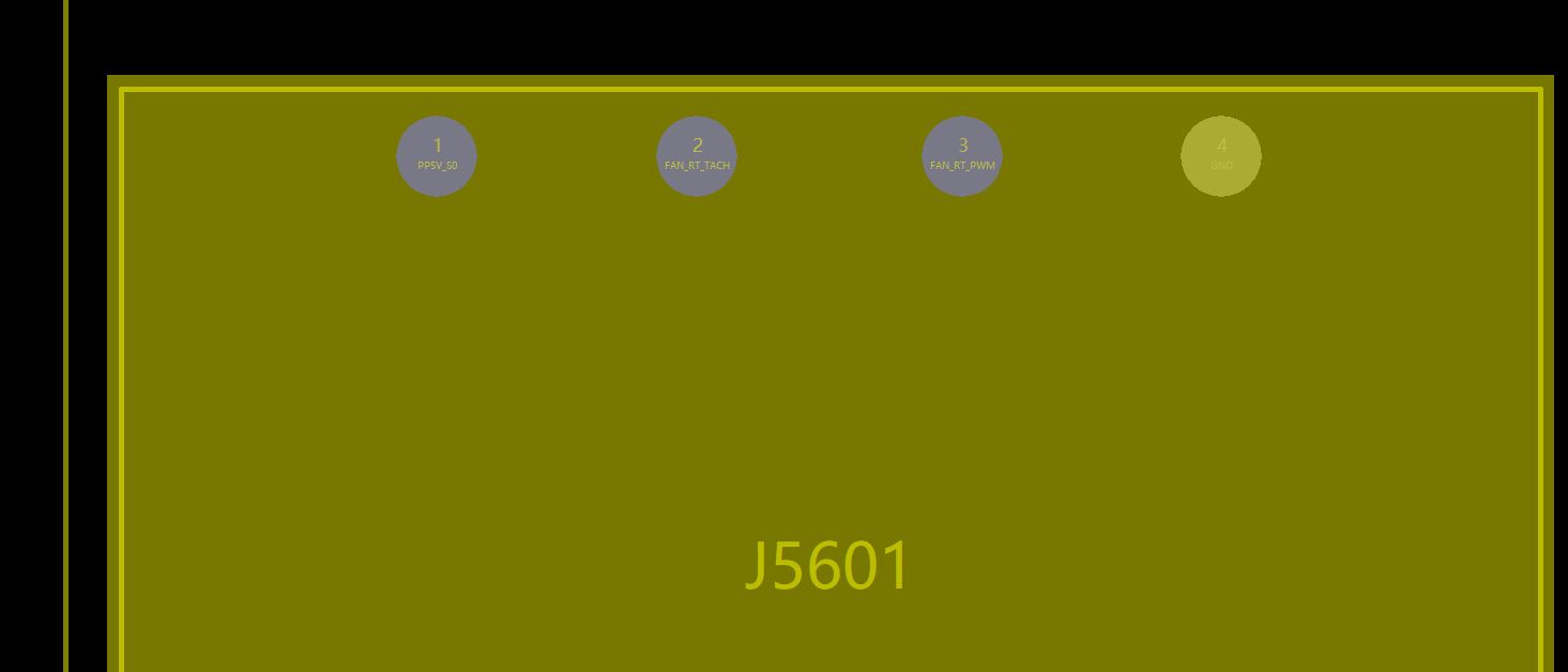

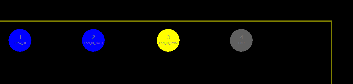

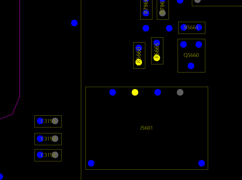

      more..
