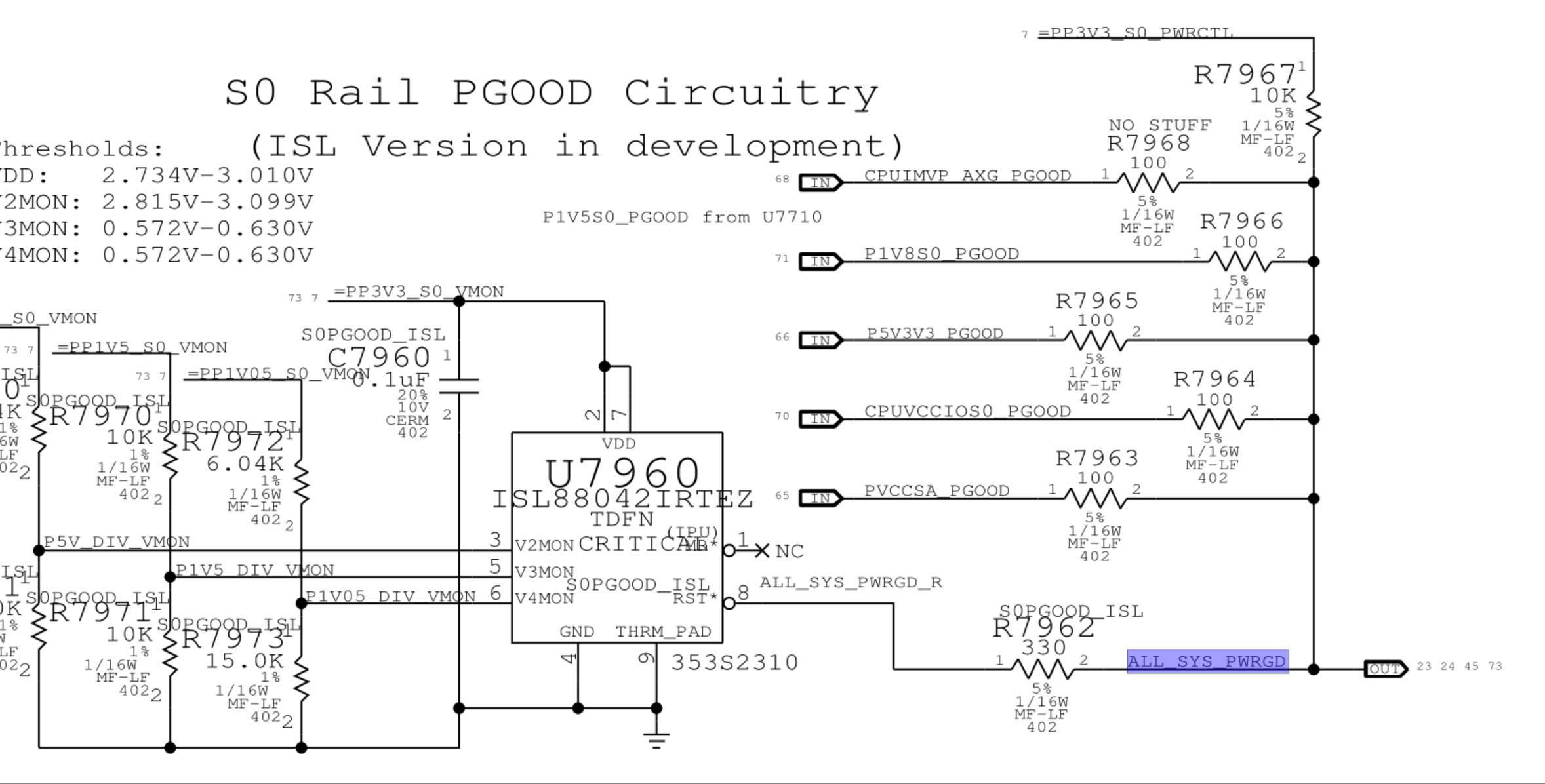

                Re: Macbook Pro 2012 820-3115 Missing PP5V_SUS
                So at least one of the power rails is not working.
                It is bringing this logic status to LOW. Every power good needs to be HIGH to indicate the power rails are working.
                The attached is the logic 'AND' gate built up from the power good signals.
                If each input is HIGH, this signal line is HIGH = good to go.
                If even one of the power good signals is low, then this signal will be LOW. A low on power good means the power rail is not working.
                To debug this, you can flux and remove the series resistors on this tree. One by one, confirm the power good signal is OK and is NOT low.

                  Not to sure i understand what you mean. Do you mean remove the series resistors on left of U7960 according to the schematic one by one.And like each time i remove one resistor check to see if ALL_SYS_PWRGD returns ?
                  • mon2
                    • Dec 2019
                    • 14259
                    No. See above the purple highlighted signal that was posted.
                    That is the output 'AND' tree from each power good rail.
                    Remove each resistor with flux. Keep track of which parts you are removing. Then apply only one at a time back onto the board.
                    If even one signal is low, this output will be low. We need to know which one is low.
                    • platinumsteel
                      • May 2019
                      • 234
                      • Trinidad&Tobago
                      Okay just finished testing.I removed all resistors first checked for all_sys and nothing.So each one i put back in.I tested right after for all_sys and 0v for each time i put it in.All resistors are back in now.
                              Re:post #11
                              If you removed all power good resistors and still had a low, this means your pull-up voltage at very top of the tree is missing.
                              Check the pull up resistor and the voltage on the high side. Is it present?

                                @mon2 Not to sure which pull up resistor to check.And the voltage on the high side.
