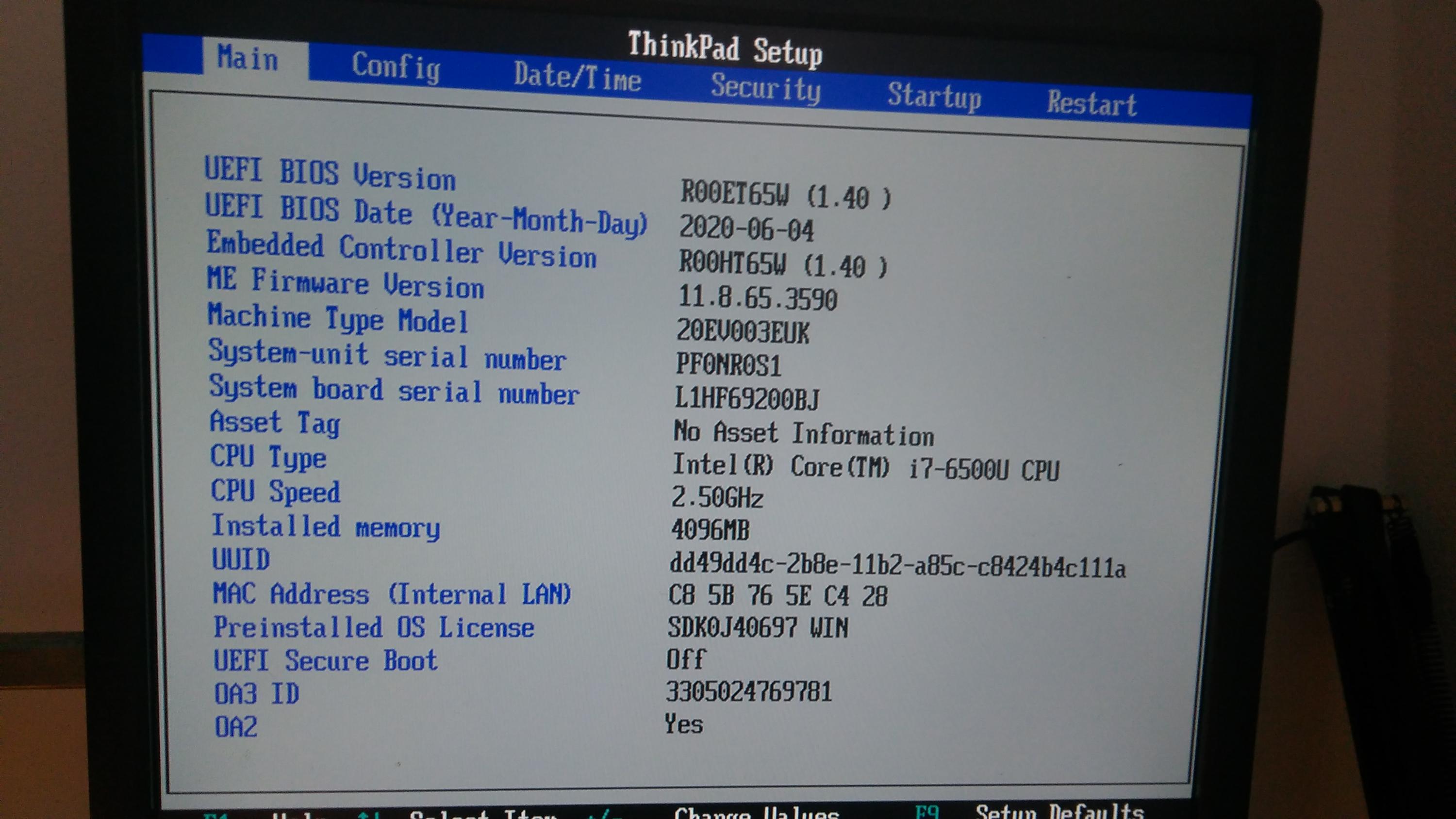

    Hello.
    Have this Lenovo E560 NM-A561 that get BSOD - ACPI BIOS ERROR when start to install windows 10
    reflash bios and still the same

                        Re: Lenovo E560 NM-A561 - ACPI BIOS ERROR when install windows
                        bios is 1.4
                        try recovery key but it do the same
                        DMESG in linux tells me that is some BIOS _OSI firmware bug.
                        Laptop have fall from 1m
                        reflowed pins of SIO to clear that is no crack, but nothing changed
