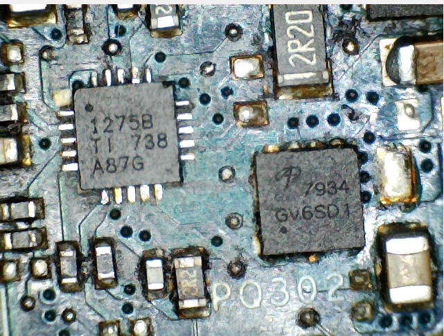

        Back again.
        as you suggested I changed mosfets and PU301 but now all is dead.
        It was really hard to change PU301 but it seem I did it good as attached picture.
        Help please.
        • mcplslg123
          • Jun 2015
          • 7262
          • india
          Re: HP 250 G6 MB LA-E791P overheat and power off
          Yes, the soldering seems proper. If mb was booting fine earlier and now its dead means the replacement ic is bad or it got killed 'coz of excessive heat apllied during soldering. You can check whether 3/5V LDO is present or not.

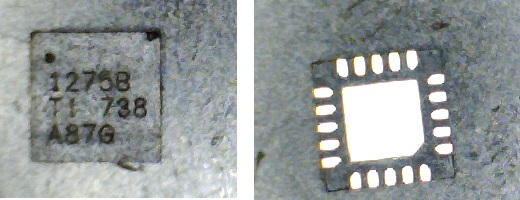

            Just before to solder the new IC I had a sort of doubt that maybe it was defective because as you can see in the other picture I made before to solder it there is a little crack in the upper right corner that I suppose it was a factory defect because component was in its original package.
            Anyway I'll also check 3/5V.
              2.2 resistor looks like it been hot
