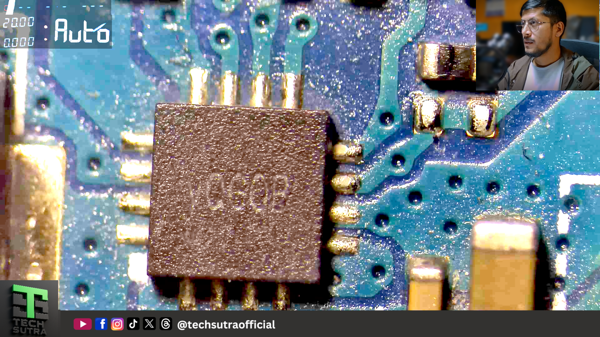

    Hello my precious masters;
    Lenovo LOQ - LA-N221P Rev 1.0 I need the code/model number of the PU301 integrated circuit on this mb. The integrated circuit is burnt and cannot be read. Can you help me with this?

        I think it's a SY8386B chip - 3.3v fixed voltage converter. Datasheet isn't available and hence i can't provide one. There is datasheet for SY8386R but the pin out has many differences. You may find another schematic which uses this IC and cross check to match. However, a short in 3.3v can kill the PCHA/SoC easily. Check the coil resistance first for short.

          Hello master, thank you for your answer. There was a pch short situation on the device. We made the necessary repairs but we are stuck at pu301. If I can find out what this is, I can move forward.

            I found out what integrated is. Here it is. Thanks to everyone who tried to help.
            YQxxx
            SY8388BRHC
            ​High Efficiency Fast Response 10A, 23V Input Synchronous Step Down Regulator.
