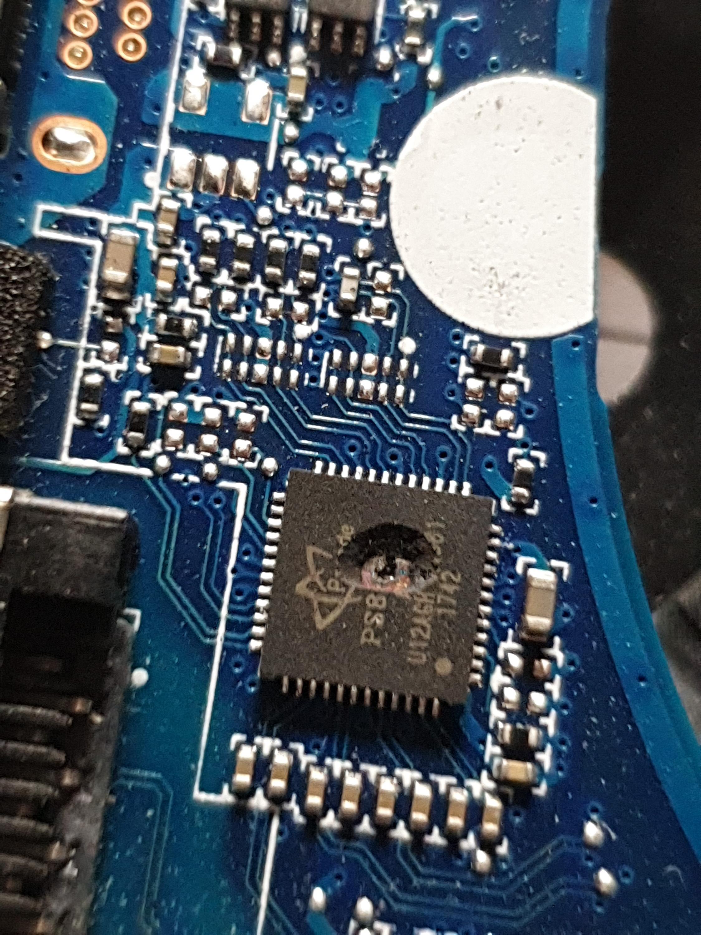

    Can someone help me identify the chip on the picture? The chip is burned so the chip number is gone.
    The motherboard in question is DAG3ABMBCD0 REV: D. HP Omen 15 ce054nd.

    u12agh .......ps8????

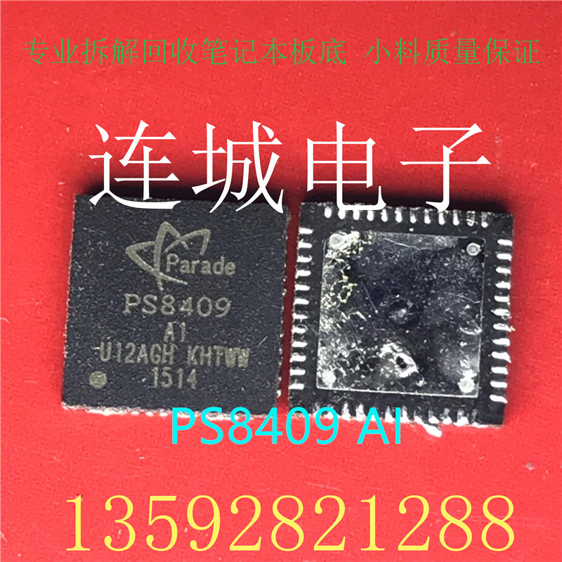

      Parade Ps8409aqfn48gtr2-a0 (a1) QFN-48

        Thank you R_J!
