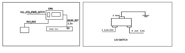

    Hello there,
    I am a little bit stuck here ... as far I can see I got all the volts present ... already converted to UMA ... I was thinking that the problem is the ATI GPU Chip but the problem is that the BIOS is not present. IF it was then I would have some capls lock light reaction, some blinking code etc. but nothing.
    With good known RAM or without I got same thing. So I know that the BIOS is not loaded and I can not find any power sequence for this Board. Bios was already reprogrammed but with the same result.
    Could it be that the North chip is dead ?? Anybody got some tip where to look ?? Thank You in advance.

    Re: HP G6 R22 ,, AMD CPU ... Black Screen
    If you have a postcard, you can find the error code by inserting it instead of WIFI. RAM slot 30 pin 1.5v RAM_RST, WIFI slot pin 20 must be 3.3V. Could it be North chip is problem.
      in picture
        I got the postcard but it shows me nothing as the BIOS is not posting. I got identical board also faulty, but sometimes it does post ... or give me caps lock blinking error code. Also is reacting to power off. This one that I am working on does not react to power off, only on long press the button.
          check with an extern keyboard if board post. Toggle caps lock or numlock.. if it doesn't reprogram bios with extern programmer.
            Already tried that Steve ... with different bios and also with original one from HP. Same result ... very strange.
              Do you have picture on extern screen
                Did the laptop give picture after the conversion, otherwise there is something wrong with conversion to uma and make sure you program bios uma.
                  I have two faulty identical boards ... One that sometimes will post with UMA already done. But the difference is that one that will post sometimes I got 5x Blink Code ... on another one no caps lock blink code ... meaning that the BIOS is not loaded.
                  Basically two faulty boards with different faults ... I got the schematic but there is no power sequence ... just guessing as the board got GPU chip but already disabled, ATI chip maybe this one is faluty ... and PCH
                    Gonna be a dead AMD northbridge as usual.
                      I know that it is very common with these boards ... but is there any chance that it is something else ??
