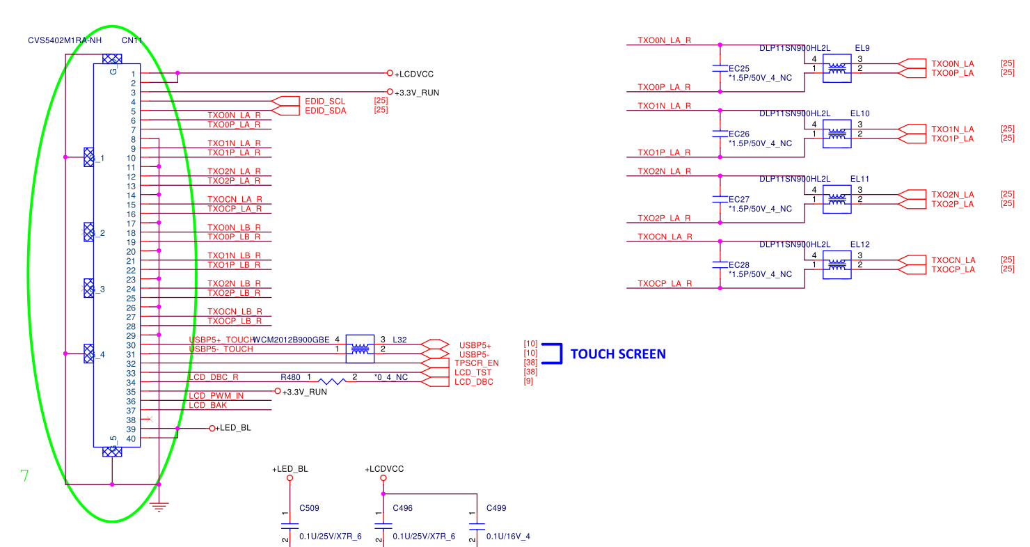

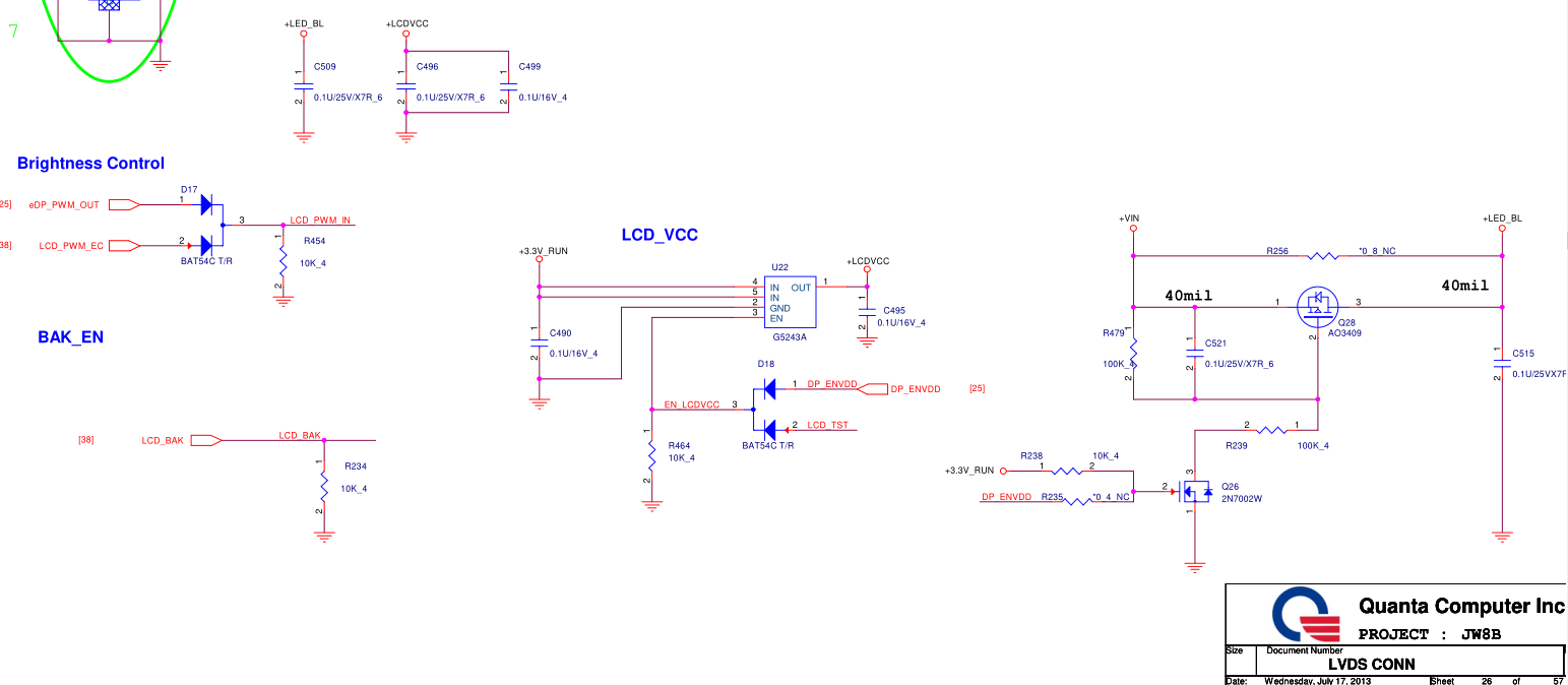

    help me pls. Where lcd backlight fuse on DAJW8CMB8E1 REV E mainboard.
  • mon2
    • Dec 2019
    • 13948
    Re: DAJW8CMB8E1 REV E screen backlight problem
    Could not locate a fuse but please review the attachments.
    If you attach an external HDMI display - does the external display work ok?
    • Sergio Kub
      • Jul 2018
      • 159
      • Brasil
      Here was the U11 with broken welds and I did the resoldering. OK
