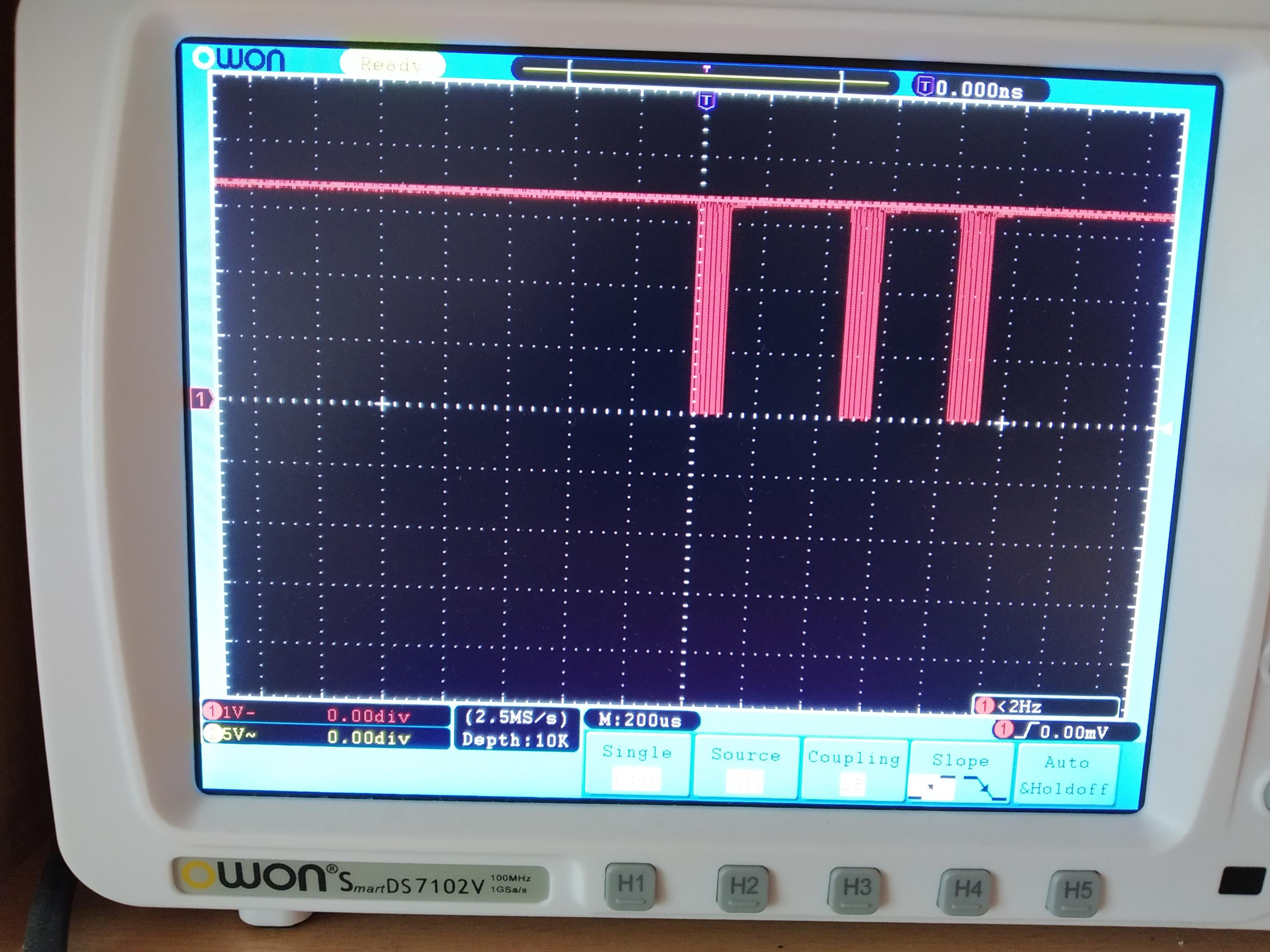

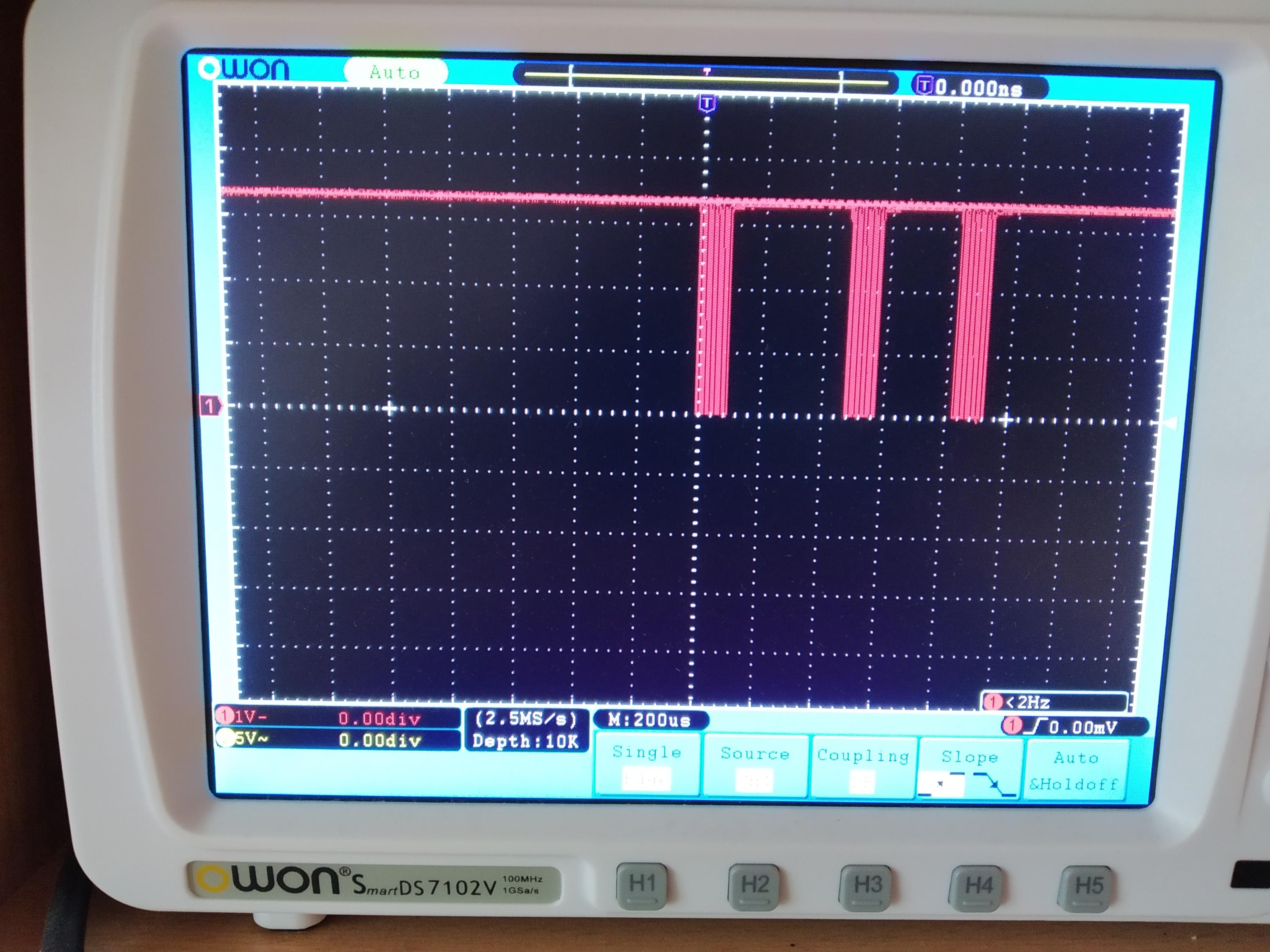

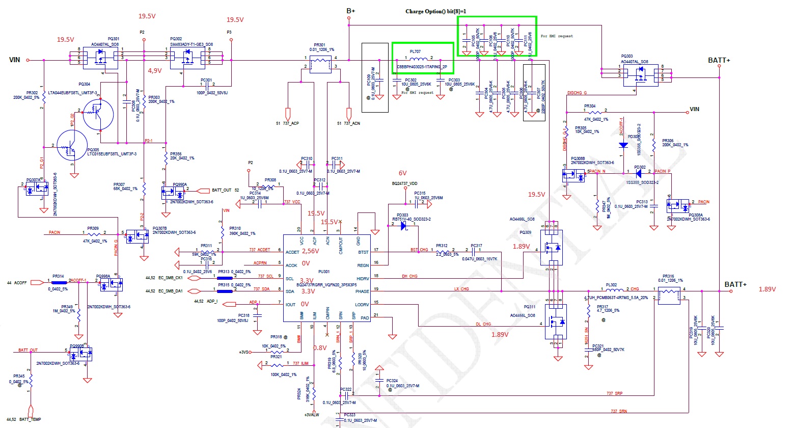

    I have a problem with MB NM-A271 from Lenovo Z50-70, which can't charge.
    There are measured values on IC BQ737 on attached picture, I think there is no problem, but please check it with me. KBC changed for the new one, BIOS and EC flashed, BQ 737 changed as well to be sure, but still not charging at all and charging LED doesn't light up. EC_SMB_CA1 and EC_SMB_DA1 checked on battery and on KBC with osciloscope. Battery changed.
    Any advice what to check?
    Many thanks.

      1,89V on Highdrv, Lowdrv and Phase Looks Like These three Pins are shorted together (Mosfets or IC). Did you checked that?

        check pq309/311 and specially pq306 working or not.

          Sephir0th: no short together
          mcplslg123:pq309/311 changed for sure and still the same. pq306 I can't find.

              The PU301 should be 19v on 20 pins and 3v on 5 pins. Check the PQ301, PQ302 and PQ303 mosfet. and check the DC_IN ADPTER_IN entry.

                Re: Lenovo Z50-70 problem with chgarging
                Pin 20 VCC 19V
                Pin 5 ACOK 0V is OK for BQ737
                PQ301, PQ302 and PQ303 were changed for sure but with the same result
