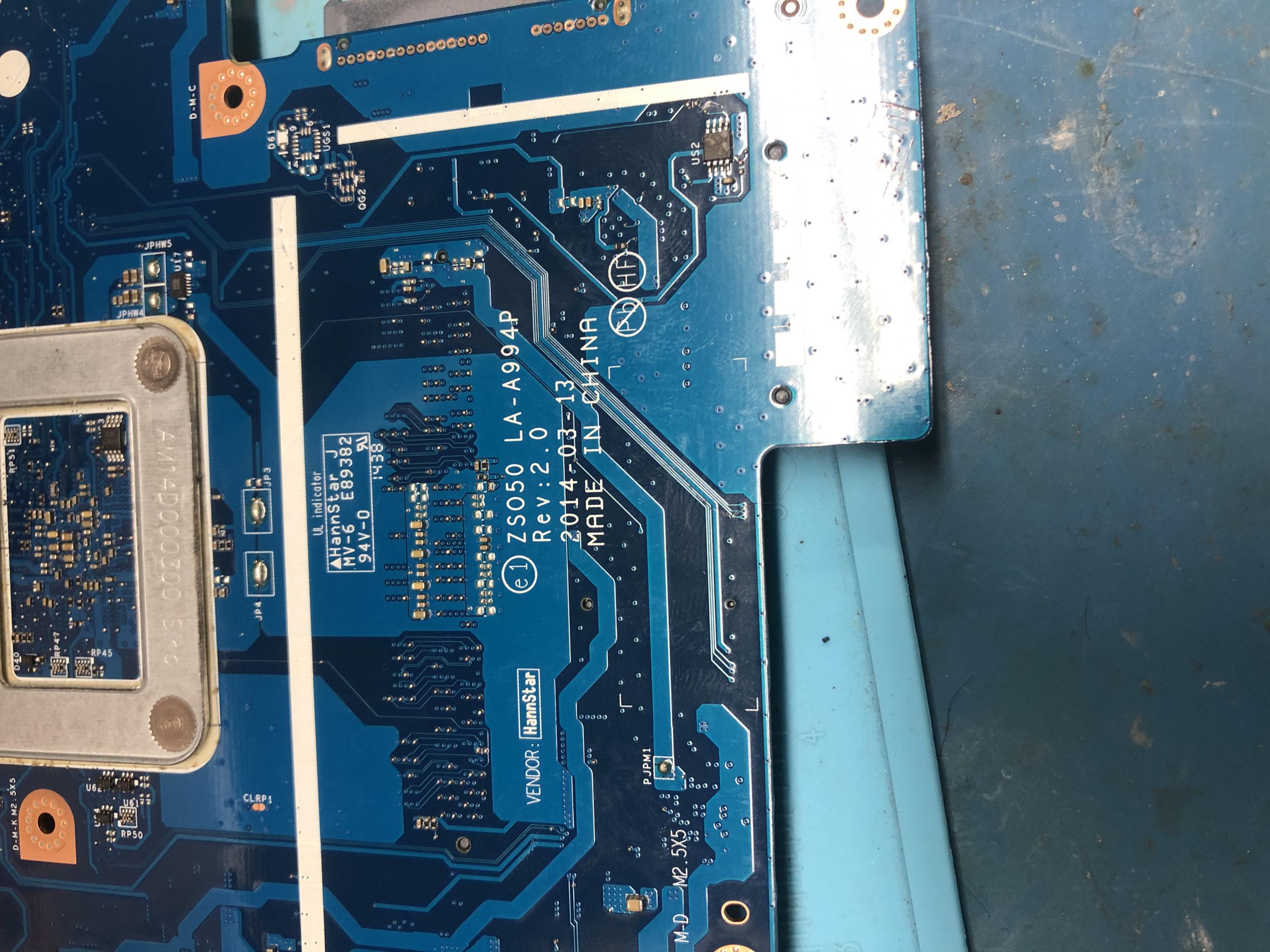

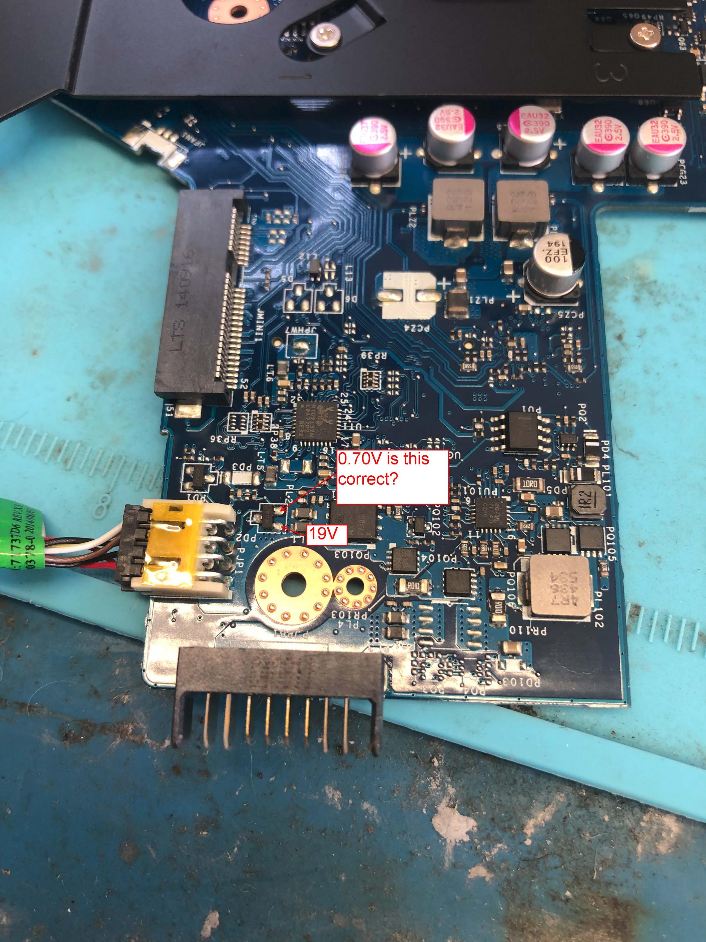

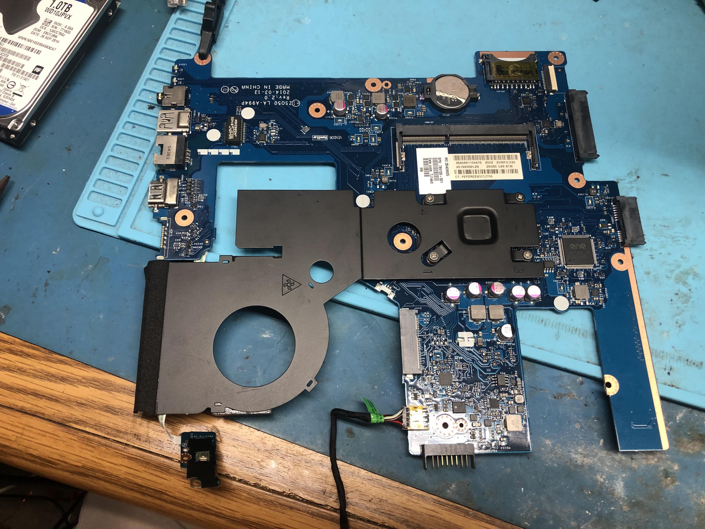

    Okay, I took some pictures where I did the measurement. I don't have schematic on this Version 2 I do have the version 1 but I'm not sure if that is the correct one. Please see attached photo and need some advice.

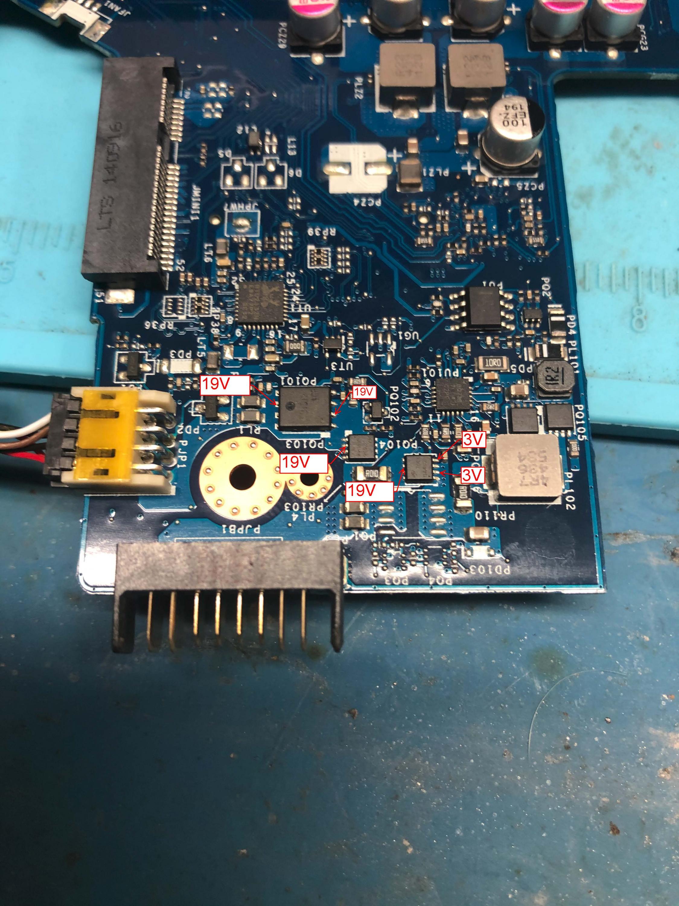

          At PU301 pin 13 EC_ON voltage is present and PIN 11 also present 19v. It could be PU301 DEAD?

            Have you measured all power rails for short yet? If not, do it first. While you don't have 19V after second DC-in mosfet, there must be some issue.
            As far as I know these boards, I guess there could be shorted CPU. But do your own measurements.
            Edit: my mistake, PQ103 has 19V on both sides and 3V is for PQ104, which is correct.

                  I Will try measure this one I will report back . Also on PD2 I have 19V and 0.7V on the other PIN please see attached.

                            Edit: 0.7V ADP_ID seems a little Bit Low, i think should be around 3 - 4V, but unfortunately i'm Not really experienced in HP devices. So can be meaningless, because you're getting EC_ON Signal, AS you Said before.
                            EDIT2: i have Just researched a Bit and believe 0.7V is okay.
