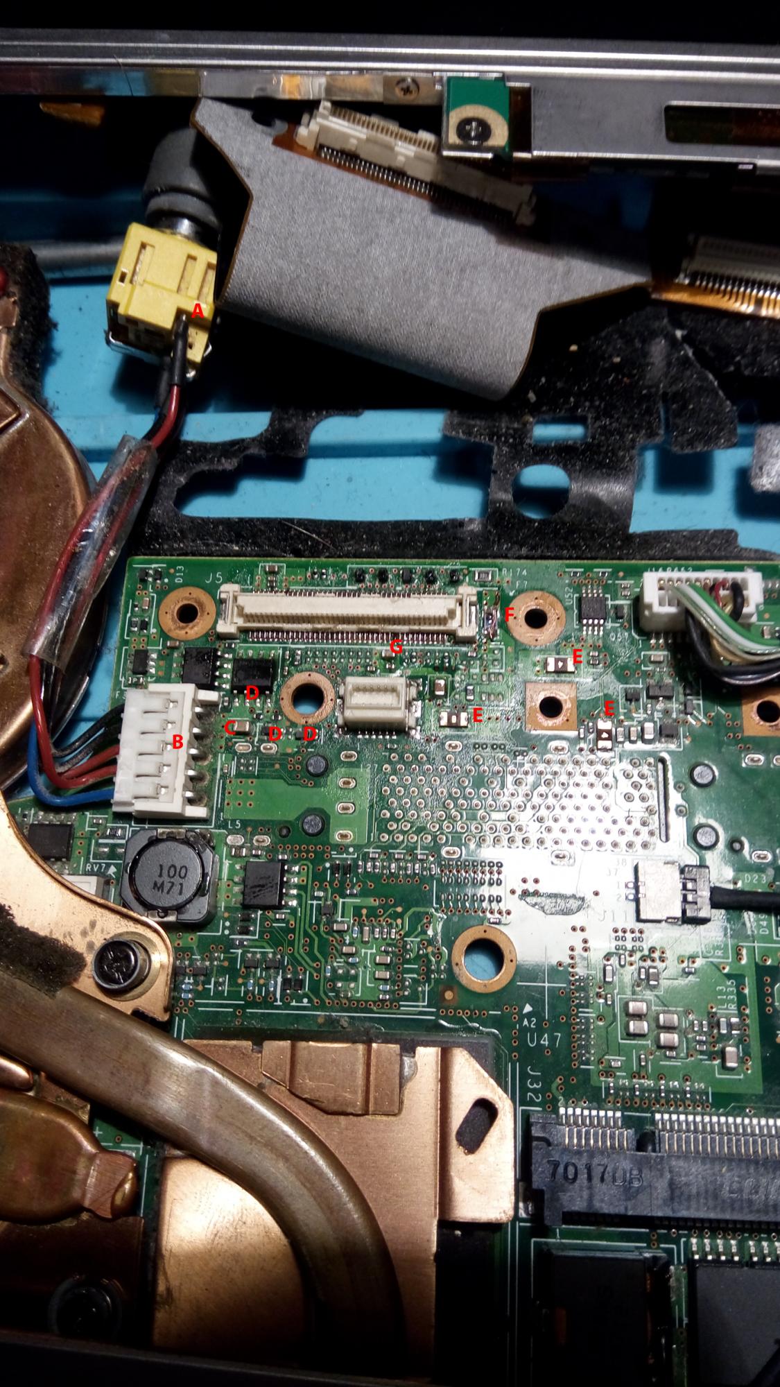

    So I broke out the multimeter and started poking around. See the image and letters, here is what I found
    A: With the laptop plugged in I was getting 20v here, as expected
    B: Same as A, I get 20v here as expected
    C: I get 20v at one end of the capacitor, so I know power is getting to the board
    D: Each of the legs of these transistors are all showing ~19v
    E: Initially, none of these were showing any voltage (or negligible mV). I think these are fuses? They all test as having continuity
    F: This looked like a large fuse, this was getting 19V on one end, 0 on another, and was not showing continuity, so I figured it was blown
    G: This is where the laptop screen cable plugs in. I checked all the pins for voltage and got negligible voltage, a few were showing 3.5v which I believe are the LCD comm channels, but nothing was getting the 19-20v I think it should.
    Now, the odd stuff. As I was checking out G, there was one time where I did find 19v on one of the pins. I have no idea why it tested different that one time. I hooked up the screen, turned the laptop on, and this time I got no backlight and no picture. Just totally dead.
    So I decided to bypass the fuse F. I soldered a wire between the 2 contacts and took fresh measurements. I was now getting 20v on pin 12 of the video connector. I was also getting 19-20v at all of the E points. I connected the monitor, and check the connector that plugs into the inverters, and was getting 20v on a couple of those pins. I plugged it into the inverter and tested around that board and I was getting 20v on the inverter. So it seemed power was finally getting to the inverter. I get the screen hooked up, turned the laptop on, and again, no backlight, not display.
    Now when I test I no longer get 20v on the 12 pin of the video connector (and thus no 20v all the way down to the inverter). Also all the spots marked E are now showing negligible voltage. I looked for any fuse I could find anywhere, every one I see around the board measures good.
    I tried an external screen on the VGA connector and that still works just fine, so there is still video output on that and the laptop is still working besides the screen.
    At this point I don't know where to go next, I found schematics online for the T60 but don't know how to read them. Any ideas?
    Here's the picture of the board with the letters showing the areas I am talking about

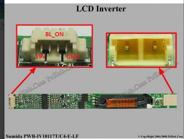

        So my inverter looks a little different, it's a push down plug with more than 4 pins, but when I had the 20v working on the board, I was getting 20v on one of the pins of the inverter. I did not check the output pins to the LCD
        Now, I am getting nominal/no voltage on the inverter pins OR on the output pins to the LCD.

          inverter input pins can be different. 1 - 2 pin 20v, 3 pin BL, 4 pin ON, 5 - 6 pin GND. if no voltage comes up, there may be a fuse near the lvds panel socket on the motherboard. check. in the picture, the parts with the E Code must be a fuse.
            All of the E's are showing no voltage but do have continuity. There may be a blown fuse I have not found yet.
            What would be causing these fuses to blow though?

              Some of the fuses may be resettable ones. Its never a good idea btw to use a wire instead of a fuse. Do you have a schematic for the board,whats the FRU part number,and the FRU part number for the inverter and the original panel. A new panel will not not work unless it has the correct IBM/Thinkpad EDID.
