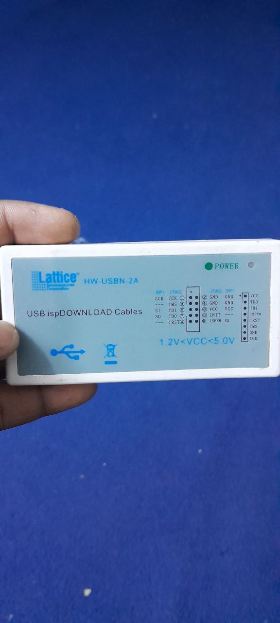

                      I think I messed up flashing gmux 820-2915 file with 820-2850 and I have no display at all pls does anyone have orignal gmux 820-2850 dump Jed I read it as bin but it won’t work the fans spin for 2 secs and turn off
                      Thanks again
                      • guruji
                        • Oct 2012
                        • 118
                        • India
                        #31
                        Re: Apple MacBook Pro 15 A1286 Demux IC Programming Mod Help.
                        is there a way to convert binary to JED.As I read the lattice device of 820-2850 and it saved as bin 152Kb but to write is needs a JED file 1.2mb.I use a sod3 programmer. Now I have my gpu sorted completely. The only issue is brightness control don't work and wakeup from sleep or lid doesn't work.
                        Please can some provide me another copy of 820-2850-a or I can upload my bin file to convert.
                        thanks all

                          See if this website helps (.bin to jedec conversion tools):
                          https://www.jammarcade.net/how-to-use-jedutil/
                            thanks all
                            with the right software it wil lsave original file as .jed and for 2915 it is 1.2mb.... so maybe u have saved it bad way.
                            the right app is lattice diamond programmer.

                                        Please I need software for Lattice programmer
                                        • mon2
                                          • Dec 2019
                                          • 13986
                                          #40
                                          Is the software not available from the Lattice website?
