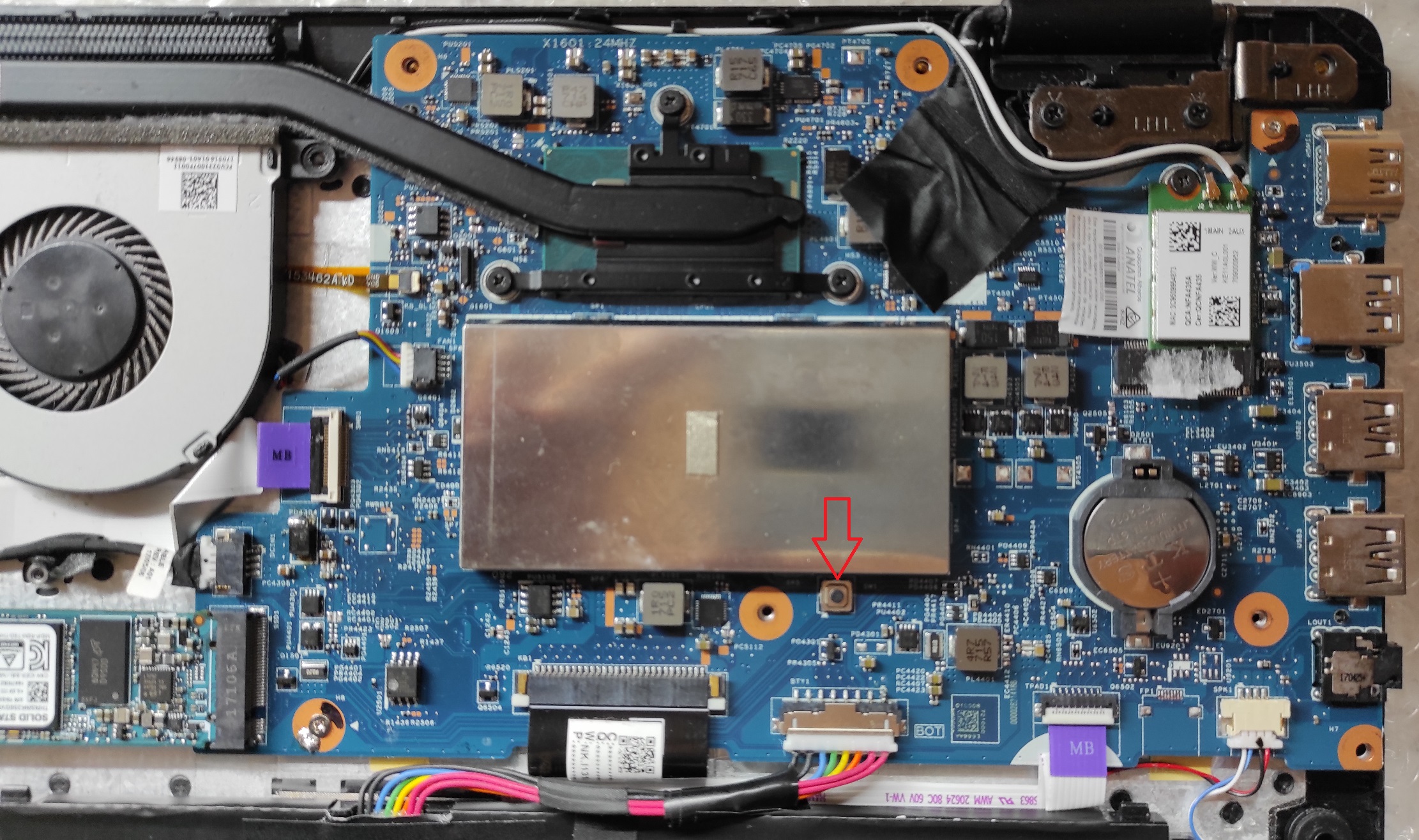

    This laptop is not charging the battery, I am aware of the battery tactile switch on the bottom of the motherboard.

        I have not been able to find any motherboard ID, there is zero voltage on the battery pins and I have not been able to locate the charging IC.
        There is a tactile switch on the bottom of the motherboard that needs to be pressed to allow the battery to charge - so it is difficult to measure anything battery related.

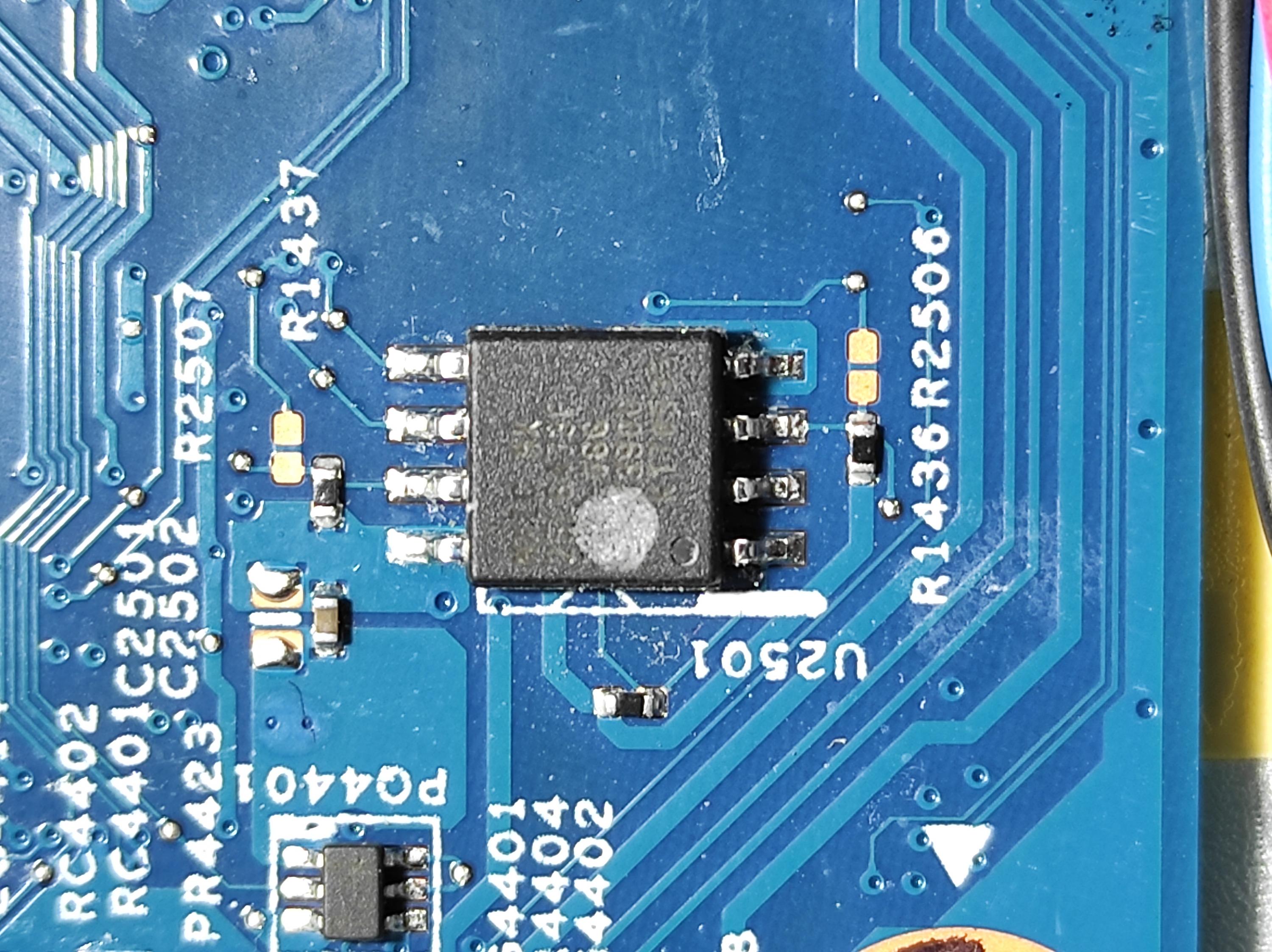

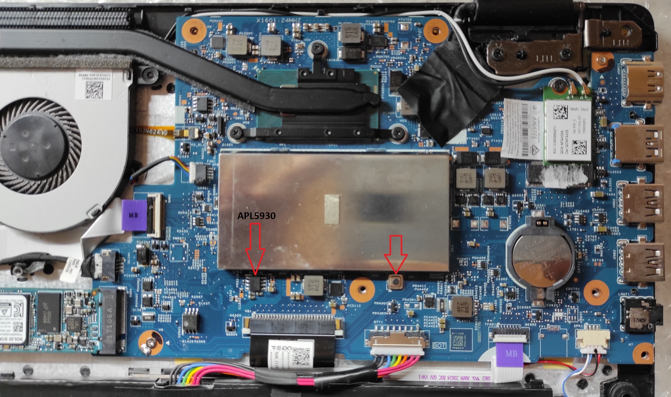

          Update: There is an APL5930 - shown on the attached image but there is zero voltage on any pin.

            Have you tested the switch to make sure its working ok.

              Thank you for the reply, yes the switch is working.
              If I hold down the switch and plug in the charger I get 12v on the battery connections for a few seconds then it goes to zero.

                            Re: Acer Spin 5 SP513-51 New battery not charging
                            Lol
                            Fine did not notice anyhow
                            I asked because you share ic which is a ldo regulator not a charging ic,
                            Take a big picture of motherboard and post here
                            Charging ic has markings starting with bq or bq24735 etc mostly

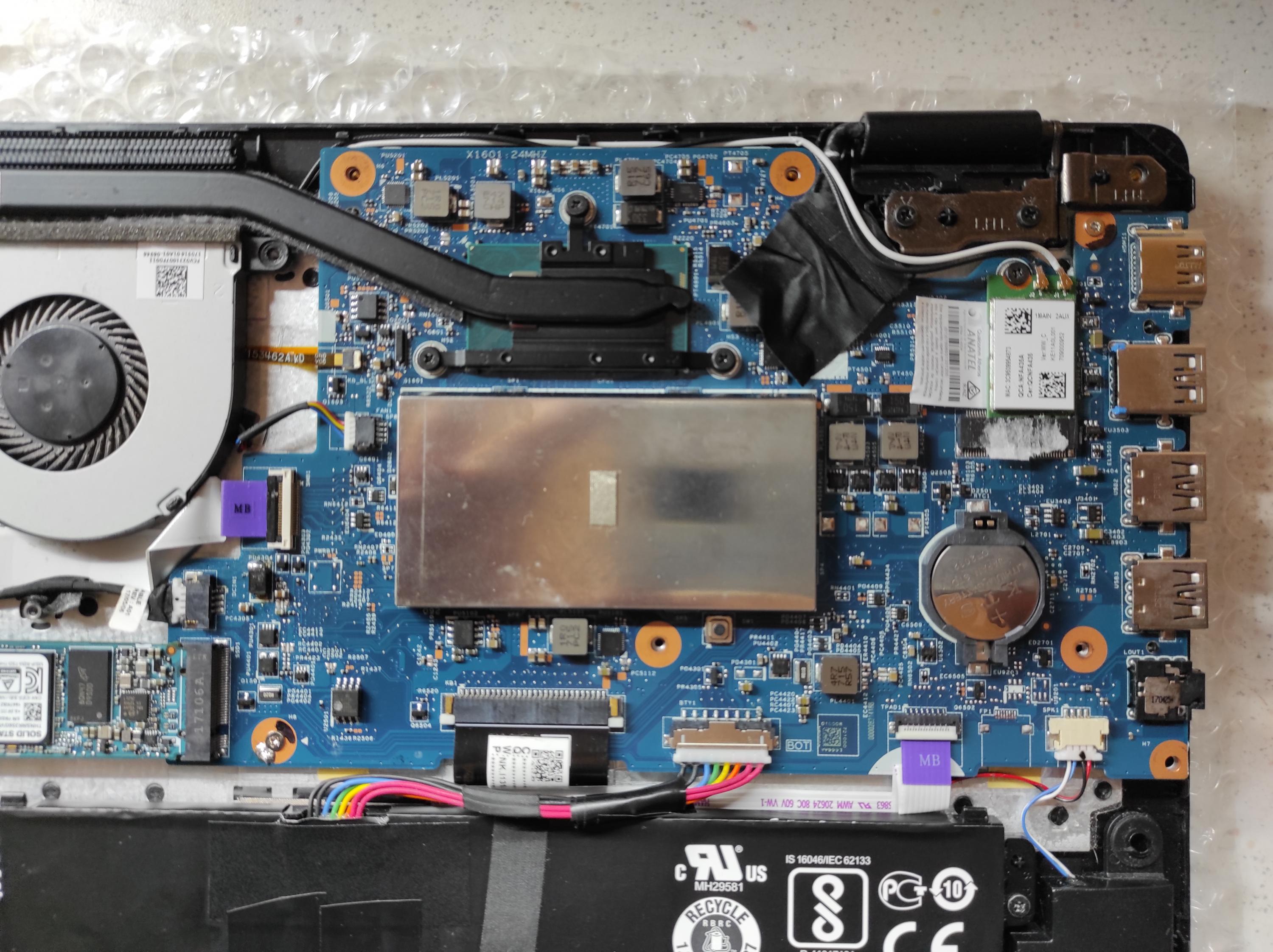

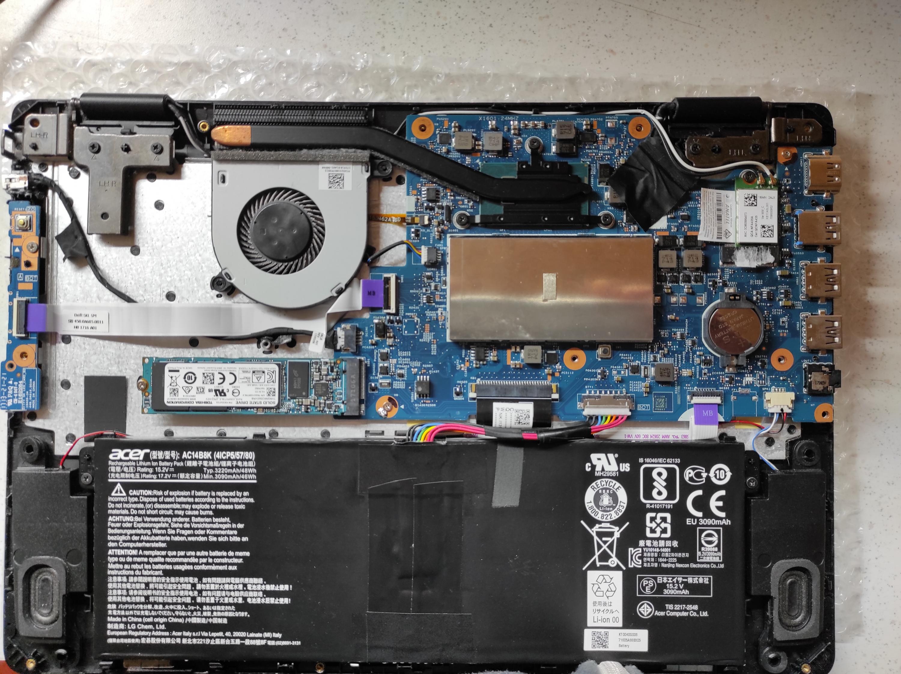

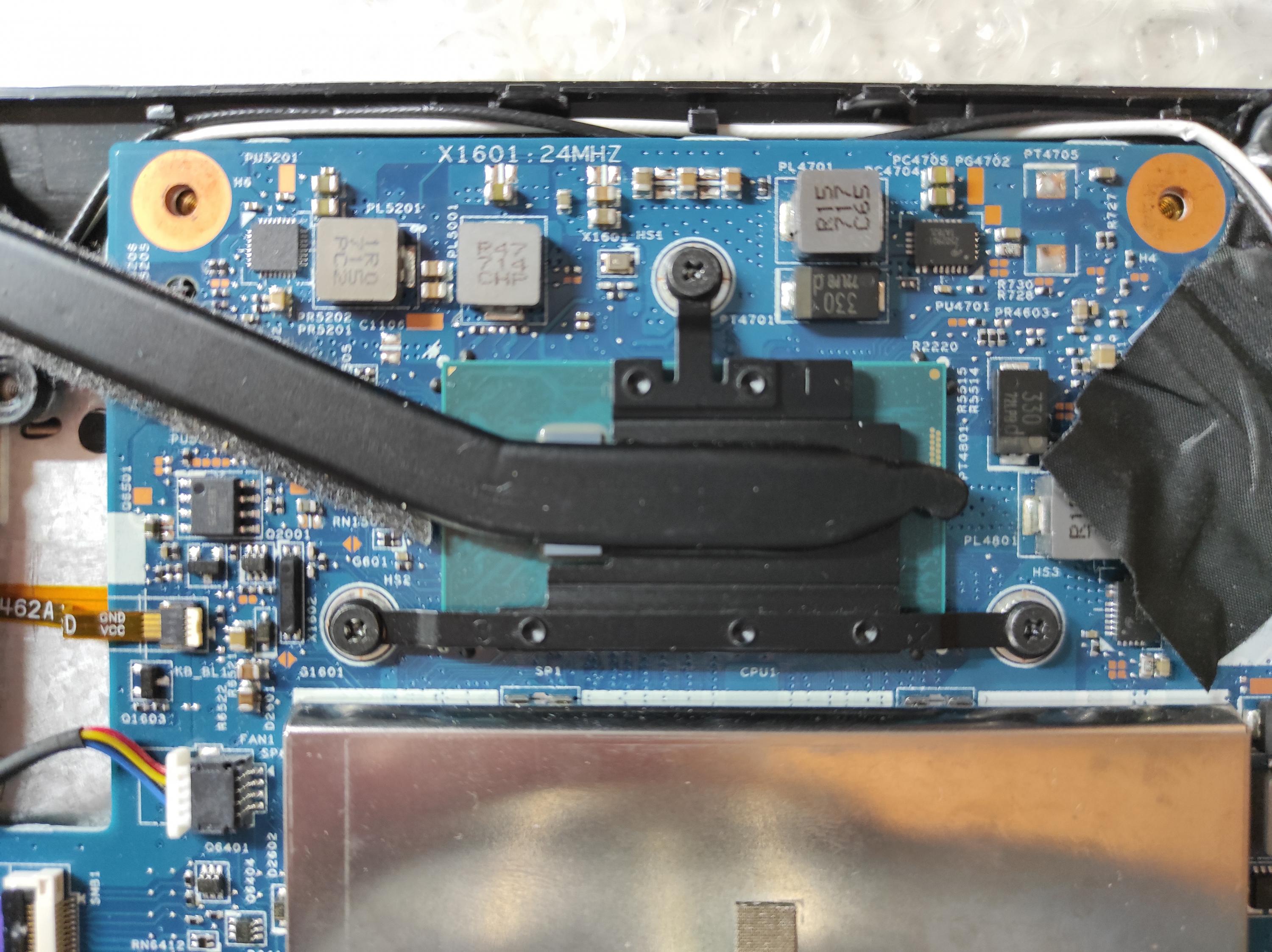

                              Thanks for your input, I have attached some images.
                              There is one chip that shows some damage but I cannot read the information on the top.
                              • stingerchamp
                                • Sep 2020
                                • 425
                                • Pakistan
                                Images are not clear
                                White dot mark on chip shows it is bios chip but it is working fine since laptop is functioning
                                Can you take picture of back or try to find number something like nbgkxxxx etc written in big size font
                                Can you verify it is drift skl motherboard
                                Is this your motherboard
                                https://www.ebay.com/itm/Acer-Spin-S...kAAOSwG8NeZqss
