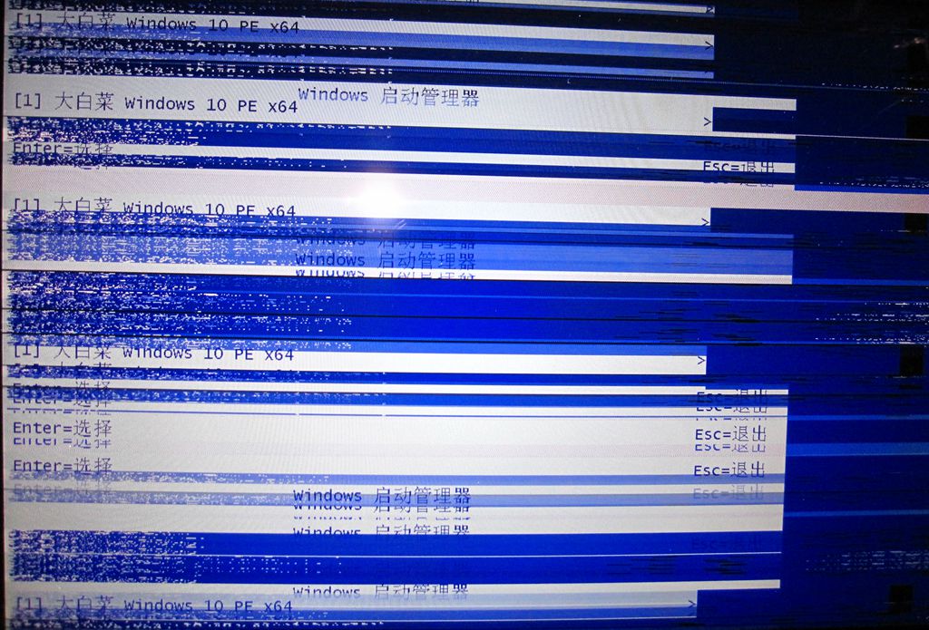

A Macbook Pro A1278 (820-3115-B).
  • Longmam
    • Nov 2014
    • 15
    A Macbook Pro A1278 (820-3115-B) displayed this. What problem is it.
    Thanks.
  • rookieme
    • Oct 2014
    • 396
    • Greece
    Re: A Macbook Pro A1278 (820-3115-B).
    do try ram swapping , a ram slot or ram module could be failing
    • piernov
      • Jan 2016
      • 4435
      • France
      Try removing RAM stick closest to keyboard.
