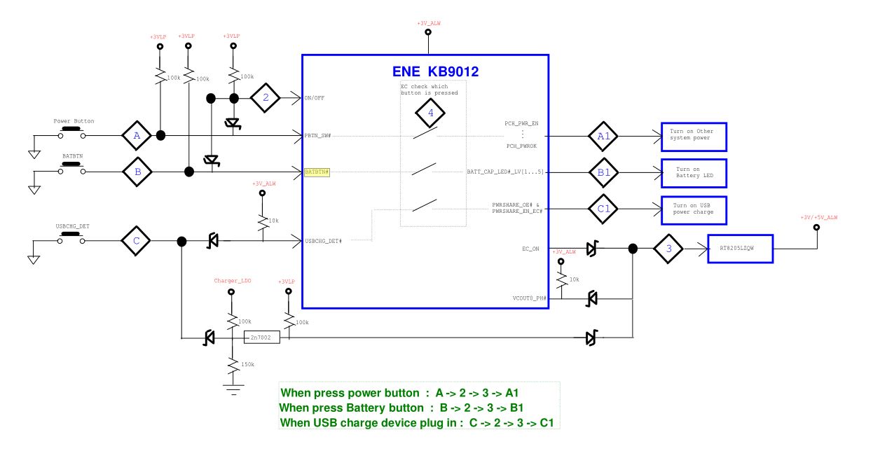

    I have a motherboard from a Dell XPS 9530 laying here which doesn't power on.
    As far as I can tell I only have 1,3xx v on the power button.
    No voltage at all on bios chip.
    Unfortunately I do not have a battery or the original charger cable, just a universal one.
    Can someone tell me how to start searching for the fault?
    Schematic can be found here:
    https://cdn.badcaps-static.com/pdfs/...4c3e981484.pdf
    Thanks in advance.

      Re: Dell XPS 15 9530 LA-9941P no power
      Start by taking voltage measurements on all large grey coils .

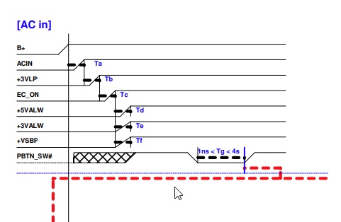

        I cannot detect any voltage on coils.
        /Edit: Charging coils has 13,50 volts
        According to power on diagram
        +3VLP is there, but not EC_ON.
        How to go on?
          Press SW2 in (BATBTN#),keep it pressed in and measure voltage on EC_ON
                Where is the measure point for EC_ON?
                I can say that I have measured the power button wrong, I have 3,3v and goes to 0 if I press it like it should.
                Thanks for your help!
                SW2 has also 3,3v and goes to 0v when pressed.
                  • 21869
                  You can measure EC_ON at RE340 if you can find it,do you have the boardview?, or if not measure PU300 pin pin 6 for 3VA_EN. Also measure the voltage on pins 7,8,18 and with no power attached check the 4 mosfets PQ300 - PQ303
                        This is a dell board with PS_ID, it may not want to power up if it doesnt identify the adapter through 1-wire protocol. This means the universal charger may not work.
                        EN1 should be 3.3v. You're saying it is 1.4v and also same on the power button. That's probably what you should be looking at.
                        Also note that in the internal structure of TPC51225C, the LDO outputs (pin 3 and 15) are always on. You may want to test these. If they aren't present, then the chip won't start and it's a solid indication it's dead.
                          I managed to get some original Dell PSU, all tests were done this one.
                          Power button has 3,3v, the original measure was wrong.
                          Pin 3 and 15 do have 3,3 and 5v, everything good.
                          Enable 2 has 3,3v, but sw2 doesn't switch high, why?
                          Why is en1 only 1,4v? It comes from ec, either ec is bad or pu300?
