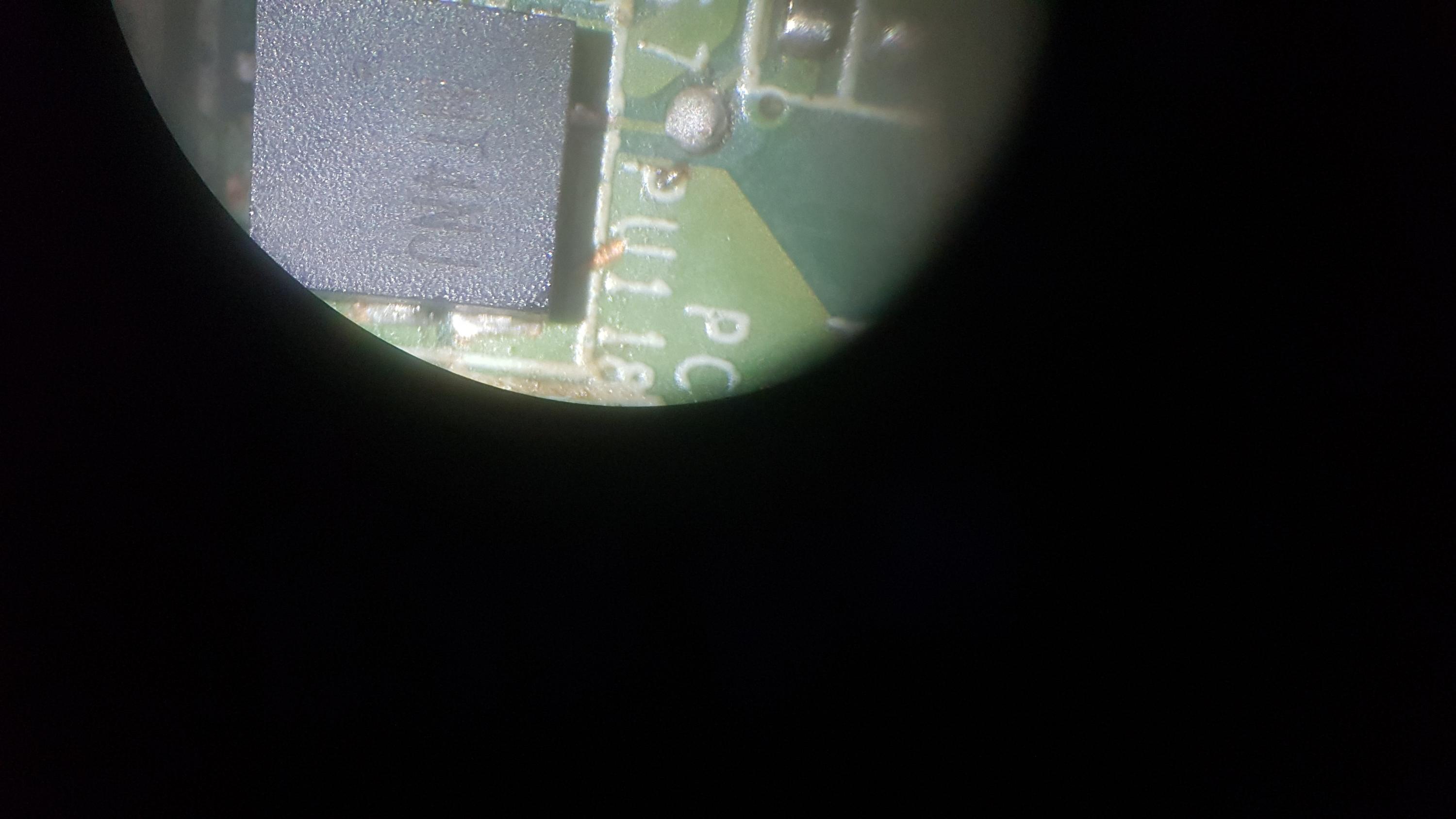

    i don't now what's happening with this motherboard its coming from another shop
    the part number of PU11 is MT4
    nj still was replaced befor

      Post good clear pictures of PU11 and 12 if you can,so that the part numbers can be clearly read .

        Re: day31amb6c0 no 3.3V
        Originally posted by SMDFlea
        Why would you have 5V on PL21 it should be 3.3V .Check the part number on PU11 ,it should be SY8208B ,not C
        ok.maybe this is the origin of this problem
          i cant its very small but its marking MT4NJ
                ok that marking code is a silergy SY8208CQNC
                (MTXYZ MT=Part number X=year, Y=week, Z= lot number)
                What is the part number on PU12
                  ok sir i'm not at the store i will post it after.tanks
                        HI SMDFlea i hope all is fin
                        i have ordered SY8208B 3.3 regulator, now 3.3v on coil pl21 is coming when i press power button but it shut down immediately,bios chip is 3.3v and all the coil have voltage.
                        pls help
