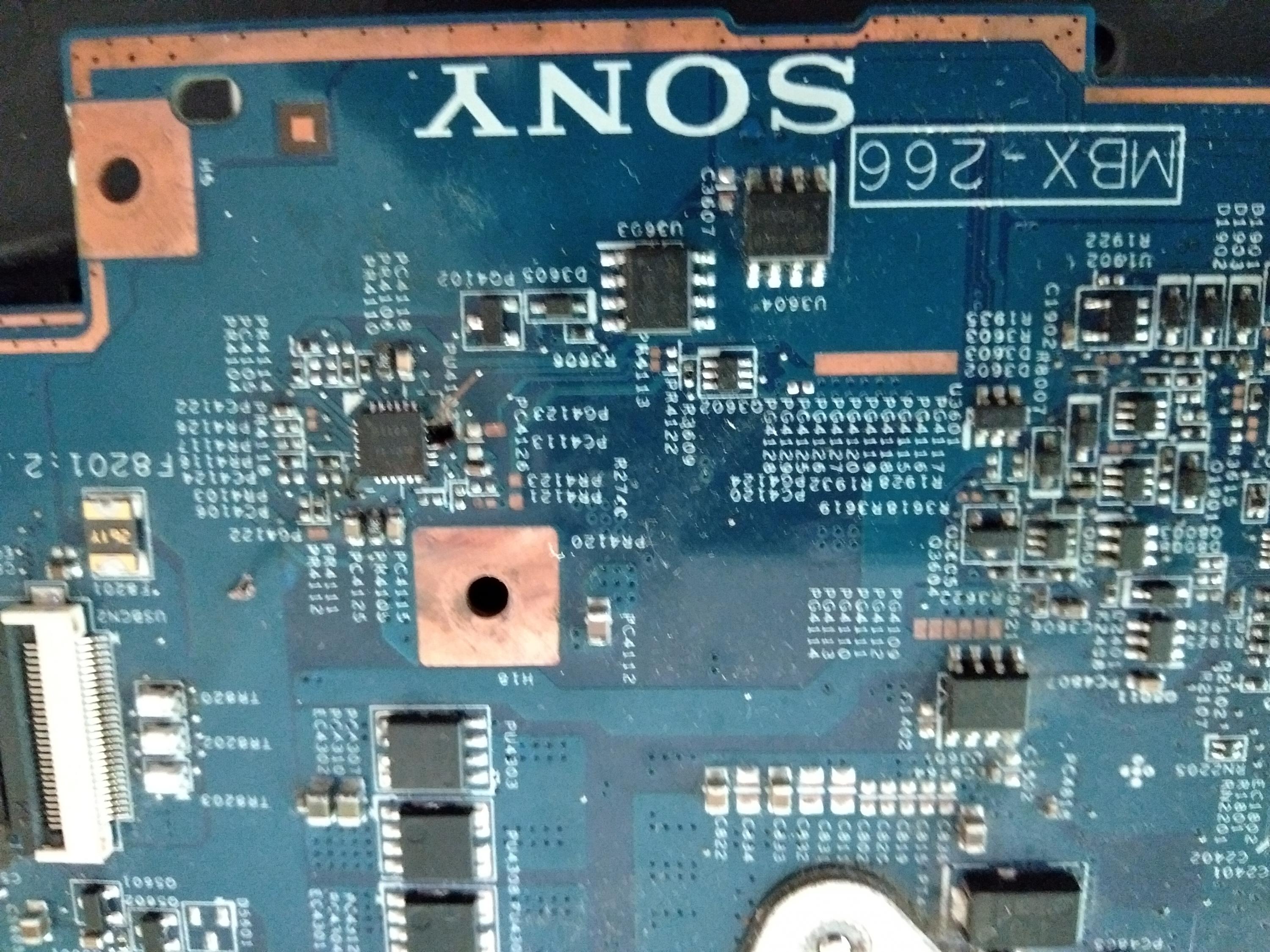

    is possible or not.

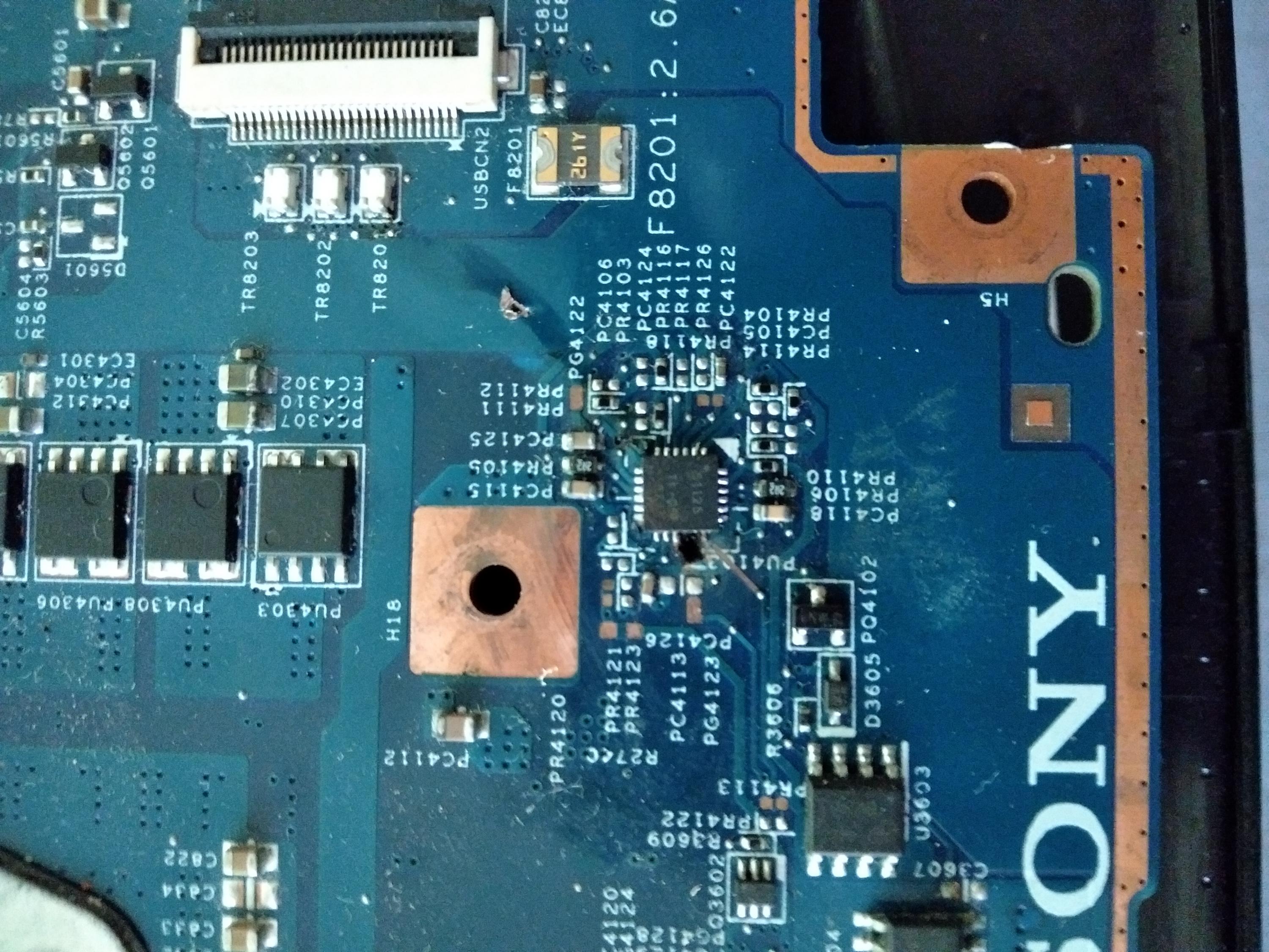

    Pu4103 ,RT8223M IC is burnt in such a way that a gap is created between motherboard sides like a hole lol
    PIN 16,17,18 of this ICs are damaged and on the other side there are capacitors closed by to the damaged pad.
    Need help or suggest is this board repairable or not if we replace IC
    and if yes then how?

    Find a BV, it'll be difficult to verify repairs if you dont have it. In principle yes, this is salvageable. You'll need a dremel, bakelite or another material to cover the hole that's sufficiently heat resistant, UV mask and lamp to create flat work surface, jumper wires to recover the traces, and all of this has to be done under microscope. I've seen people do it however.

          BV not available freely. Remove the IC and 4 mosfets connected to this IC and then check impedance on both the coils. If impedance is good , then it makes sense to try else you need to findout what else is wrong. If layer beneath the surface is damaged, may not be repairable.
