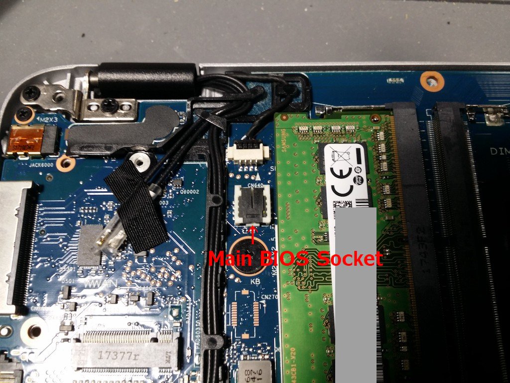

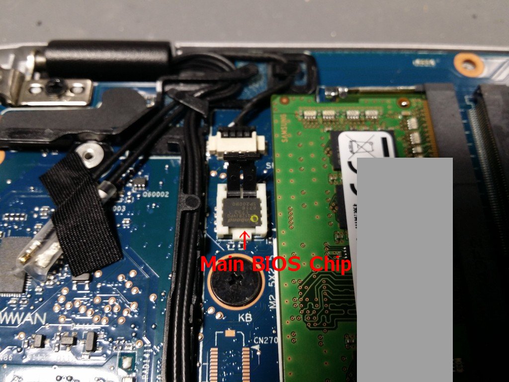

    Re: HP Elitebook 820 G3 - Locating BIOS Chips & Not Powering On
    Main BIOS chip is here.
    There are 2 types.
    1. Socket Type. (attached images)
    2. Soldered.
    Chip is WSON8 both types. Not SOIC8.

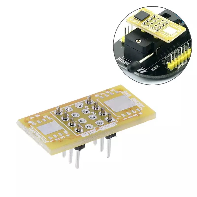

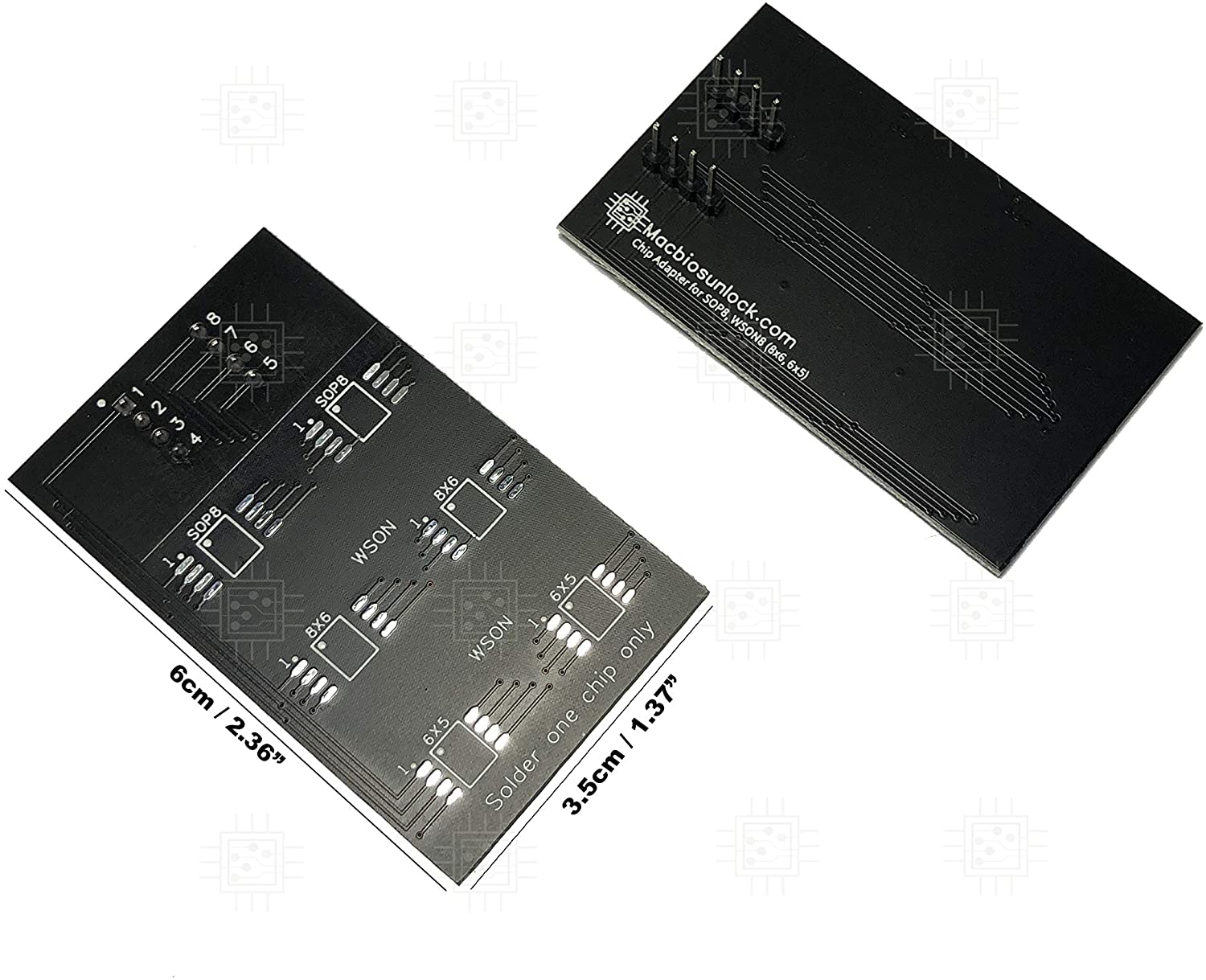

          You need to des older it and solder it on wson pcb. Never use the clip always desolder the chip. Clip gives errors. That is mine advise
          Thanks for the advice. Just had a check and both of mine are soldered rather than in a socket. I have a PCB they should fit I think.
          Do you think it is a good idea for me to try desoldering if I've never done it before? Or am I likely to damage the chip or board?
            Test it first on scrapboard for soldering skills. If that goes well you can try on your own board. That is my advise.
            Good luck
