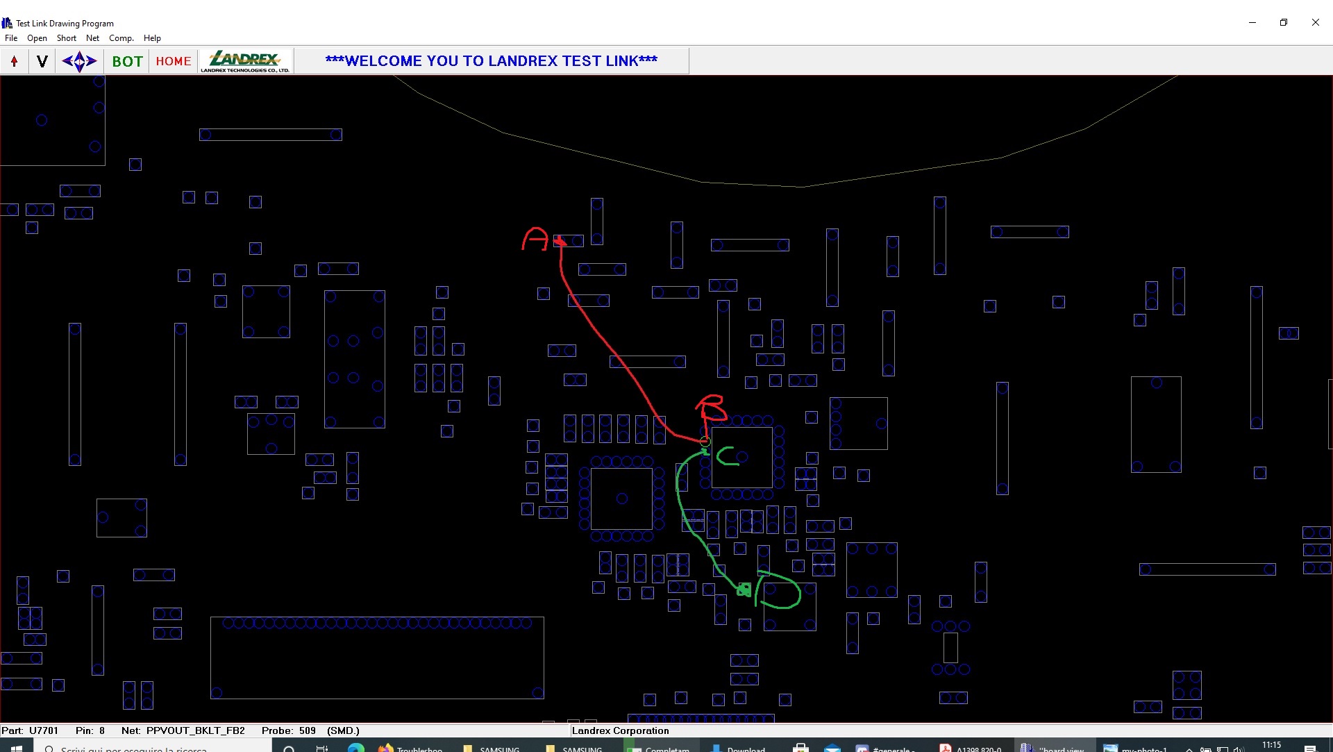

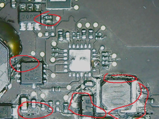

          Re: 820-00138-A Backlight IC
          I dont have a camera here but didn't forget the USB-Microscope which is anything else than decent
          Here is a picture but not really good one. There you see the small 'hole' at pins 8-9.
          Also there are connections in the board; 2 contacts and I think that they where connected to the ripped/burned pads so it should be possible to jumper from there(I hope )
          Here's the picture and I also figured out that I have the right driver IC which should be called: 'LP8548B1SQ_-4'
          • dellxps15
            • Feb 2014
            • 1598
            • italy
            i cant say so much from that picture, but check red circled zone... why that strange color? was water damage corrotion?
            after clean all the zone carefully expecially those 2 pins check for connection from :
            pin 8 probe is 509
            pin 9 probe is 88
            on boardview do short and probe the value. ull see one spot near u7701
            check if that pin is still alive or u need a jumper wire.
            before put a new chip check if any shorted component.
            that ic boost voltage from 12.5 to 55 volt

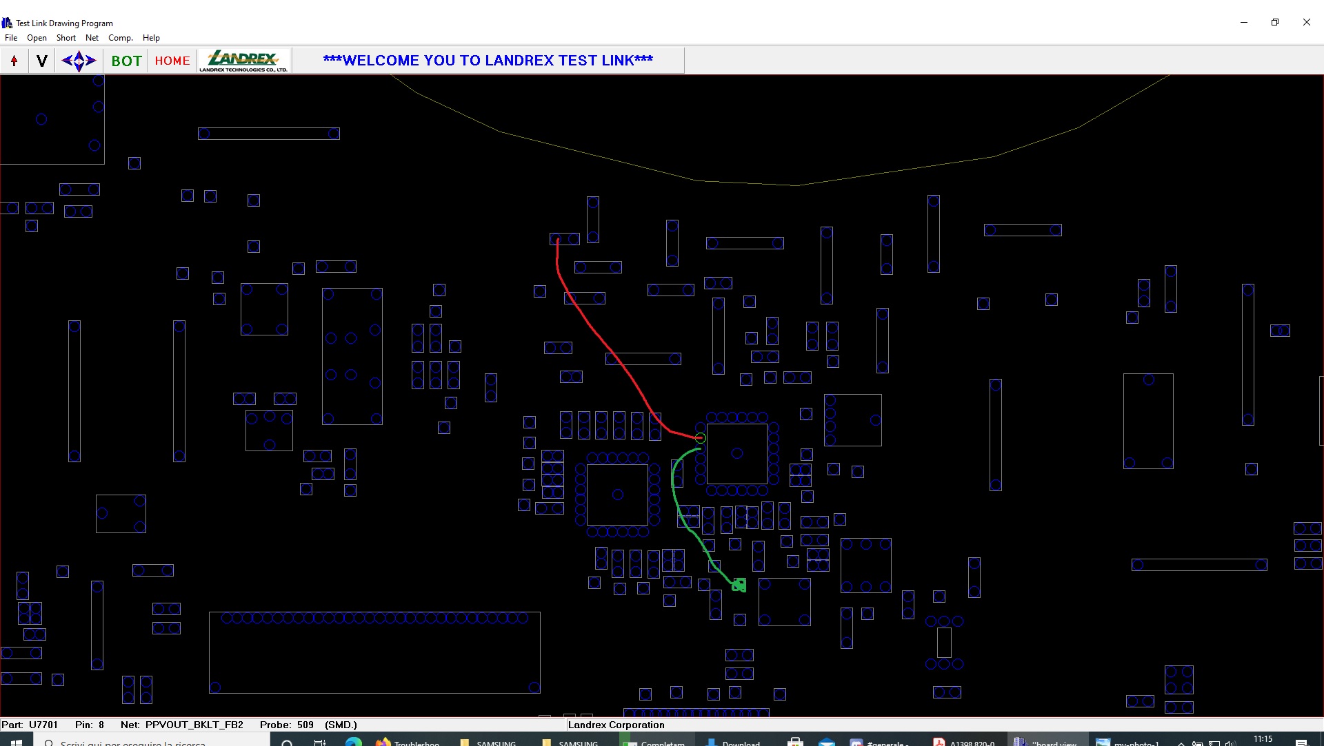

                  sry had to assemble some iPhones so I couldn't answer on Saturday.
                  The 2 Pins aren't shorted it looks only because of the bad picture quality. If i measure them the DMM shows OL.
                  I measured up the red line from your picture but somehow there is only continuous at the other side of that cap than your picture shows.
                  Here's a picture with diode mode readings from that pin '8' and where I think the line goes. I do a next one for pin9.
                  • lctrbrt
                    • Mar 2020
                    • 25
                    Here's the other picture with line from pin 9
                    • dellxps15
                      • Feb 2014
                      • 1598
                      • italy
                      you are making some confusion. for short u have to probe in diode mode: black on gnd ( metal of usb or any other gnd spot on the board) and red on pin 8 and read the value. then gnd and pin 9 and read the value.
                      next if no short ( value of diode mode over 010. [001 002 is short])
                      probe in diode mode black on A and red to B(pin8).. if 001 or 002 then pin 8 still working
                      probe in diode mode black on C (pin 9) and red on D if 001 002 then pin 9 is working.
                      that's first step
                      next step is probe all u7701 pins in diode black on gnd and red on each pin reading value and looking for short. read each pin value and check if shorted or not ( if short check if its not gnd on schematic.
                      hope that help

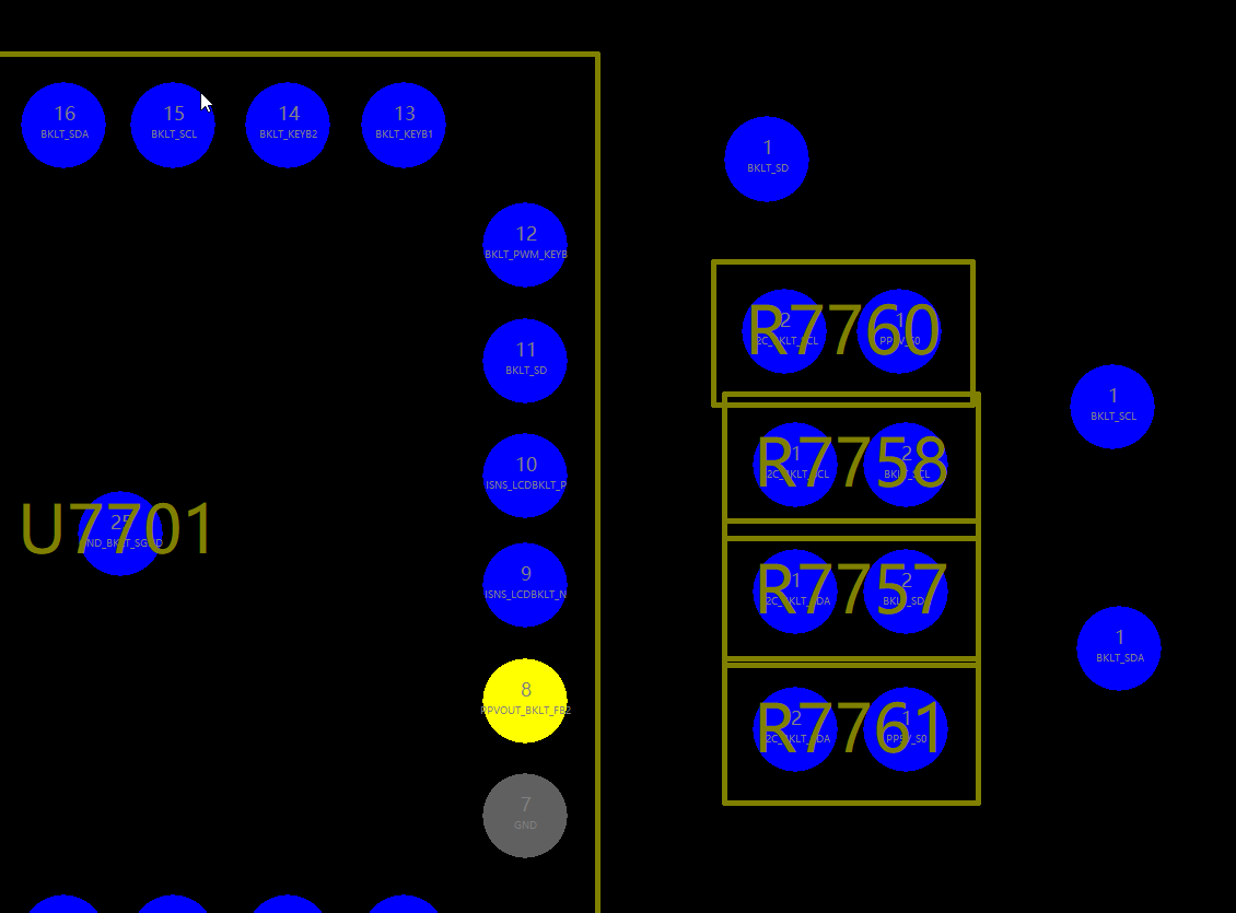

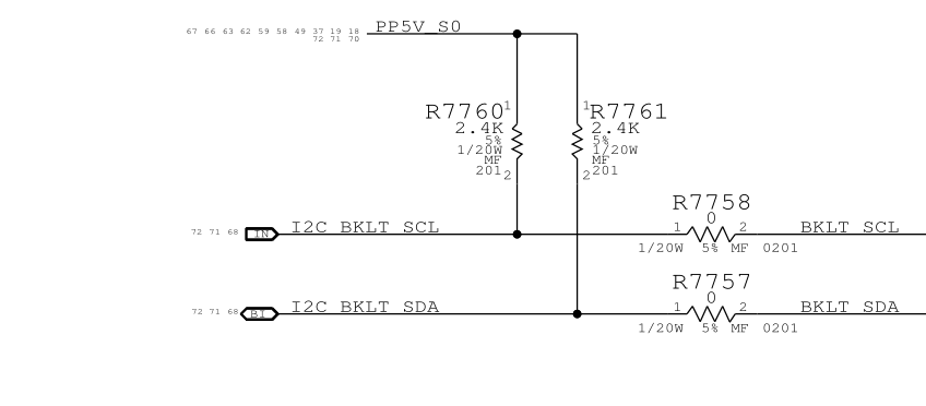

                                      SIR , I WANT TO KNOW THIS U7701 IC PIN - 7/8/9/10/11/12 SIDE 4 RESISTOR PRESENT , PLEASE GIVE ME THIS RESISTOR VALUE THE 4 RESISTOR . PLEASE HELP ME SIR.
                                      • mon2
                                        • Dec 2019
                                        • 14661
                                        R7757 = 0 ohms 5% 0201 size
                                        R7758 = 0 ohms 5% 0201 size
                                        R7760 = 2k4 5% 0201 size
                                        R7761 = 2k4 5% 0201 size
