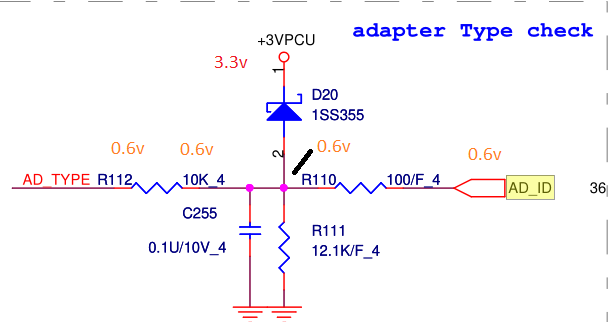

              Re: HP G4 DA0R24MB6G0 totally dead, no leds
              Yes, I have two original chargers, here the values:
              AD_ID in center pin of charger disconnected = 14v
              AD_ID in DC JACK ( connected) 5v ??
              AD_ID in:
              R110 0.6v both sides
              R112 0.6v both sides
              D20 3.3v side 1, 0.6v side 2
              I guess there is something bad in that circuit, but I don't know what...

                  the AD_ID pin (center pin) will be between 0 and 3V is it 0.60V if so with a 65W adapter i think its fine!
