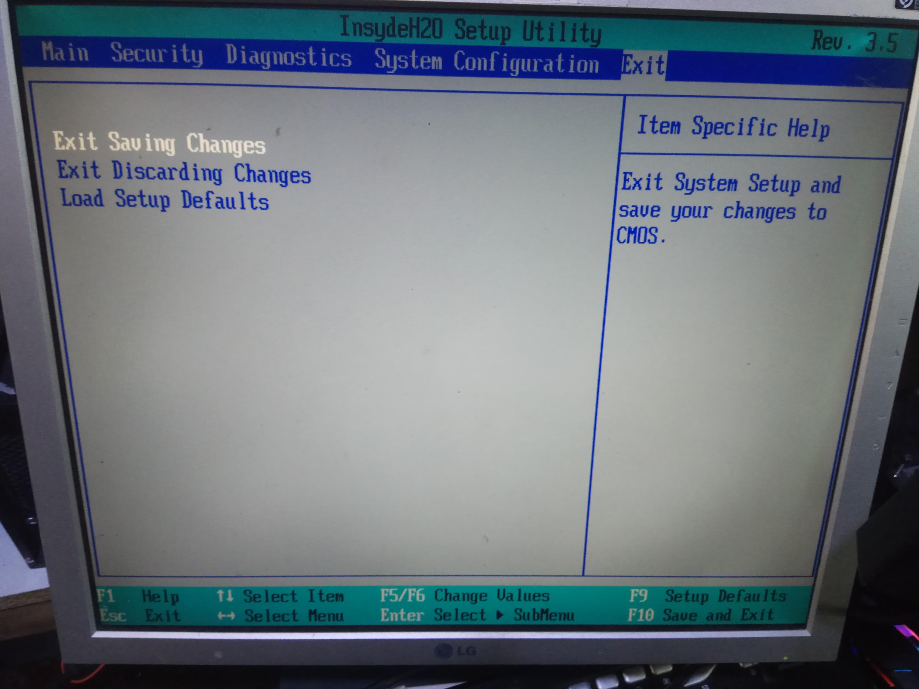

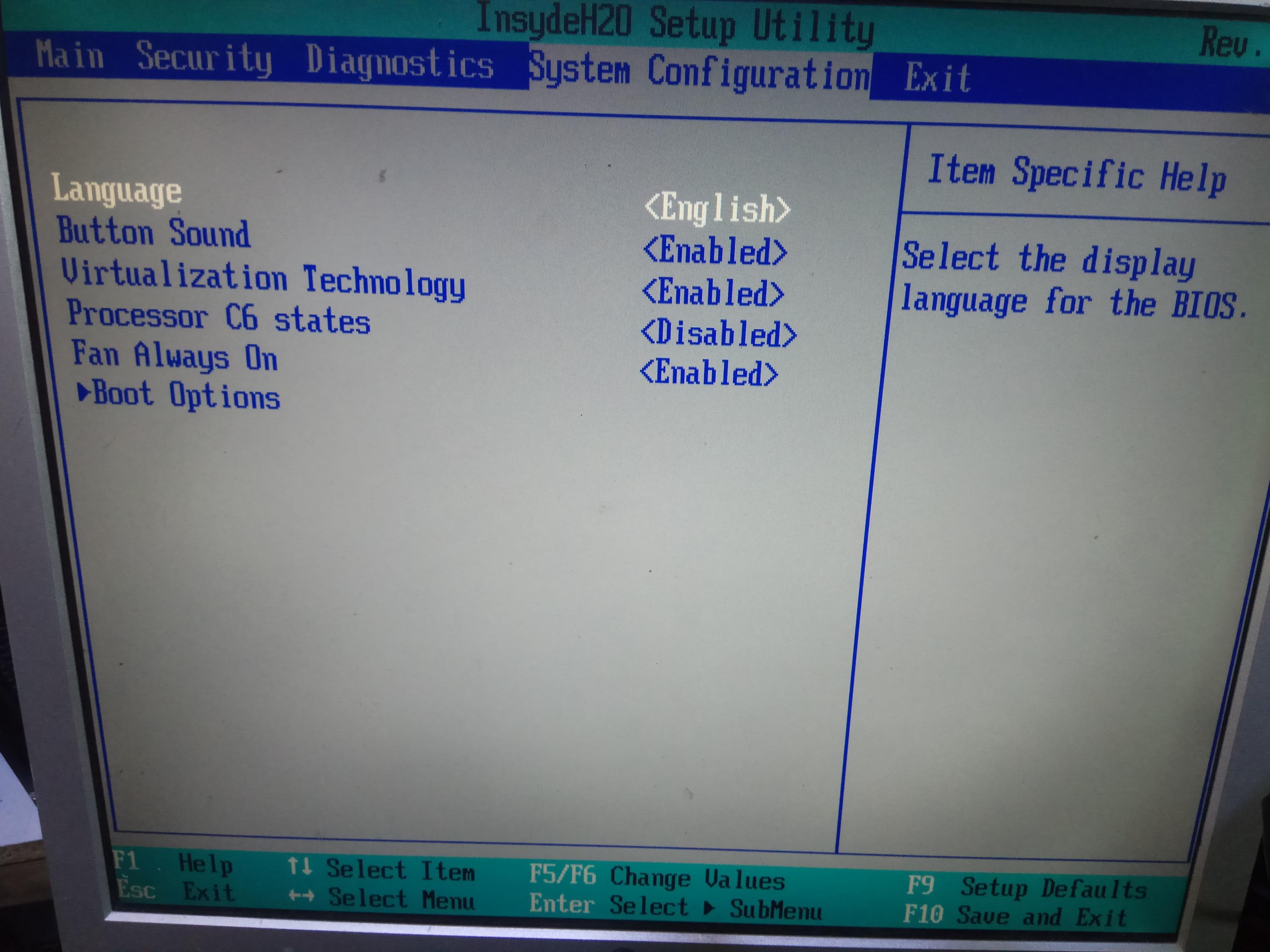

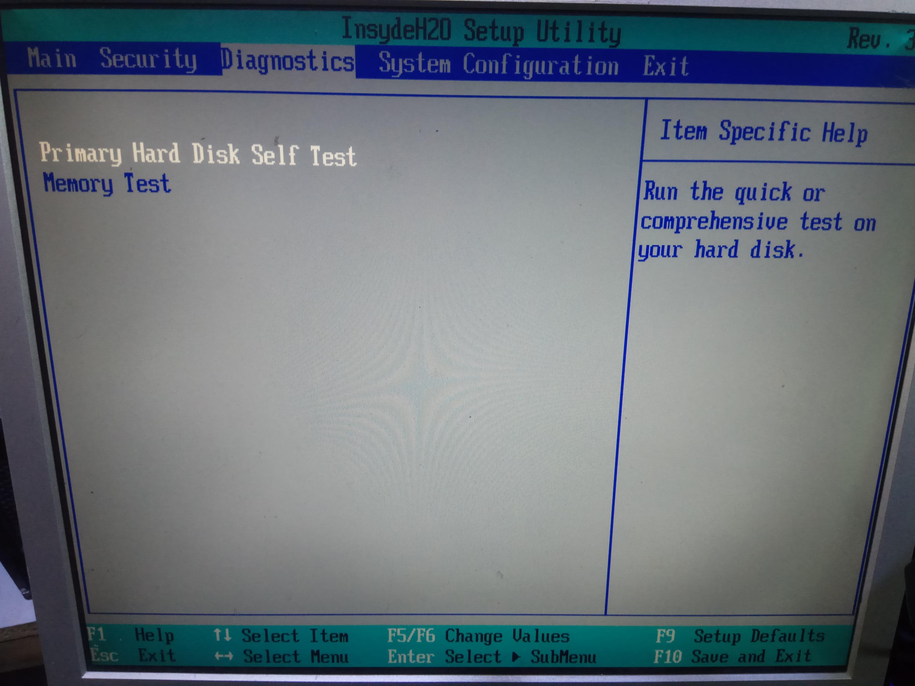

    Hello.
    I have an HP Pavilion dv5-1160ev. I opened it for cleaning. All good until It opens normally in the BIOS, but it does not boot either disk or dvd or external media ... I saw a black screen after bios ... What's going on?I change cmos battery, load bios primary defaults. Thanks!

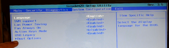

    If you loaded BIOS defaults, I would check boot order or SATA mode: IDE / AHCI / Compatible first
    • olorin
      • Sep 2013
      • 82
      • Greece
      Re: HP Pavilion dv5-1160ev
      Hi.My laptop does not have this option.

          See if it's a pb of boot mode : legacy or UEFI .
          • olorin
            • Sep 2013
            • 82
            • Greece
            does not have such an option...

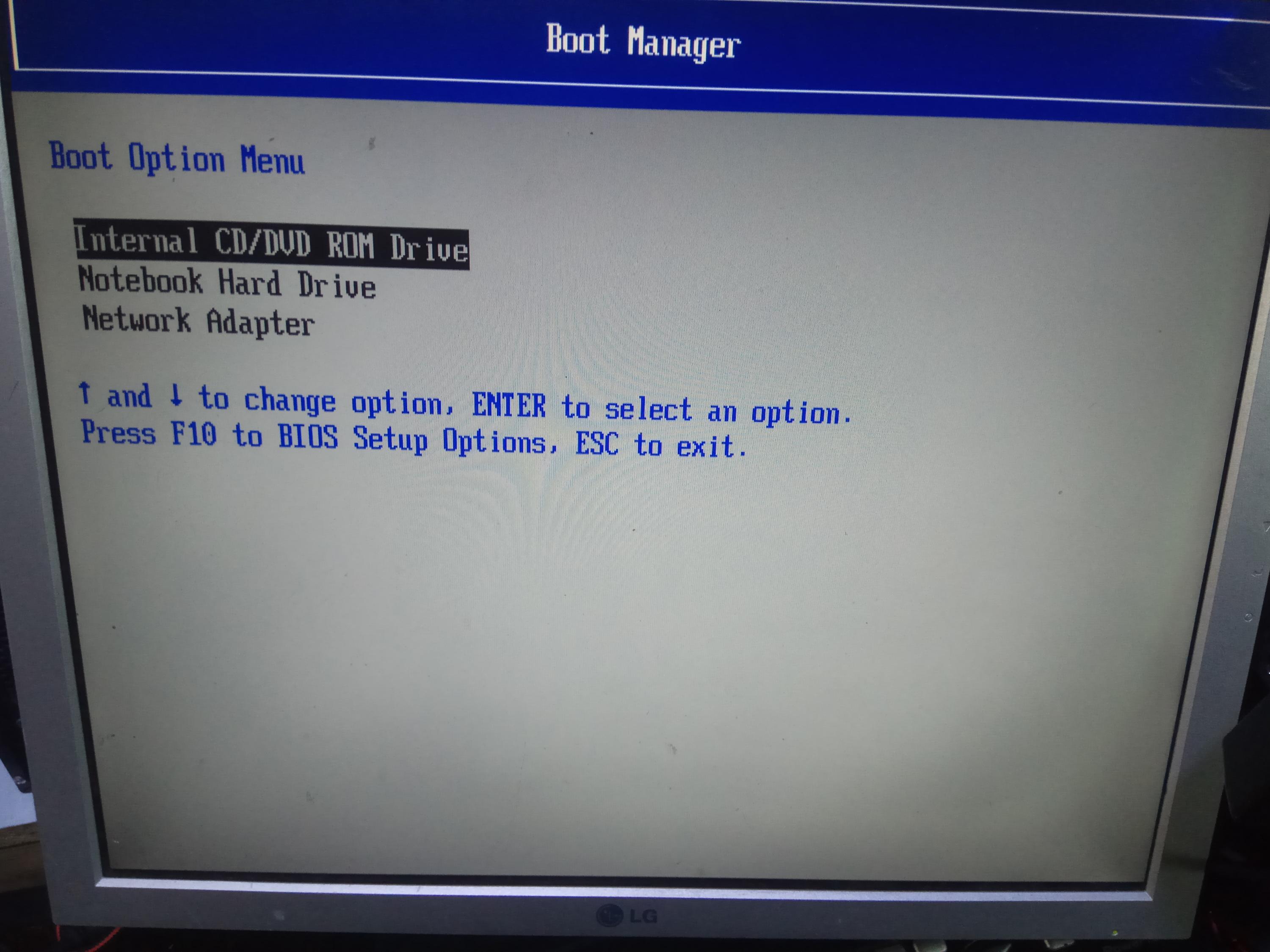

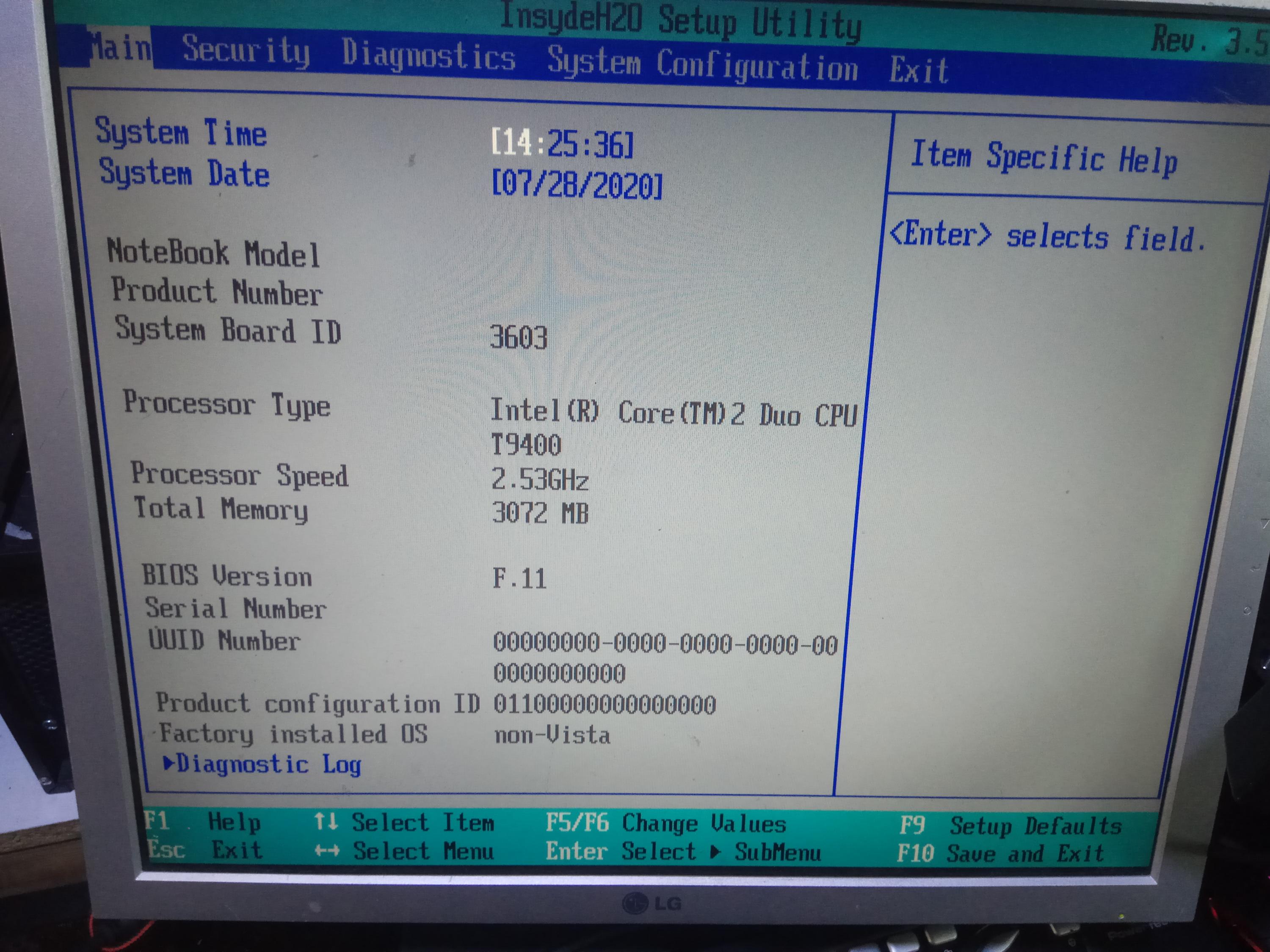

                Hello. Can you describe situation more specific? Before cleaning all was allright? Laptop booted from HDD? Is HDD visible in BIOS? Can you upload photo of your BIOS settings?
                • olorin
                  • Sep 2013
                  • 82
                  • Greece
                  Before cleaning all was perfect.
                  Hdd is visible in bios.
                  • krawat274
                    • Jun 2020
                    • 53
                    • Poland

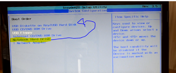

                    Try to power on laptop and press F9 or F12 to go inside boot menu. Then, select Hard Drive as boot source and press enter. If you can't get inside boot menu, try to change boot order in BIOS (first place as Hard Drvie, second CD/DVD etc.).
                    • olorin
                      • Sep 2013
                      • 82
                      • Greece
                      I try this but nothing happened

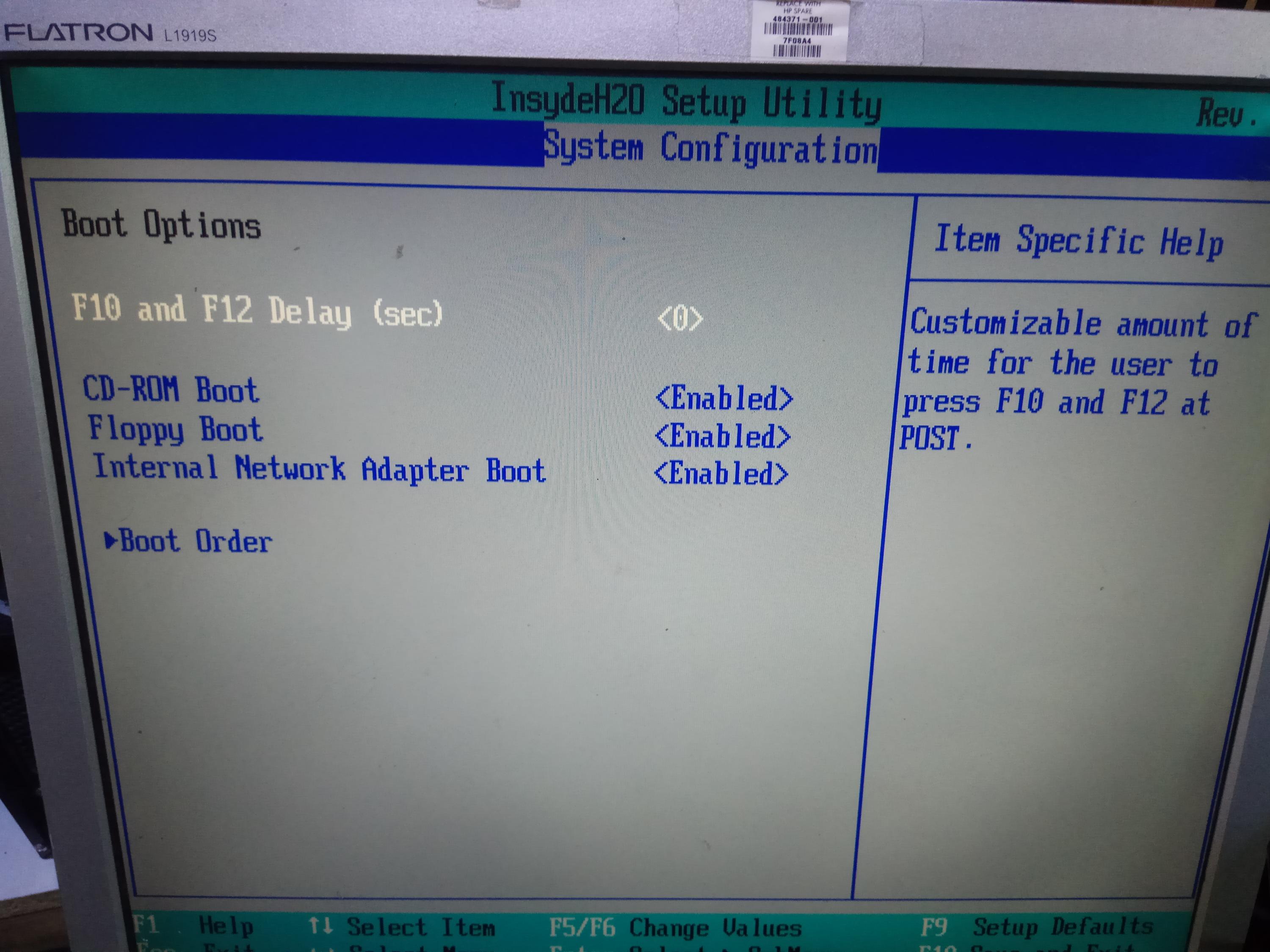

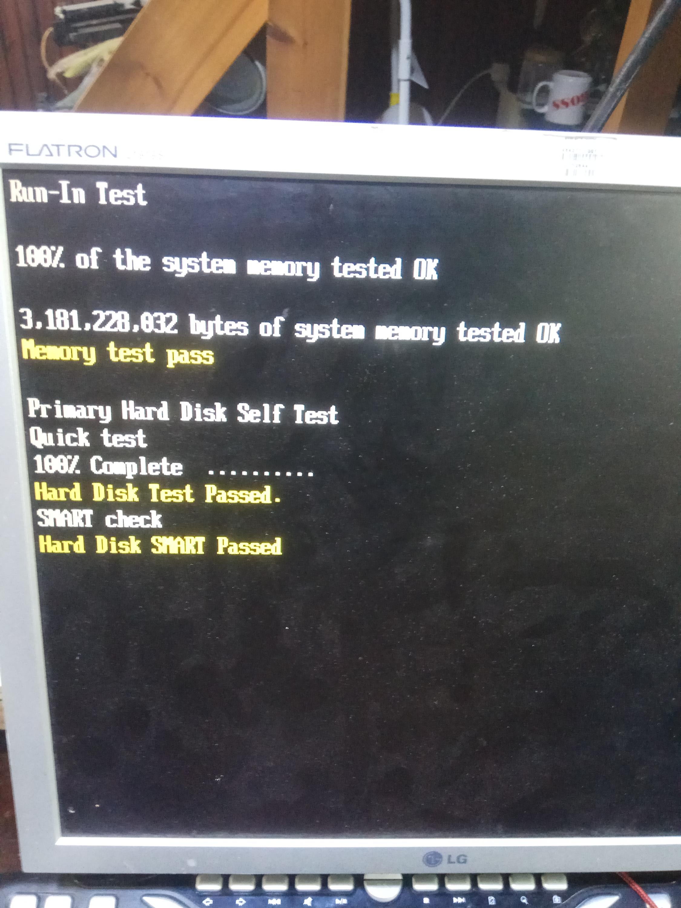

                      • Shrimp_Green
                        • Sep 2018
                        • 8
                        • Brasil
                        Hello, greeting from Brazil.
                        The black screen is the memory test. This happens when the system does not boot from Hard Disk.
                        Try putting the HD as First Boot:
                        Enter Setup:
                        System Configuration>
                        Boot options>
                        Boot Order>
                        Leave the HD as first.

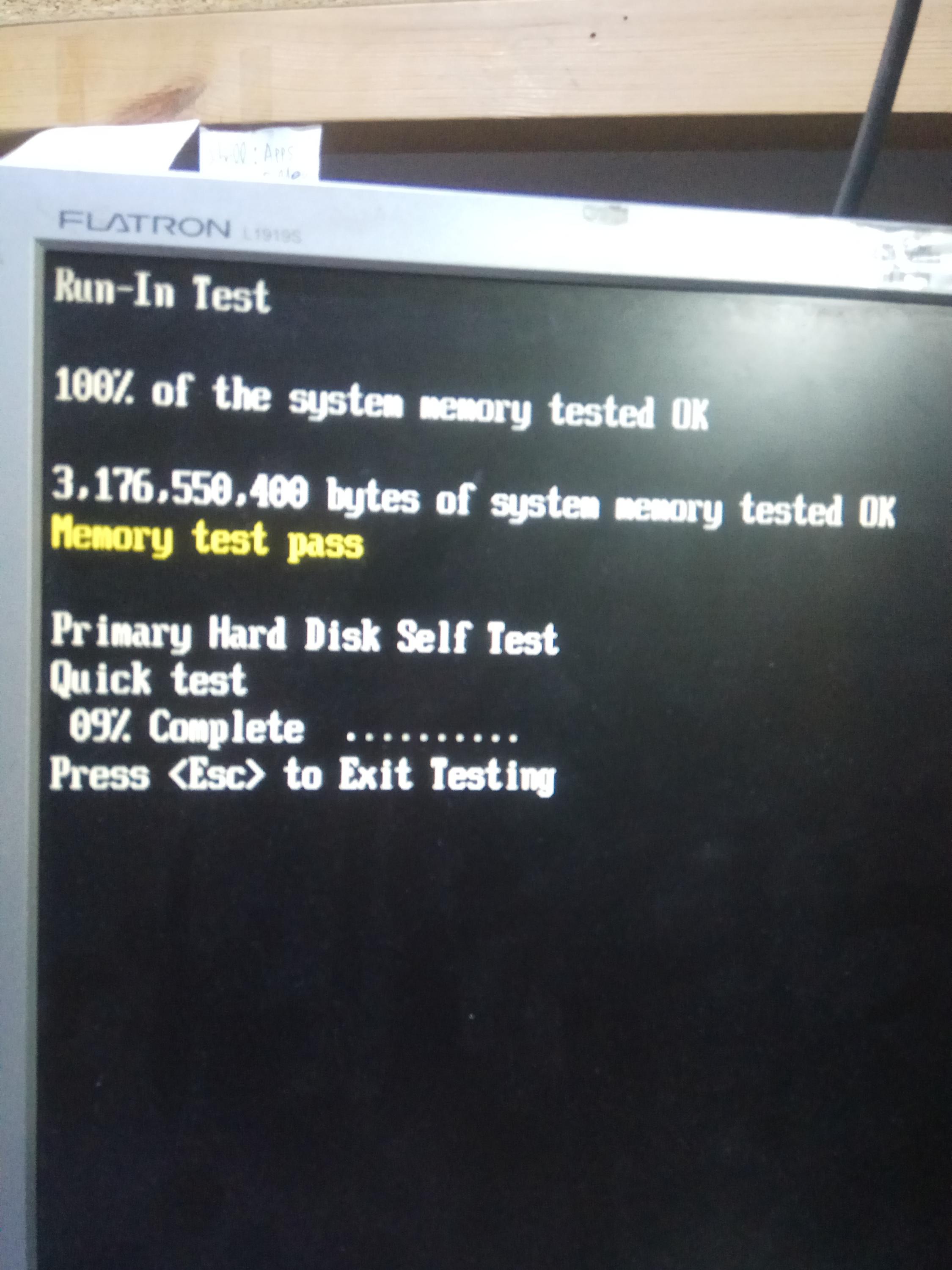

                        • olorin
                          • Sep 2013
                          • 82
                          • Greece
                          See video who shows the problem.
                          https://gofile.io/d/R66Dem...
                          This happen with any boot device ,like hdd,cd or flash drive
                              Originally posted by Shrimp_Green
                              Ola, saudação do Brasil.
                              Enter Setup:
                              Boot options>
                              Boot Order>
                              I've done it.
                              no change

                                Is windows 7...I think hdd no have problem because before cleaning work's perfect...Now laptop appears black screen from any boot device like hdd ,dvd,usb flash drive,external dvd....
                                I try to found BIOS for this laptop but hp didn't have it in her site....
