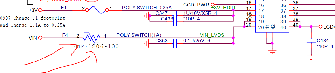

    Hello guys.
    I have a sony Vaio that has a backlight issue , i found a fuse ( polyswitch 1A / 32V ) on the motherboard side being blown , so i used a wire to jumper to see if it would work and it did.
    So my question now :
    Do i need exact replacement for this fuse or can i use another normal fuse or even resistor ( low ohms like 5 or something) ?
    LOoking forward to your answers. Cheerz

    Re: Laptop Blown fuse replacement
    for me i always use the specified value to protect the unit...my opinion..
      use the right part - it's there for a reason
        Ye i'll get the right value but what about using a normal fuse insteaf of polyswitch
          A polyswitch is a resettable fuse which means once blown it will take a few days to reset if the problem that caused this is fixed and a normal fuse just blows and i have to replace it again.
          So if i'm missing something why i shouldn't use a normal fuse or even a current sensing resistor please tell me
