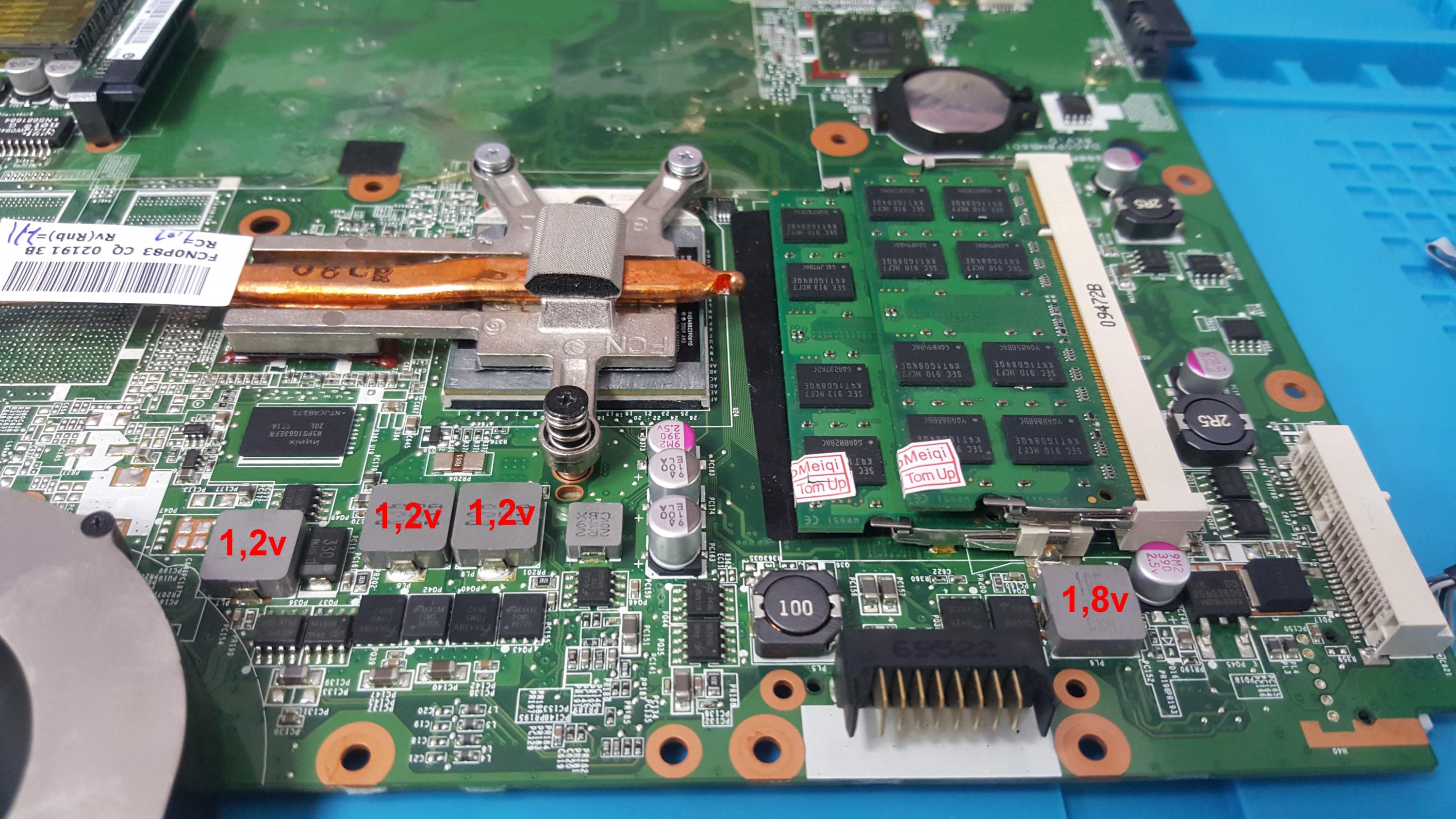

    Hello, I have this laptop and it turns on, fan spinning but I have no display or backlight on the screen. I connected it to an external monitor through HDMI but no display. Removed one Ram, reseated the other and swapped them, nothing changed. Motherboard is DA00P8MB6D1 REV: D
    Can anyone help me repair it?

        Did that but nothing changed. I have attached an image of the motherboard with the voltages.
              can you confirm PL10 PL5 voltage are missing ?

                            Re: Compaq Presario CQ61 - Fan spins, no display
                            Originally posted by techtiger
                            can you confirm pl10 pl5 voltage are missing ?
                            pl10 = 1v
                            pl5 = 0.5v

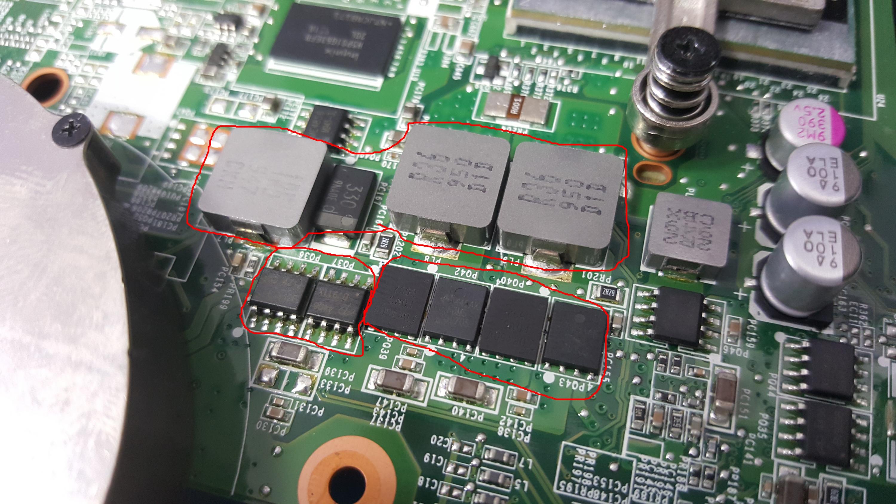

                              Originally posted by Duranitron
                              look for something that over heats..specially on the processor or gpu area then measure the gpu or processor voltage and post it here..
                              The PL7, PL8, PL9, PQ39, PQ40, PQ42, PQ43 are really hot but PQ36 and PQ37 (SOP-8) are too hot to touch. Can't even touch it for more than 2 seconds.
                              I have voltages on the CPU area 1.8V.
                              In the GPU area I have 1.8V, 1V. I didn't have the time to check in detail.
