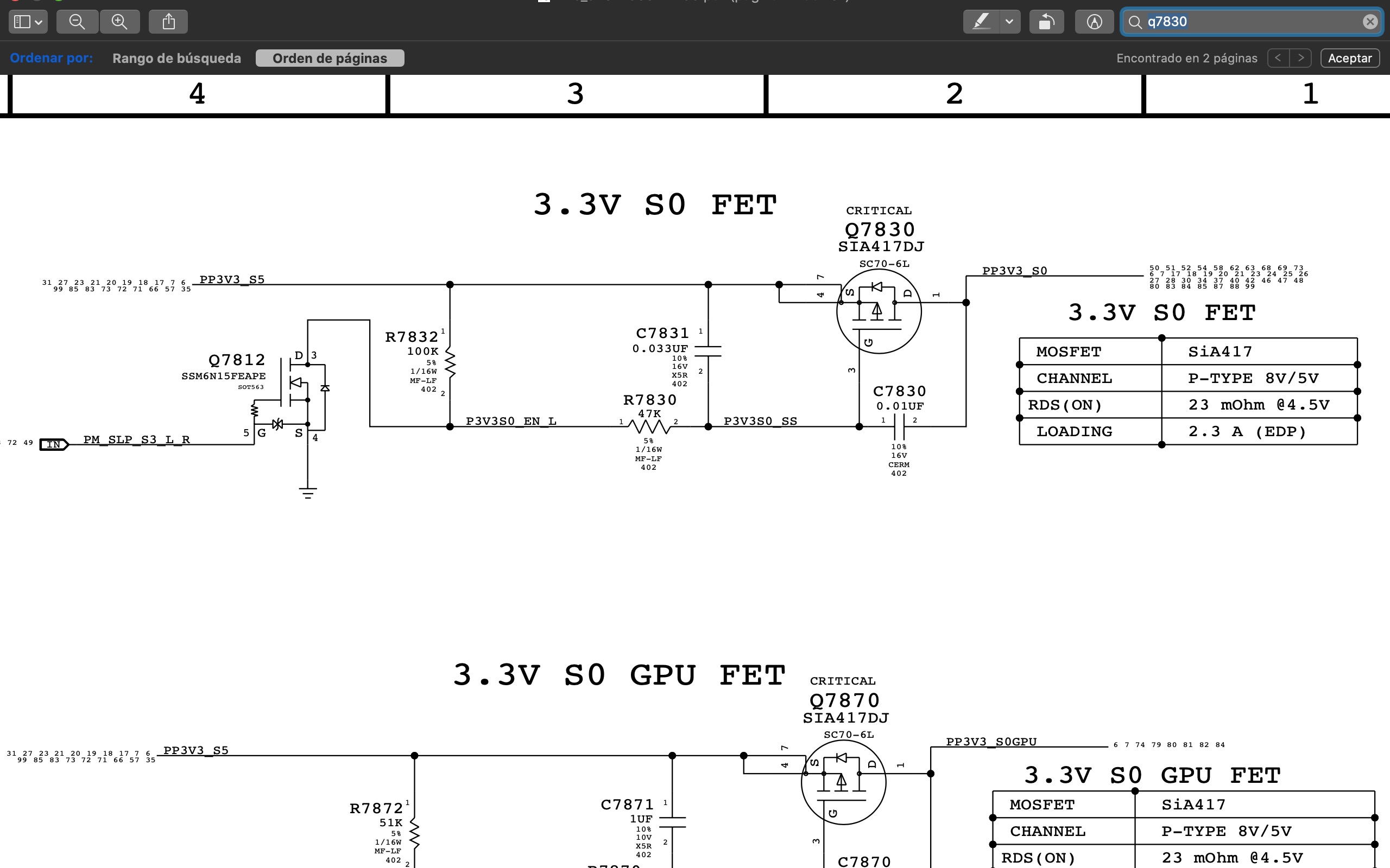

    (820-2850) PP3V3_S0 Issue
    Hi, im stucked in a 2850:
    PPBUS OK
    PP3v3_S5 OK
    PP5V_S5 OK
    PP3V3_S3 OK
    PP5V_S3 NOT OK (Enable signal Pulsing)
    PM_SLP_S4_L Pulsing
    PM_SLP_S3_L Pulsing
    ALL RTC Signal presents
    When remove Q7830 (3.3V S0 FET) or Q7812 (Enable signal for Q7830) (see attached image) I have full speed fan spin and PM_SLP_S4_L and PM_SLP_S3_L are stable , I tried change these two components with same result, so the problem I think is in the PP3V3_S0, not shorted rail, any idea how to proceed in this case?
    Thanks.

    Re: (820-2850) PP3V3_S0 Issue
    can you tell us the original problem so that we can relate.. and what did you done so far..
    Never stop LEARNING because life never stops TEACHING!
    • iywdde
      • Aug 2017
      • 7
      • spn
      Thanks for your answer, it does not seem damage by liquid, nothing worked, tested all the RTC rails, luckily lifting components related to PM_SLP_S4_L I discovered that the problem seems to be in PP3V3_S0, since without that active rail I already have a fan at full speed.
      I think the only way is to lift each component related to PP3V3_S0 but there are many, I don't know if is possible try to solve it in another way in this case.
      Thanks.
      • iywdde
        • Aug 2017
        • 7
        • spn
        Finally crystal issue,Y3500, no problem in 3V S0 rail.
