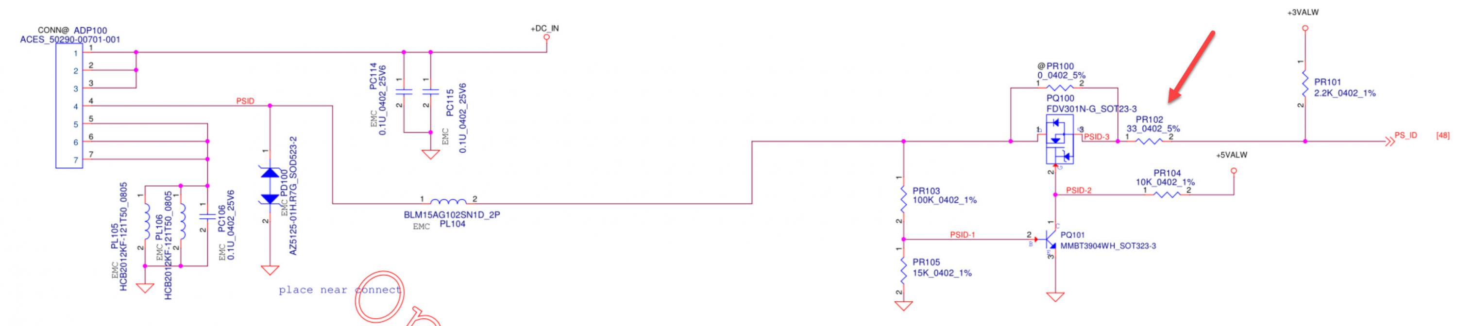

    Hi there, I am hunting down an exact issue, however locating PR102 seems to be a huge challenge. It seems to be nowhere close to PQ100 and does not have its own silk label on the board. I can see a trace going from PQ100 down into a via, which should lead to PR102, but that via continues in the inner layers of the PCB and good luck tracing that..

      Managed to source a boardview file from this github thread and open it with Allegro viewer:
      https://github.com/OpenBoardView/Ope...iew/issues/194
      So it seems that my board is actually 9560 (silly mistake) and that this model has gotten rid of the PR102 resistor - it does not exist anymore. Which then leaves PQ100 as the only possible culprit. Correct?

        Re: Dell XPS 9560 AC Adapter Unknown
        Originally posted by mgrharry
        Fixed. Thanks to @mcplslg123 for serving it up on a platter. I was misreading the schematic and had replaced two other resistors but once I located and replaced the 33ohm resistor off PQ100, problem solved.
        Hi there, I have the exact same board with exact same issue.
        Where is the location of that 33 ohm resistor? Or at least do you remember its component code? It is not PR102 as in the older 9550 board

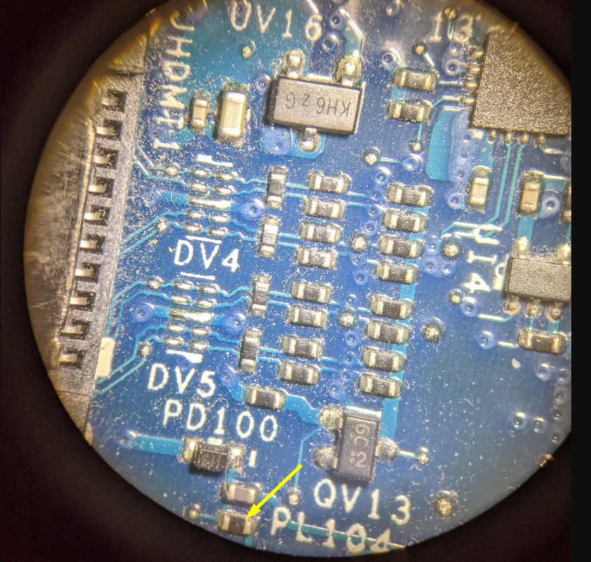

            Re: Dell XPS 9550, Unknown Charger
            Found the PR102 resistor on the 9560 board - it is on the same side as PQ100, right below HDMI port, unmarked, sitting between between LT13 and PL104. It was at 600 ohms instead of 33. Charger is now being recognized after replacing it
              Thanks for the update. For future readers, can you post a pic with the location of this resistor ?
                  Which kbc it uses?? You need to find AD_ID pin on kbc and check whether you have stable and correct voltage there. Trace it back for a resistor valued 33.3Ohms which is culprit in many cases for adapter identification failure.

                    #29
                    here!

                      #30
                      My PR102 is 1ΚΩ, should i replace just this or the PD100 too?

                        #31
                        Re: last post in this thread.
                        is your board the same? Does not appear to be. Note the connector to the left is not the power adapter connector.
                        post full details of your motherboard before replacing any parts.

                          #32
                          I haven't upload any pictures of my motherboard, what you comparing?
                          Anyway, it's the same motherboard as gs84 and the resistor was indeed the cause of the trouble, i replaced it with a 33KΩ and everything i fine now
