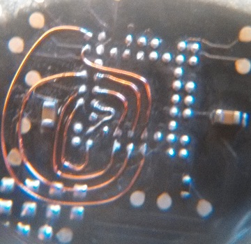

    i have here retina 12 macbook with no video. U8900 is soldered well, but i have nothing on gpu vcore and it looks shorted.
    After inspect under microscope i see that gfximvp way on pin 14 on u8900 is blown or cutted from previous service...so way is repaired but looks shorted too
    Macbook with chime with no picture and no backlight.
    I mean that is fully dead gpu.

    What's the exact resistance to ground?
    You can take off U8900/Q8931/Q8930/Q8961 and see if the short goes away.
    dGPU can be disabled by jumping all the DP_INT_IG_ML_* lines to the corresponding DP_INT_ML_C_* on U9150 but I haven't tested this method.

      on gpuvcore i have 0.04, on gfximvp 1.28 ...and still same after remove all parts
      Maybe full disable nvidia is good idea...can you tell me more how to do it ? I have only experience with 2011 models - for it i have lattice programmer
      EDIT you mean remove u9150 and jump all ways (example) DP_INT_IG_ML_N<0 to DP_INT_ML_C_N<0 ?

        This one cannot be bypassed by reprogramming the GMUX. You have to run the jumper wires by hand.

          soo it really looks that dgpu is dead?
          soo i go to remove 9150 and jump it

            done ... and still nothing on display and no backlight ....nothing on PP5VR3V3_SW_LCD
            How about jump DP_INT_IG_AUX_P / N to DP_INT_AUX_C_P / N ?

              Ah yes sorry the AUX lines must be jumped too.

                hmmm...nothing...only chime
                How about PP5VR3V3_SW_LCD on J9000? Here must be after switch on 5V for check if is lcd connected...correct? ... i have nothing.
                On U9000 i have 5V on VIN...so maybe is U9000 dead...or is problem with U9100
