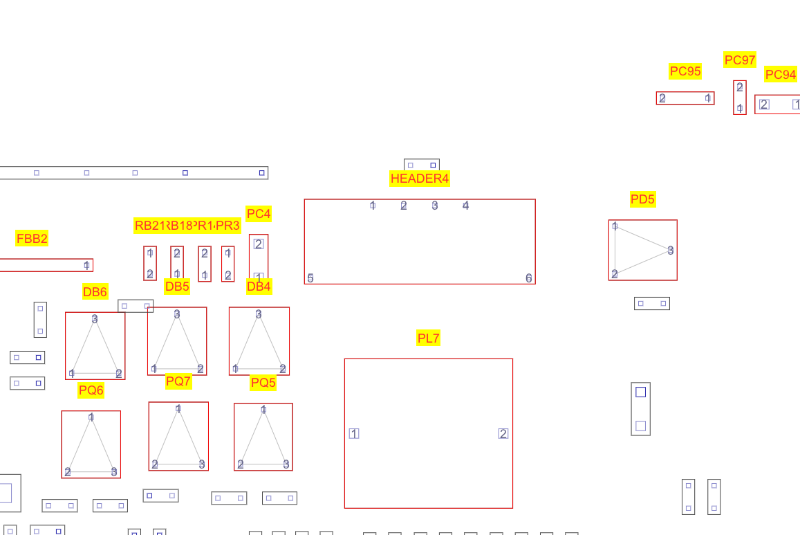

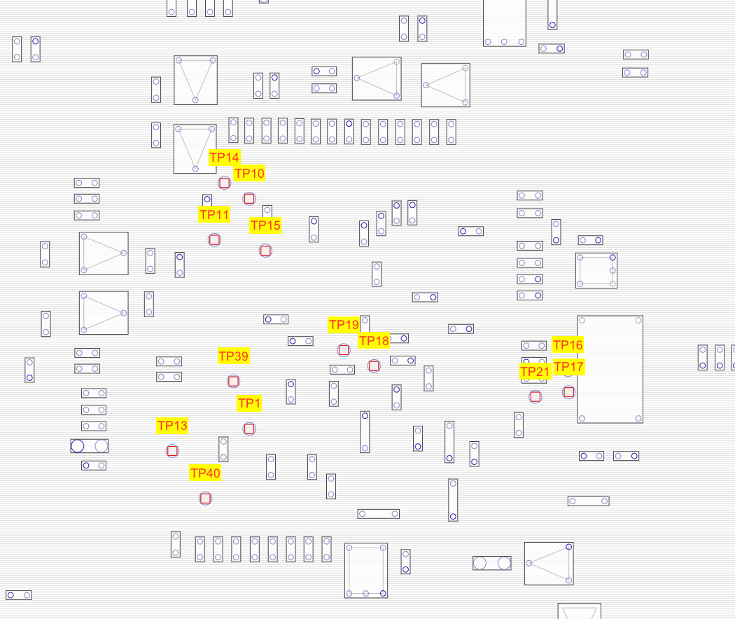

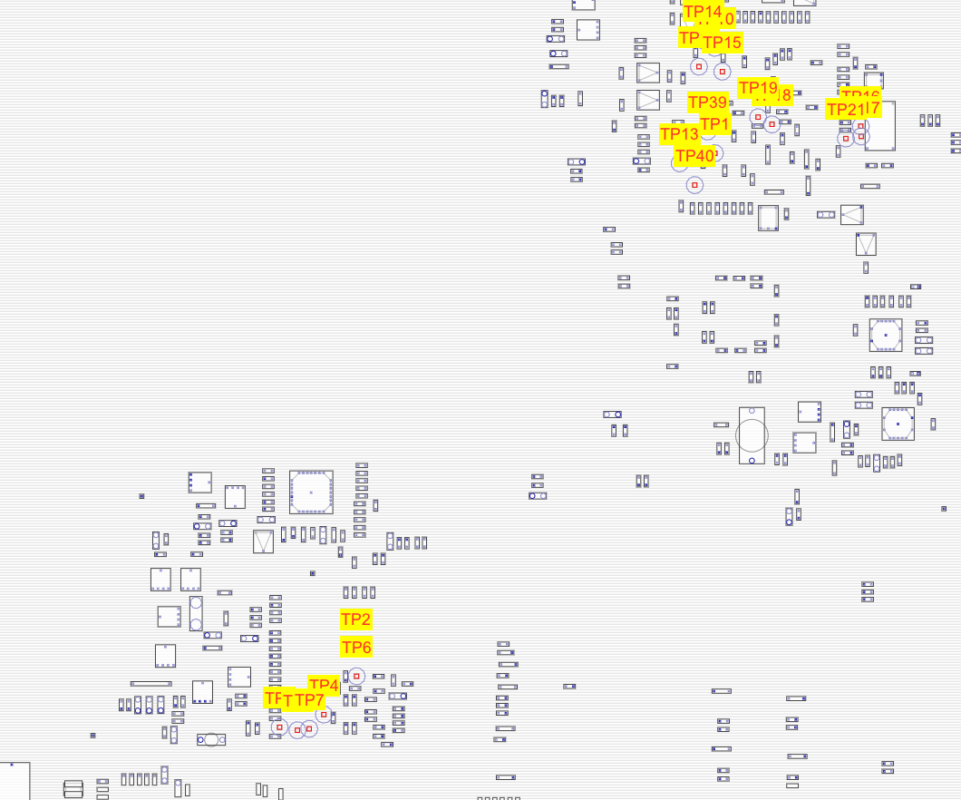

                  1. The first screen shot from the board view shows the two areas that I tested.
                  2. The second screen shot is a close up of the test points that are very close to where the power charger connects to the system board and the connections to the battery are located. It is the same area of the board where the CPU is located, although the CPU is on the other side.
                  Test Point Results - resistance to ground
                  TP3, 5, and 7 - Not connected to ground
                  TP4: .454 M ohms
                  TP6: 5.50 M ohms
                  TP2: .451 M ohms
                  3. The third screen shot is for the test points around the center of the board.
                  TP14: .440 M ohms
                  TP10: .439 M ohms
                  TP11: .428 M ohms
                  TP15: .442 M ohms
                  TP19: .426 M ohms
                  TP18: .429 M ohms
                  TP39: .397 M ohms
                  TP1: .396 M ohms
                  TP13: .431 M ohms
                  TP40: .438 M ohms
                  TP16: .428 M ohms
                  TP17: .428 M ohms
                  TP21: .425 M ohms
                  I don't know if any of these results point to a specific problem or not. Or maybe they indicate that some areas of the board might be OK?
                  Next I will be seeing if I can identify exactly what part is getting warm. Something is getting warm in the area of second screen shot.

                              Re: Beginner questions about unstable voltage in laptop
                              These are the results from the front side. This is the side that has the main power connector on it. These readings were taken after being plugged in for about 4 minutes.
                              * The hottest parts were FBB2, RB21 and RB18 at about 98 degrees
                              * PR14, PR3 and PC4 were 97 degrees
                              * DB4, DB5, DB6 were 95
                              * PC94, PC95, PC97 were 95
                              * PQ5, PQ6, PQ7, PD5 were 93
                              * PL7 was 92

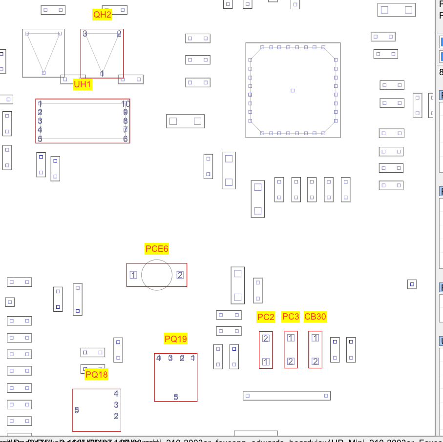

                                These are the results from the back side of the board. The back side does not have the main power connector on it.
                                Backside Notes- These readings were taken after being plugged in for about 4 minutes
                                * PQ18 - 103 degrees
                                * PQ19 and PCE6 were 97
                                * UH1 was 95
                                *The area in between UH1 and PCE6 had no components but was around 96 degrees
                                * PC2, PC3, and CB30 were around 91 degrees
                                      * UH1 was 95
                                      Check continuity across these components "PQ18, PQ19 and PCE6" with your meter on continuity mode. Also measure continuity (with black probe on ground) Drain, Source and PCE6. If there is continuity on both side (on PQ19 & PCE6), try removing PCE6 and re-measure.
                                      I hope that if there is a short, its the PCE6 otherwise that could mean you have a dead processor.
                                      Please check if you have 3.3VA (Measure on PJ6) & 5VA (measure PJ5) [Page 34 of schematic] as well as +V5AL and +V3.3AL (on PU10)
