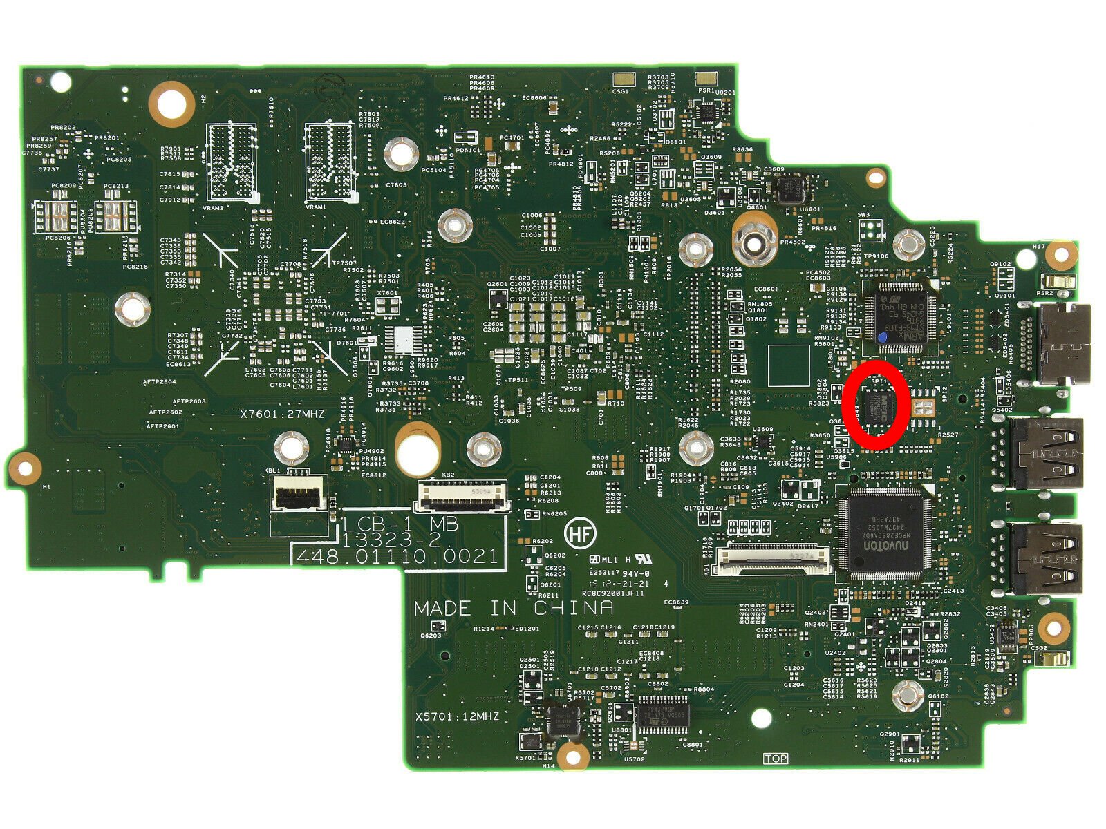

    Hello guys,
    I've got recently my hands on a Thinkpad Yoga 14 (20dn) which will not boot up. (black screen, no bios logo)
    When I press the power button, the keyboard illuminates and the FN-Led lights up. Also the fan spins up. But thats it, nothing else.
    For my understanding it could be a bricked BIOS. Unfortunately I have no exact history about what happened with the laptop.
    I disassembled the hole thing to locate the BIOS chip but didn't find it.
    The mainboard is a LCB-1 MB 13323-2.
    I did a little bit research on the board and found ebay listings with spare boards which have a bios chip but mine didnt.
    my board:
    https://imgur.com/YspvvT2
    ebay listing:
    https://www.ebay.de/itm/Lenovo-Think...-/153526028716
    Maybe someone has ideas or hints to resurrect this laptop.
    Thank you!

      Hello piernov, thank you for your help. Unfortunately I can't find a supplier that can provide me with this chip. Maybe somebody know a supplier preferably located in Europe.
      This are the details:
      Device: Lenovo / Thinkpad Yoga 14 / 20dn
      Mainboard: LCB-1 MB 13323-2
      BIOS-Chip: MXIC / L150515-10G
      Thank you very much folks!

        Hello
        Did You fix the issue ??
        I have on table same MB and same behavior
        Regards
