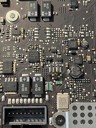

    Hi All,
    I wanted to do a major upgrade on my MacBook to give it a few more years of useful life.
    I purchased an SSD drive and I was so happy with the improved performance that I sprung for 2 sticks of 4GB of RAM each.

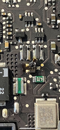

    Then I did a boneheaded move and accidentally dropped my screwdriver onto the logic board
    I saw some sparks and this is the result:
    I am not a tech and I have very little experience but I am very handy and, most of all, persevering.

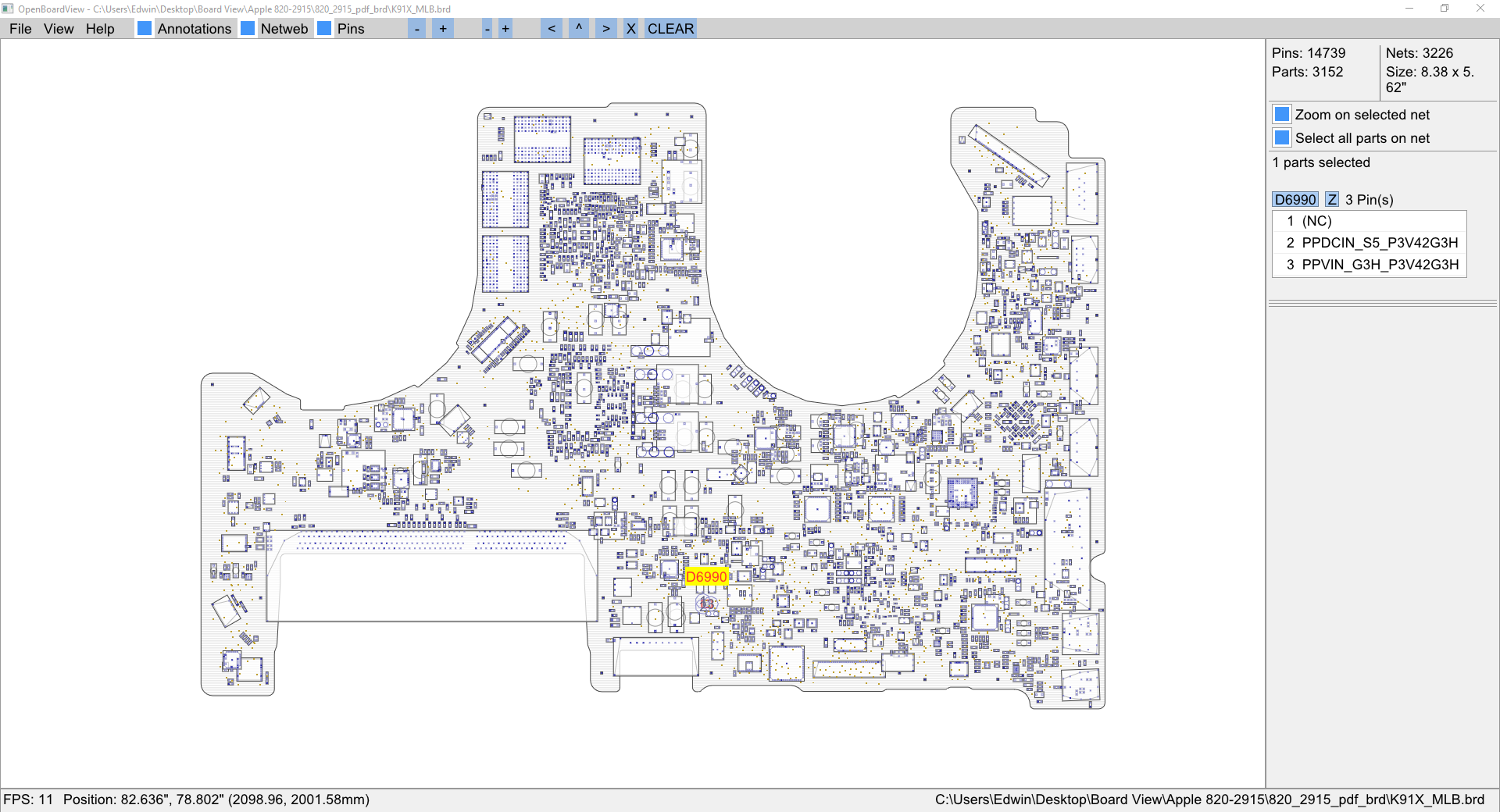

    I downloaded Board View and the schematic for my board 820-2915-B and I figure that I burned D6900. I would like to replace that component but I have no idea what it is and where to buy it from, would anybody here have a part number?
    Many thanks in advance.

    Re: Macbook Pro 15" 2011 - Accident
    DeadGPUBook 2011…
    Anyway, open schematics, find the component, find its characteristics. Or pull it from a donor board.
    If you don't have the tools and soldering experience you should probably ask someone to replace it for you.

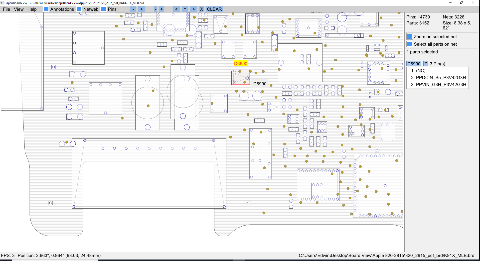

        Boardview says D6990
        • HeavyDnot
          • Jan 2020
          • 4
          My mistake, it is D6990.... would you happen to know the description of that part and / or part number?

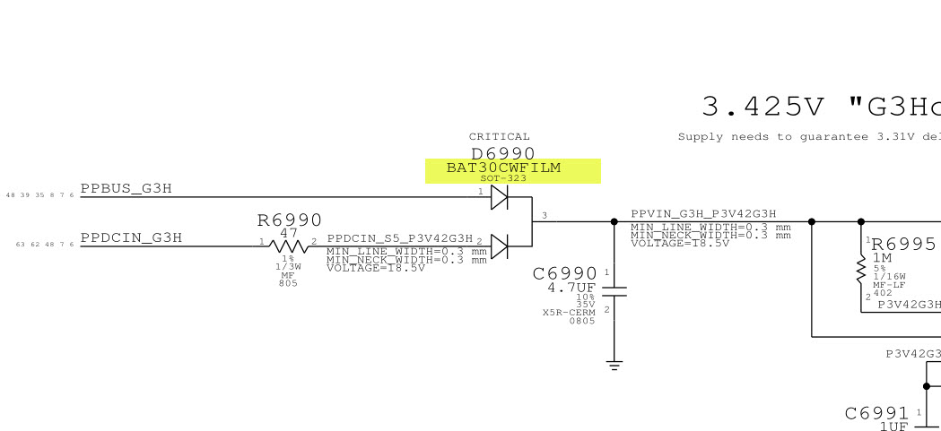

            You might like @piernov to confirm but I am pretty certain this is D6990
            MPM - BAT30CWFILM
            https://www.digikey.com.au/product-d...0-1-ND/1207042
            https://imgur.com/a/4zWunxF

              Hi this might new a old thread but how do you know the part number? thank you
              • mon2
                • Dec 2019
                • 14316
                From the schematics.
                SOT-323 size, dual diode.
