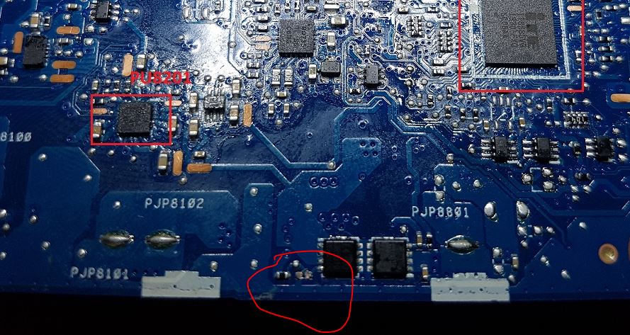

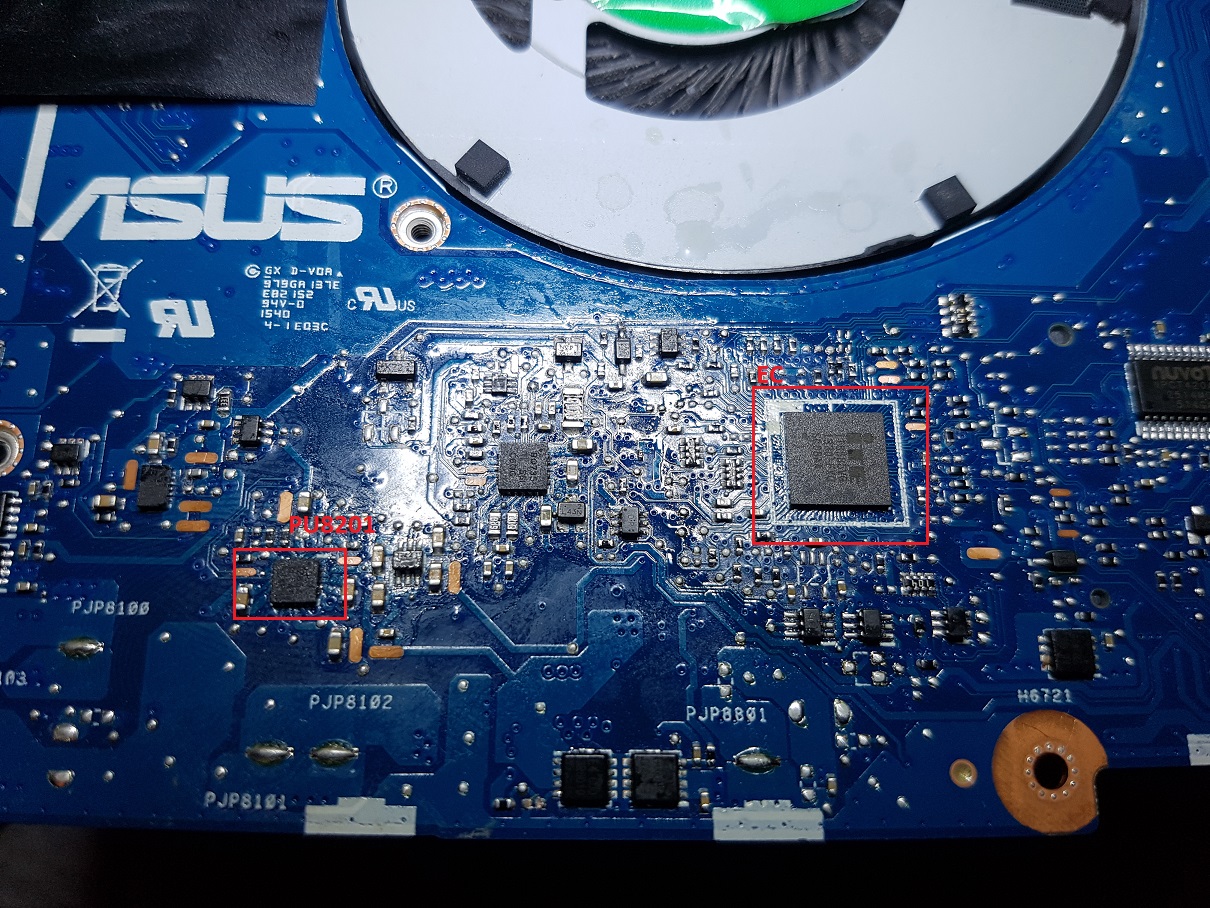

    Hi!
    This is a funny one!
    Board is dead no sign of life, no liquid damage.
    19V are present, and I noticed a buzzing sound.
    Tracked it down to the IC PU8102 PWM CONTROLLER SN51285ARUKR
    TI QFN-20 , and he was also getting hot.
    I also noticed I had +3VAO but not +5VAO (no short though).
    Both enables to this chip are also low (0.06V something around that, also no short)
    As I had this chip, I replaced it with a new one, but still the same.
    Some more inspection and I found out the +3VA_EC line shorted. Injected some current and EC was getting hot. Ordered it and replaced it just a few minutes ago. short gone in +3VA_EC
    Plugged the charger. same buzzing sound from PU8102...and getting hot still. Disconnected charger, measured +3VA_EC shorted again...lifted EC, short gone... had another IT8585VG chip, replaced again. No short, doublechecked.
    Plugged, the charger, same thing, and +3VA_EC became shorted once again.
    What could be the reason to get the EC shorted each time I plug the charger?
    PU8102 is also a new chip, so kinda lost here...
    Anyone could share some ideas about this?
    Thanks!

    Re: Asus ROG N501JW - dead
    Is that a part missing ,or liquid damage on the gate of that mosfet.
      Yes, its a cap missing, sound related. not important.
      No, just some dirt or flux.
      Any ideas about this EC constant shorting?

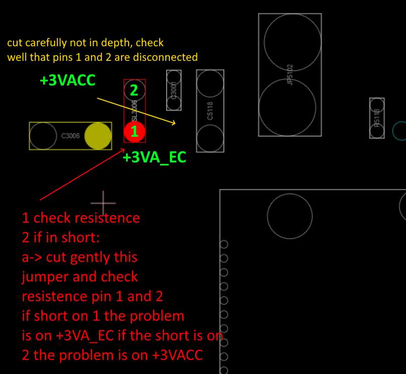

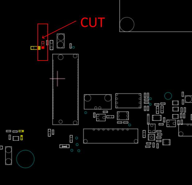

                    • jasko_jacker
                      • Oct 2014
                      • 1140
                      • italy
                      If the short disappears without ite so the problem probably is on the power line but not 100%, if there is a short on the +3VA_ECC (check the picture 2 and check resistence first without cut the jumper if there is a short on this jumper follow the next steps:
                      the +3VA_ECC came from +3VACC on SL3006 , cut this jumper to isolate
                      +3VA_ECC from +3VACC and check both pins ..... see pics 2
