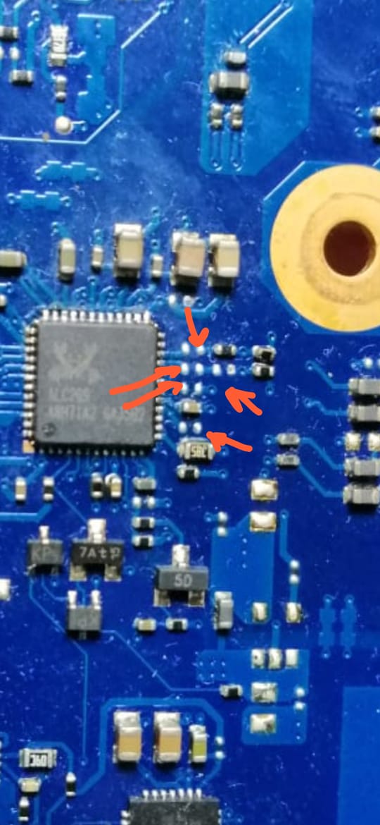

    3rd and the most important is that it has a defective sound card ic, i changed the ic but there were some missing parts as shown in picture, now i have sound on speakers but it cannot detect the earphones

    Re: Rv508 ba41-01377a
    Audio codec ALC262??
      No alc269
