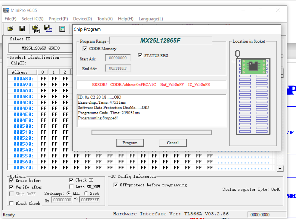

                          i have check bios chip, and program it with original bios and i have error
                            Re: msi GP63 gtx not detect and keyboard mistake
                            Ashort can kill always something. Did you try with different memory . Do you get also an error by reading the dump?
                              yes i have try with other dimm memory , no i don't try to read, only write my original bios.
                              it's only the second motherboard i change ec
                                You mus first read your bios chip you must always save you original bios and it best you read it always 2 times and compare wit hxd or other program them to see it is identical als after writing you must compare your written bios with the one you flashed it this are steps what can save you a lot of times also desolder the bios chip not write with clip that can give errors. Clips doesn't work good.
