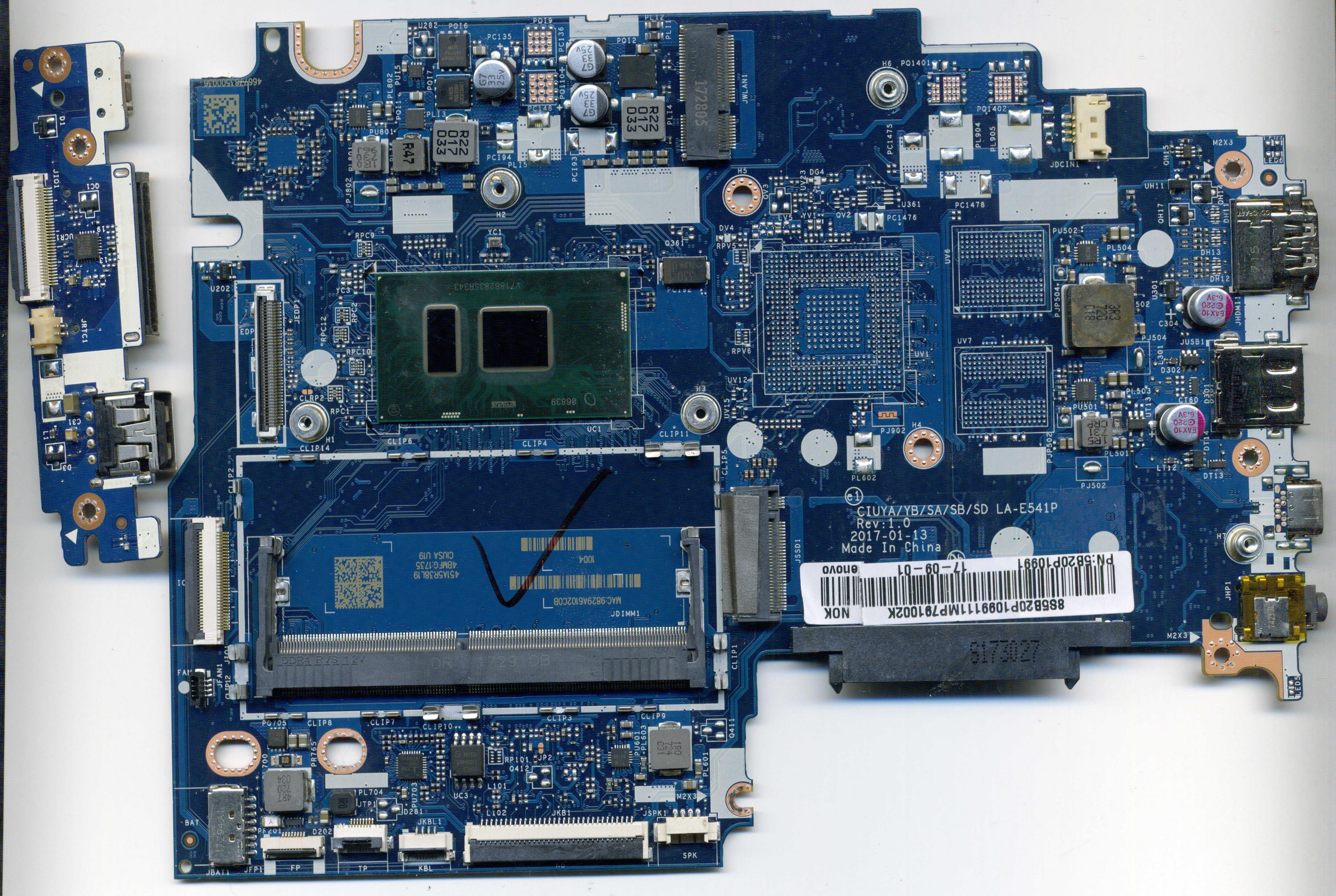

    I have a Lenovo 320S-14isk with the main board LA-E541P
    i have the photo of the board i need the name of the ic 3,3V PU501 the code is
    {BAB7GD}

    It might be a Silergy SY8288B

      Re: Lenovo 320S-14
      thanks for replay, i will try

        Bab = sy8288brac
