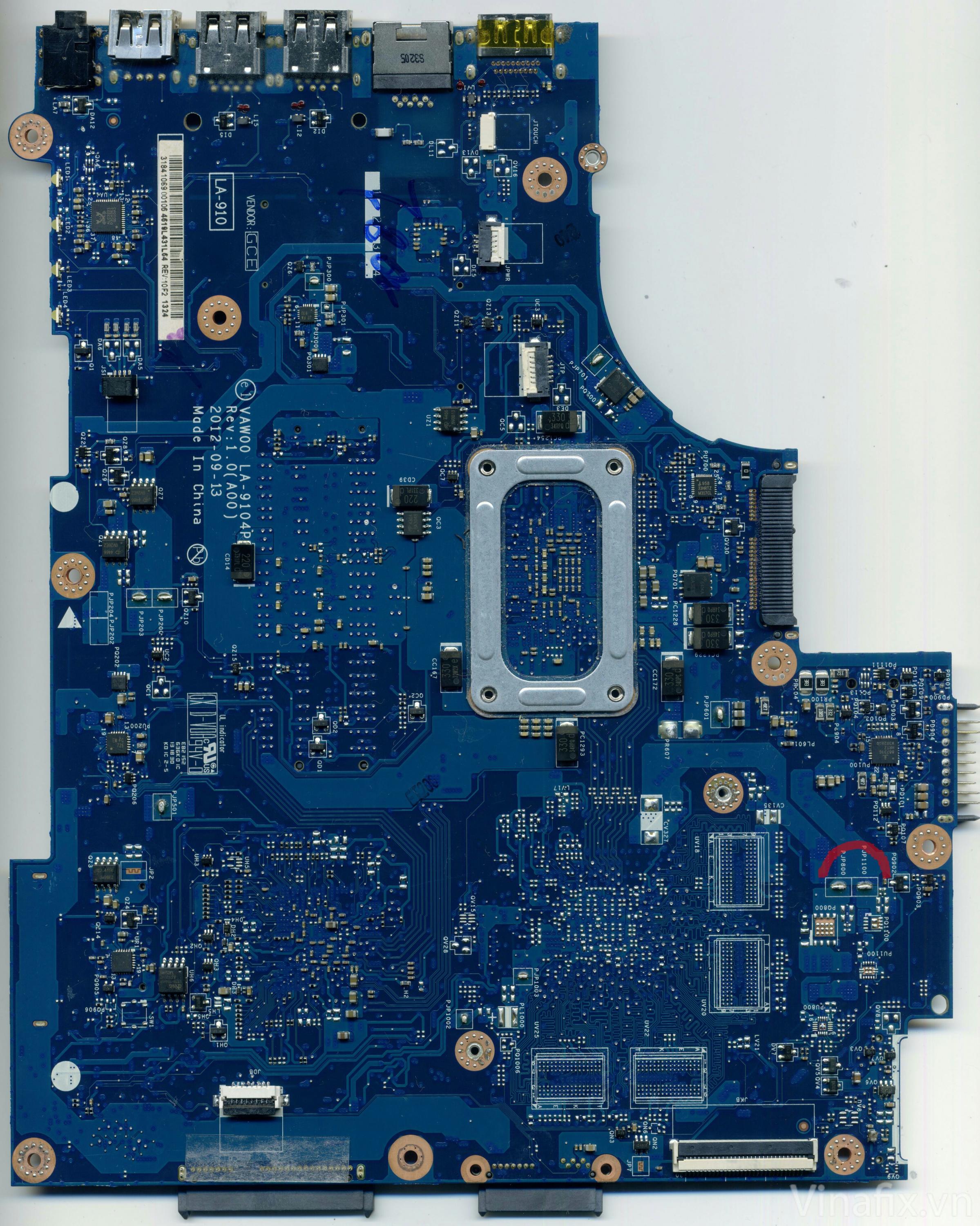

    Hello guys
    Im current working on the Dell
    VAW00 LA-9104P
    Rev : 1.0
    7 beeps and no display
    Measurements:
    I have all other necessary volts
    The Gfx core is missing, 0v.
    Fan spins constantly
    I changed the bios chips both of them with another same board but still no lucky

    Check PU400 requirements or replace this chip if you have difficulty in measuring. Be very careful-your probes should be needle sharp.

      Okay let me do it now coz i have another replacement chip

        I changed the chip but still no lucky, let me put another one and see

          Did you clean the ME firmware on the original bios, or on the replacement bios.

            No I didn't

              check cpu circuit . after change cpu

                Cpu is onboard soldered and dont change it without being sure.

                  Remove PJP1100 and PJP800, see if the mb post or changing beep code.

                    same problem bro

                      Bios can make this issue, dump io too
                      pu 500 pin1 voltage
                      uz1 voltage
