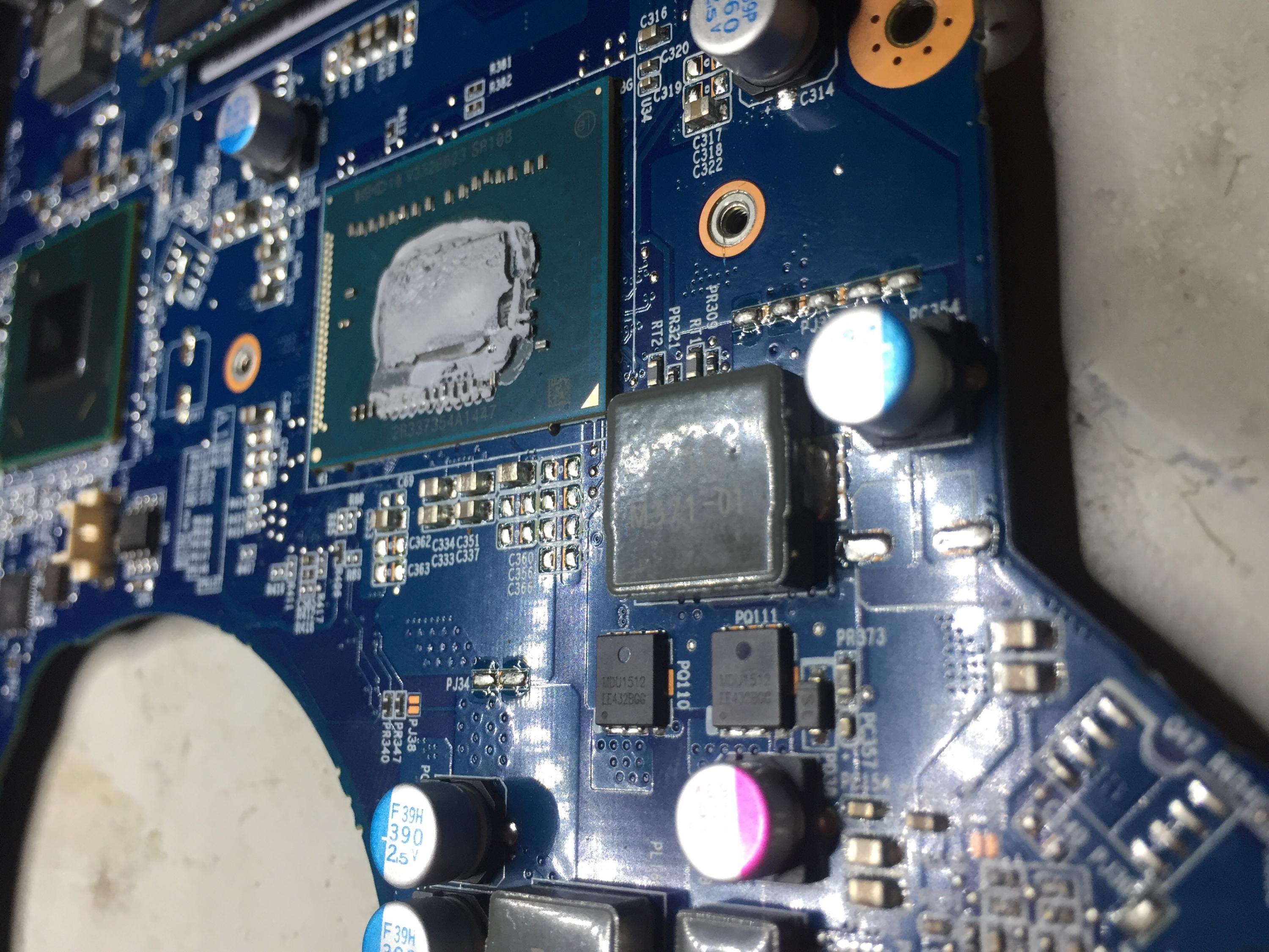

    I'm facing a strange behavior here, the laptop comes up and quickly shut down.
    When i remove the ram it cones on and the green light stays and doesn't shut down, I changed the ram and inserted another ram it still doing the same thing.
    I checked the ram power supply there is no short to ground
    Measurements are:
    -Ram power supply = 1.5v
    -Cpu power supply = 0.0v
    Motherboard number it = 6-71-W24Z0-D02A I dont have the schematic

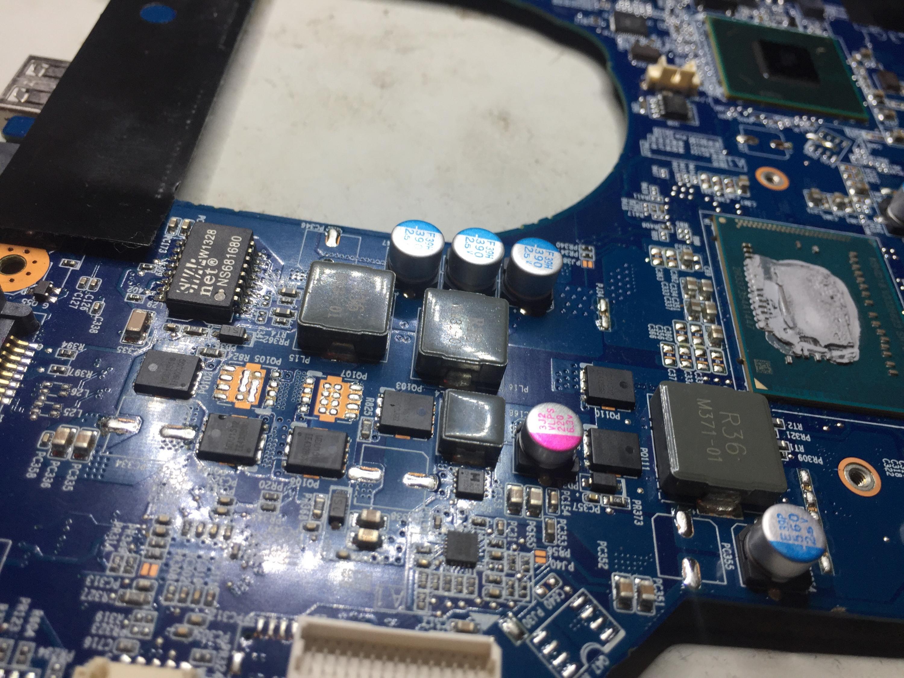

        Hello guys please clue me up here on this machine, here my finds so far
        I Have 1.11v on the vcore, and the gate on one of the mosfets for vcore power supply is 0.007 when compared to ground.
        One more thing i have 0v on the gfx core
        The laptop keeps on turning On and quickly shuts down after pressing the power button
        Any clue guys, why the value of the gate is so low if compared to ground? Is this normal

          The switching on those fets is really fast and your meter probably isn't picking it up correctly. Get a scope if you have one and look at it.
          0v on gfx core is most likely your problem. Whats the resistance of gfx core to gnd?

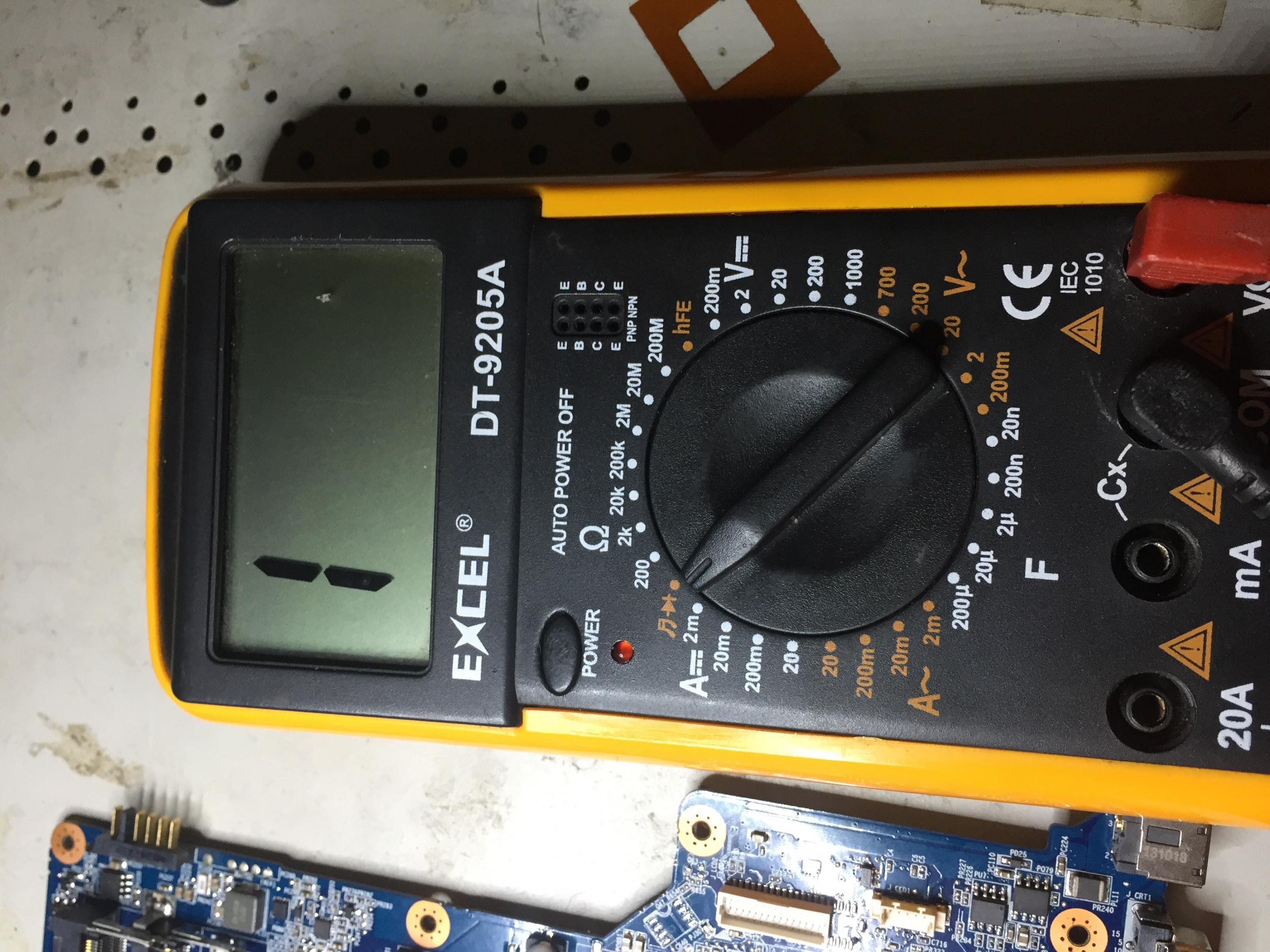

            It 004 using continuity mode

              Resistance please.

                How?
                What range should i set on my multimeter please help

                  200 ohms

                    It 04.8

                      Thats fine.

                            Now check
                            Gate & Drain voltage on PQ108, PQ109
                            Gate voltage on PQ110, PQ111

                                  All gates have 0V of PQ110, PQ111, PQ108,PQ109 i have 0v on their gates, the Switching mosfets do receive 19v but they don't switch, they are not being told to switch
