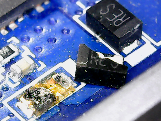

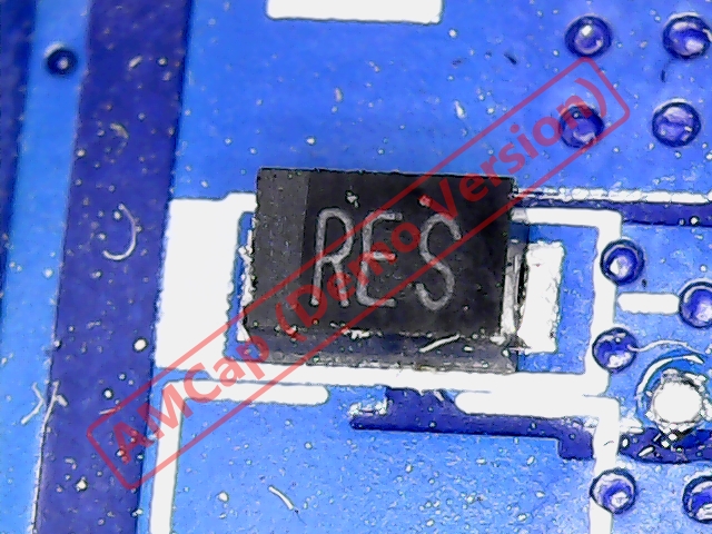

help to identify a faulty laptop component
help to identify a faulty component plz
Re: help to identify a faulty component plz
Google schematics and boardview that's all you need.
However, let me guess. This is a resistor. Value of it you can find out by measuring resistance of it's brother or sister sitting next to it. I might be wrong, it could be a diod, in which case you'd confirm it in diode mode. Yet again I could be wrong, and it could be a cap, in which case you'd measure it's capacitance.
So that we don't guess, you gotta do google search, model of your motherboard, and then followed by boardview.
For example, if mobo is MOBO222333. Then you search google for MOBO222333 boardview. Get the boardview file, and post it here for future reference.Comment
Capacitor that type should not be on 19V line so it is likely protection diode. As it is on 19V line, it is not needed.Last edited by ktmmotocross; 05-08-2021, 12:53 PM.Comment
Does the machine turn on?
Most likely a TVS diode like others said, nothing critical. Leave it as-is, or put a suitable replacement for inner peace. BTW mainboard is DA0XW1MBAI0 for which sure enough I didn't find any schematic/boardview.Comment
