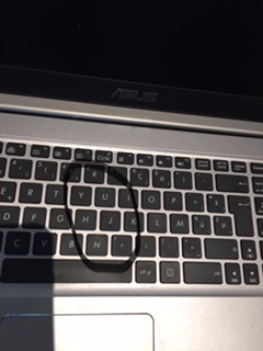

I have an issue with an Asus UX510UWK Rev 2.0. The issue is that there are 8 letters that are not functioning at all, which are: 6, 7, y, u, h, j, n and m keys.
With an external keyboard it works perfectly. Boot on an Ubuntu bootable key, and have exact same issue (so i can assume it's not a software related issue)?

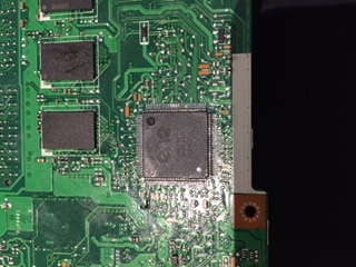

Checked closely the board, no water damage and nothing seems to be damaged.
Took off board the ENE IC (I/O), solder it back on the board, exact same issue.
