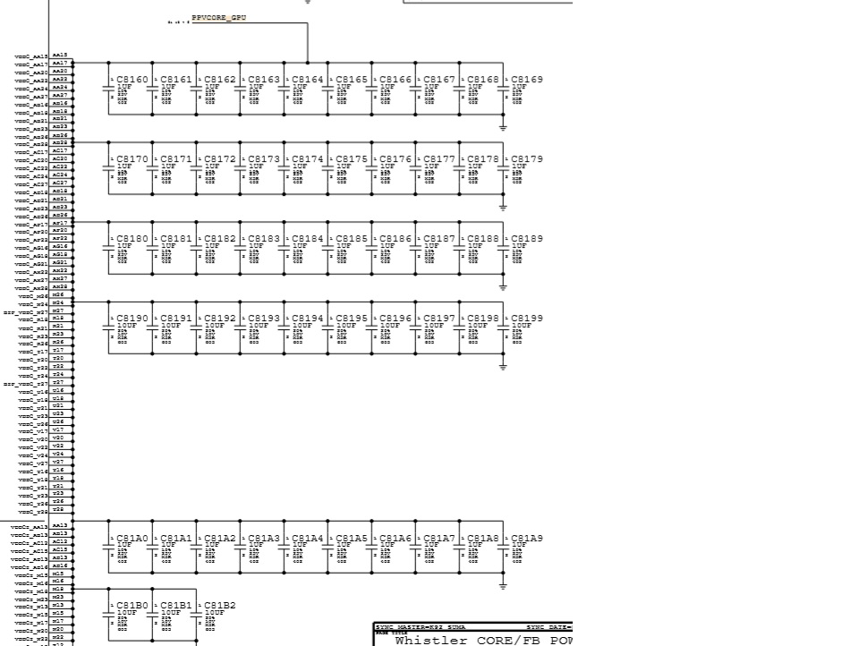

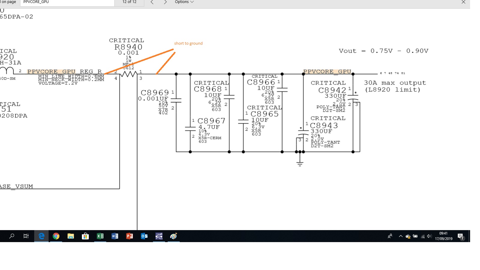

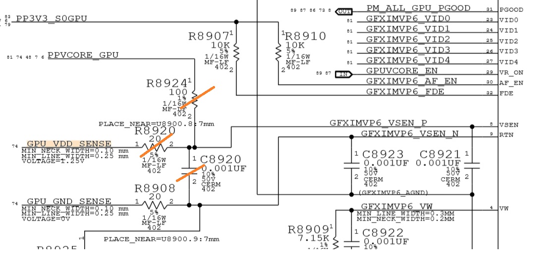

    There's a short circuit on PPVCORE_S0.
    See attached in red, which components I have removed and I still have a short circuit on PPVCORE_S0.
    So the short is in the line from R8940 (see appendix 2).
    or in the GPU chip or in one of the capacitors (see appendix 3).
    The question now is how can I find the capacitor that could be broken ? A separate power supply of 0.9V on PPVCORE_S0 with an adjustable current ? Is this a good idea ? and then measure the temperature of each capacitor ? Does anyone have experience with this ? What equipment do you use for this ? I can't solder every capacitor, can I?

    Short as in how much resistance to ground?
    This is gonna have a dead GPU btw, regardless of being shorted or not. Check if it's been reflowed too.

        How did you reflow the GPU? It doesn't make any sense to reflow GPUs of 2011 MacBooks since they have a manufacturing defect. Also it sounds like you "popcorned" your GPU or delaminated your board. This happens when you apply too much heat to one area without preheating the entire board. If this happened your board is gone.
        You can inject voltage into a power rail but limit your current to an amp max on vcore lines. Splash some alcohol onto the board and look where it quickly evaporates.
        But since you heard a pop or crack you most likely damaged the board or cpu/gpu by delaminating the substrate or the board itself.

                            TLDR:
                            Inject the expected gpu voltage and look what gets hot.
                            If the gpu die gets hot immediately you know its bad and then you can proceed to remove it.
